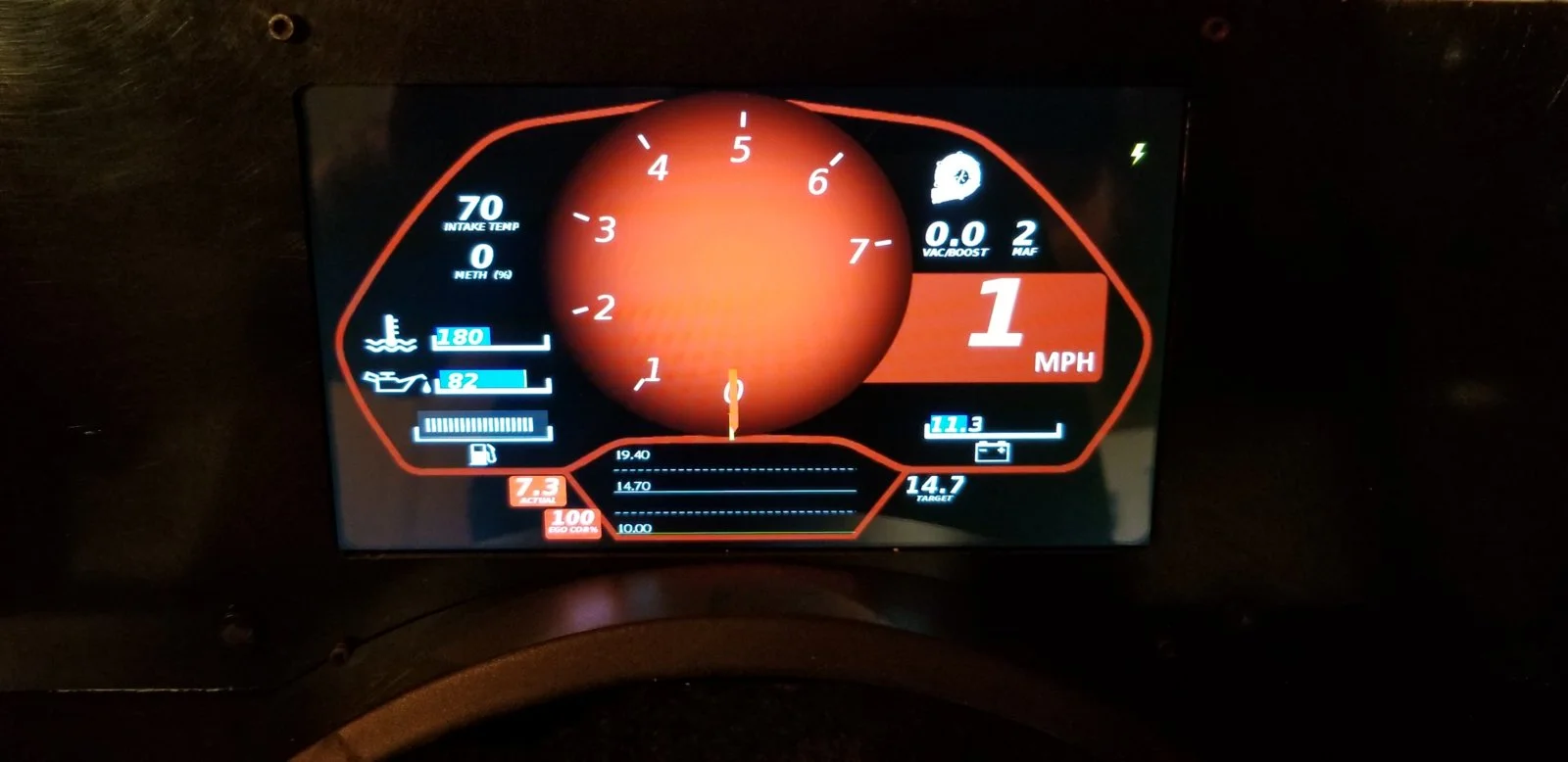

Bench test with Dash connected to MS.

You rolling down a FL hill?
Lol, no.
I am using an expansion card that talks over canbus with the MS2 ecu. On this expansion card I built the necessary input circuits for fuel level and vss I use for MPH. The timer input circuit I used is based on a 1028 count, so the minimum mph reading is 1mph...... it's my fault as i wanted resolution st speed in exchange for min timer counts. I also built a ton of output circuits some digital on/off and one pwm output for the watermethonal solenoid for full delivery control.
The kicker is if I had just upgraded to MS3 all this comes standard.

Ah, that was my next guess.

Sparky714 said:
Where did you get this setup? When I search for it all I find is Holley stuff.
Edit: I just checked out @stanglx2002 thread and see this is all custom with tuner studio and a raspberry pi I'm guessing? Looks great!
I am helping Kurtis out with the R&D on the product currently, there will be a few variations of it including one with a remotely mountable screen so you can use it to view/review tunes and datalogs at any time and tune without ever having to bring a laptop to the car again.

Very nice. Any possibility of a larger screen? Seems like there is a lot of wasted space in the stock cluster location.
There is not much space left actually... The cluster bezel was not in place so it looks like there is more room that there is.

Yes, Steve is correct that there isn't much space height wise with the current 7" screen to be able to put a larger screen in the cluster. The additional space could be used for other mechanical/electrical gauges, shift light, indicators, etc.
