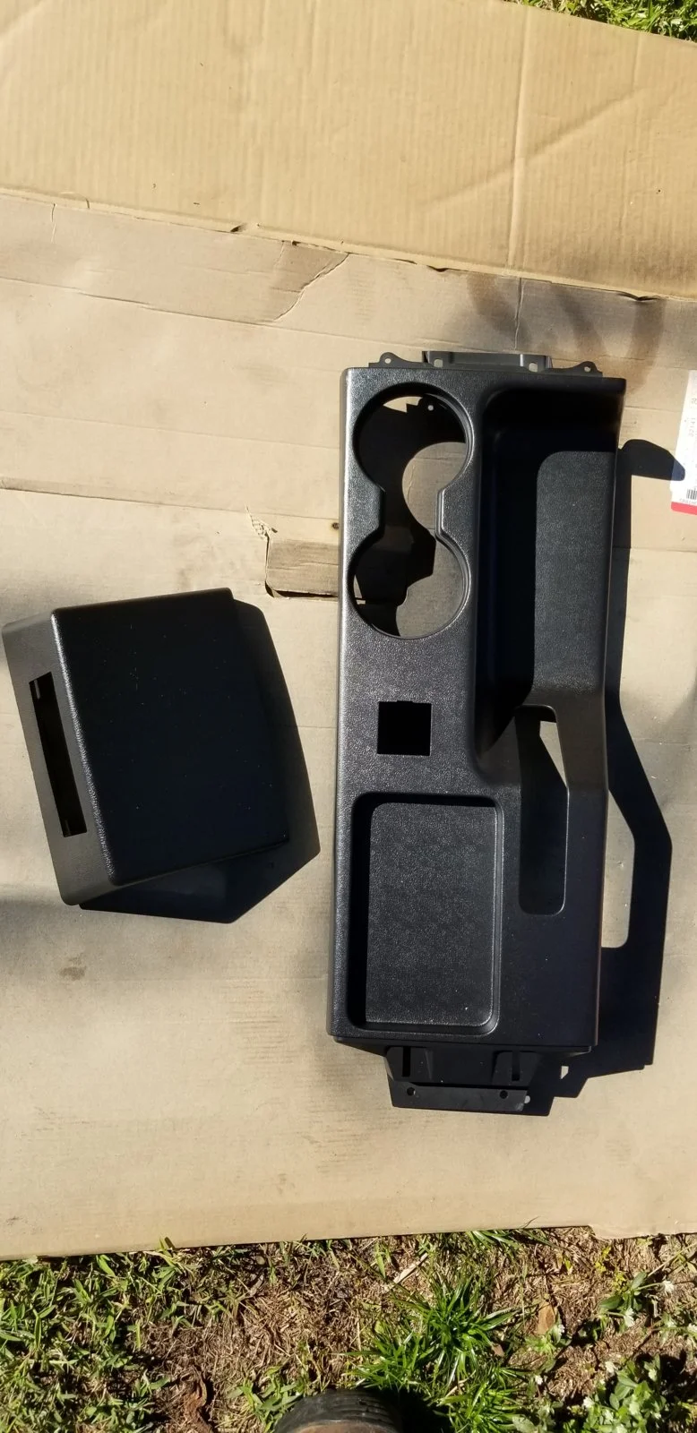

Small update on the console, I got the pieces painted and will be mocking up the power supply and wireless charger a little later today.
Reactions: stanglx2002 and General karthief

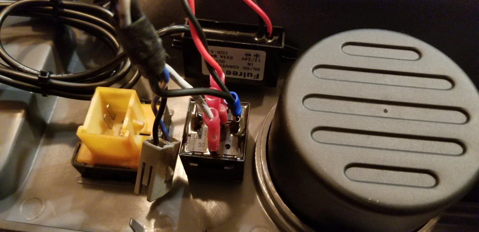

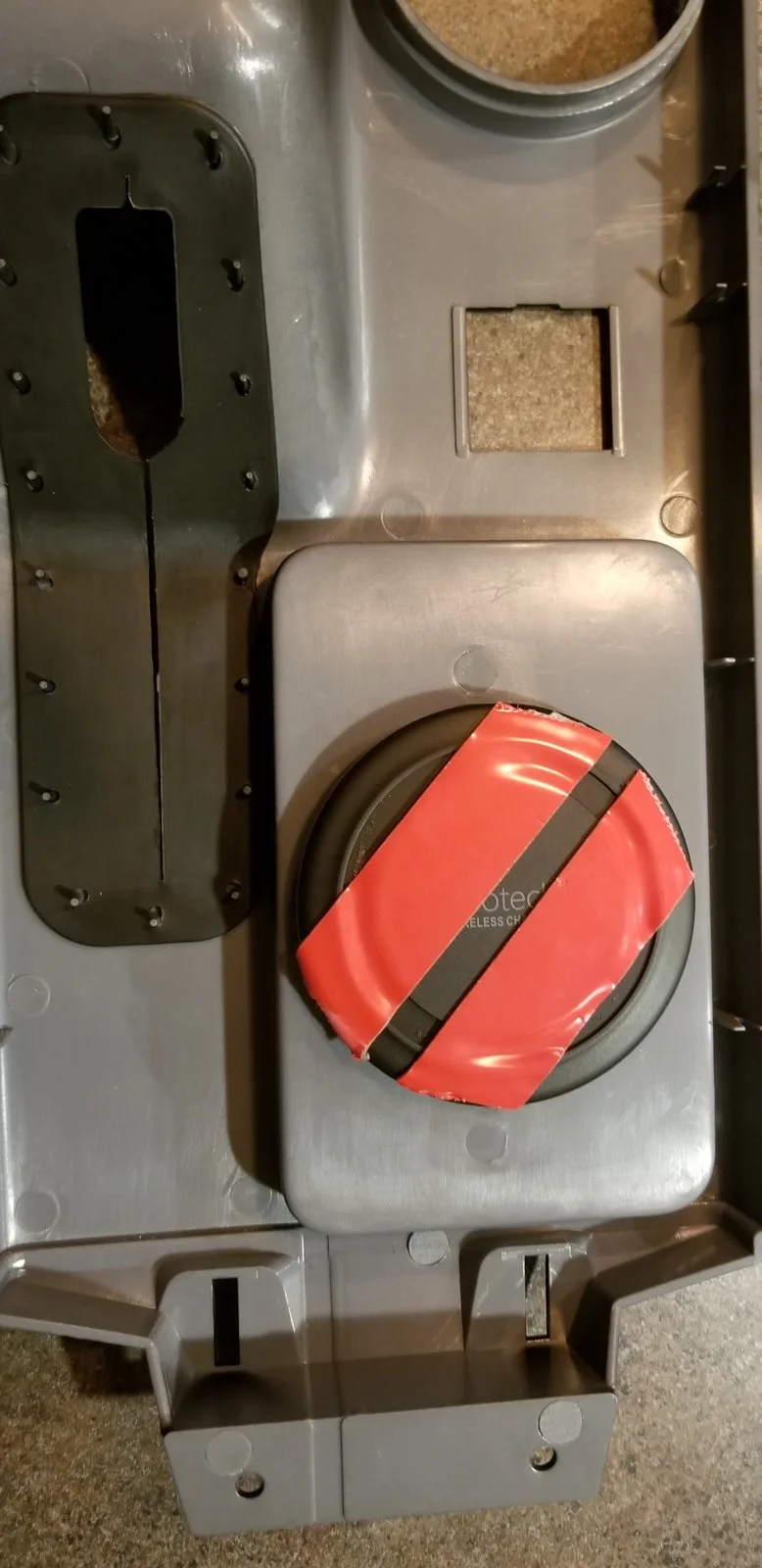

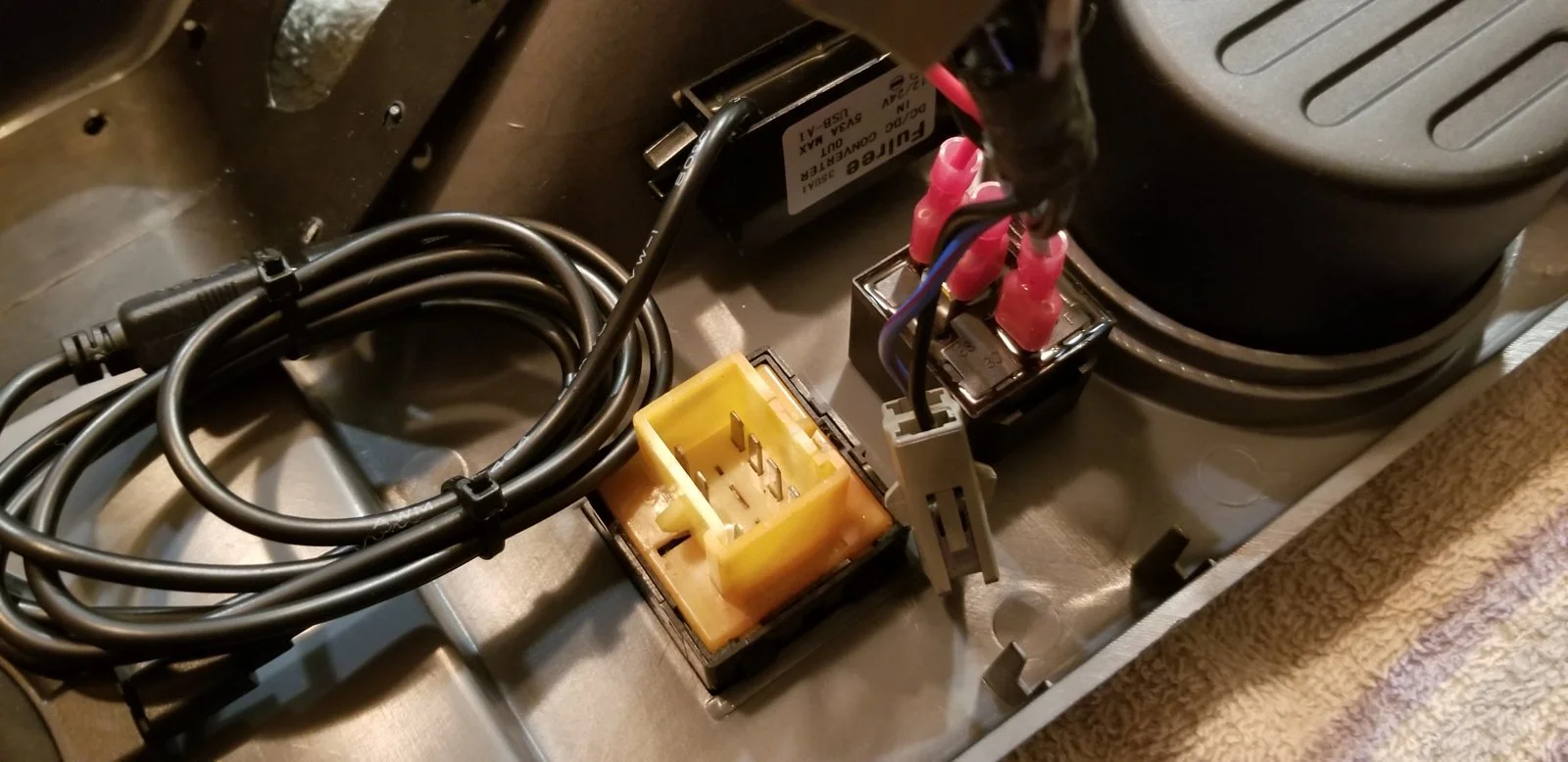

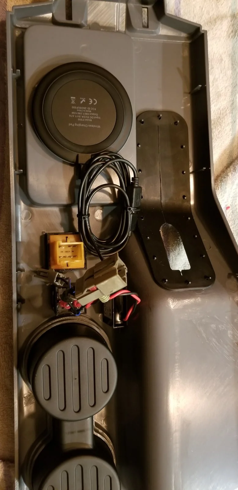

I did not get a chance to install it in the car but i did bench test it and the phone charges perfectly.
Doing a bit of Test fitting here, I used 3M double sided tape for all the pieces so once they touch thats where they are going to stay. I cleaned all surfaces with alcohol before applying the tape.
I had an old cigarette lighter plug loose in the bottom of a box so it got used for the project, The charger does pull wattage even when not in use so i added a relay to the circuit so it will only be on with the key.
Dont mind the unused spade connector in the middle its just there so nothing can bump into the live pin on accident. The Cig circuit feeds the relay on pin30 pin 87 out to the power supply, both pin 86 and the negative are grounded together. Only thing left to do is plug it in and run a ign circuit to trigger the relay from the radio area. The cig light plug was left intact, I may use it at a later date for some kind of ambient lighting.
The USB was a bit long so i just tie-wrapped it in a bundle.
