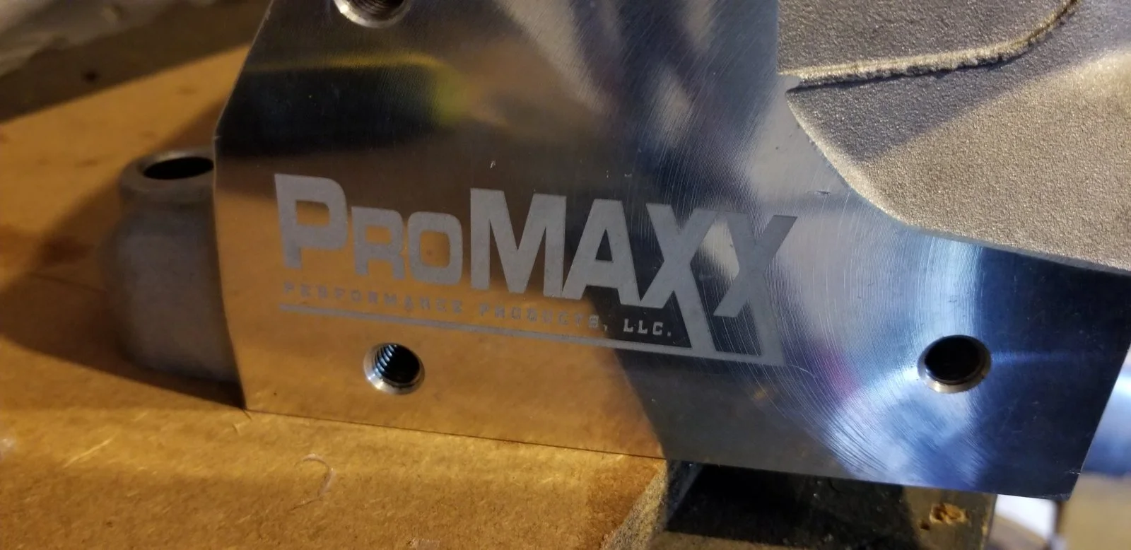

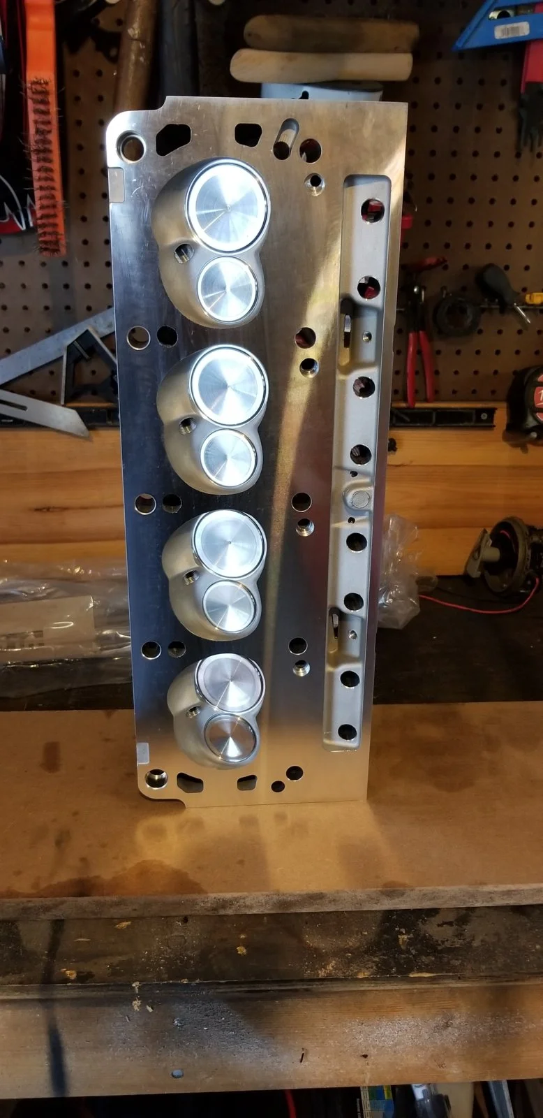

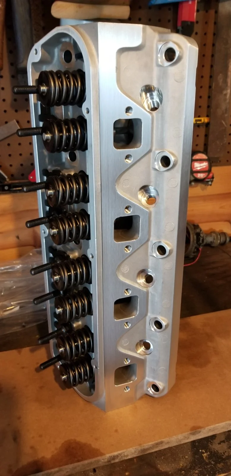

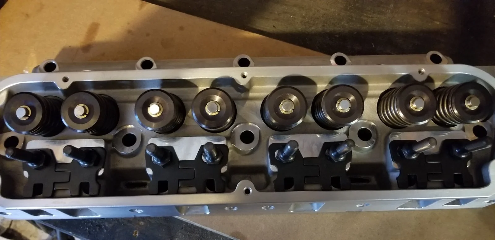

Oh my promaxx180cc heads came in as well, let's unbox em.

Great stuff.
If I were you, I 'd have my machinist do a full disassemble and check for valve concentricty, and validate the installed height and spring loads of the valves. Often they are out, even on good heads.
Once thats done, re-prussian blue and bed in the valves to the inserts.
Common issues are the pushrod clearance and port positions. They don't have to be port matched if the intkae holes are bigger than your intake, and the exhaust holes are smaller than your headers. Engines make better power if the port mismatch goes that way.
The castings are good, but they do need to be checked. There is no such thing as a bolt on an ready to run set of bought in heads.

Yup, already on that, having some higher lift springs added so I can run a 1.7rr
