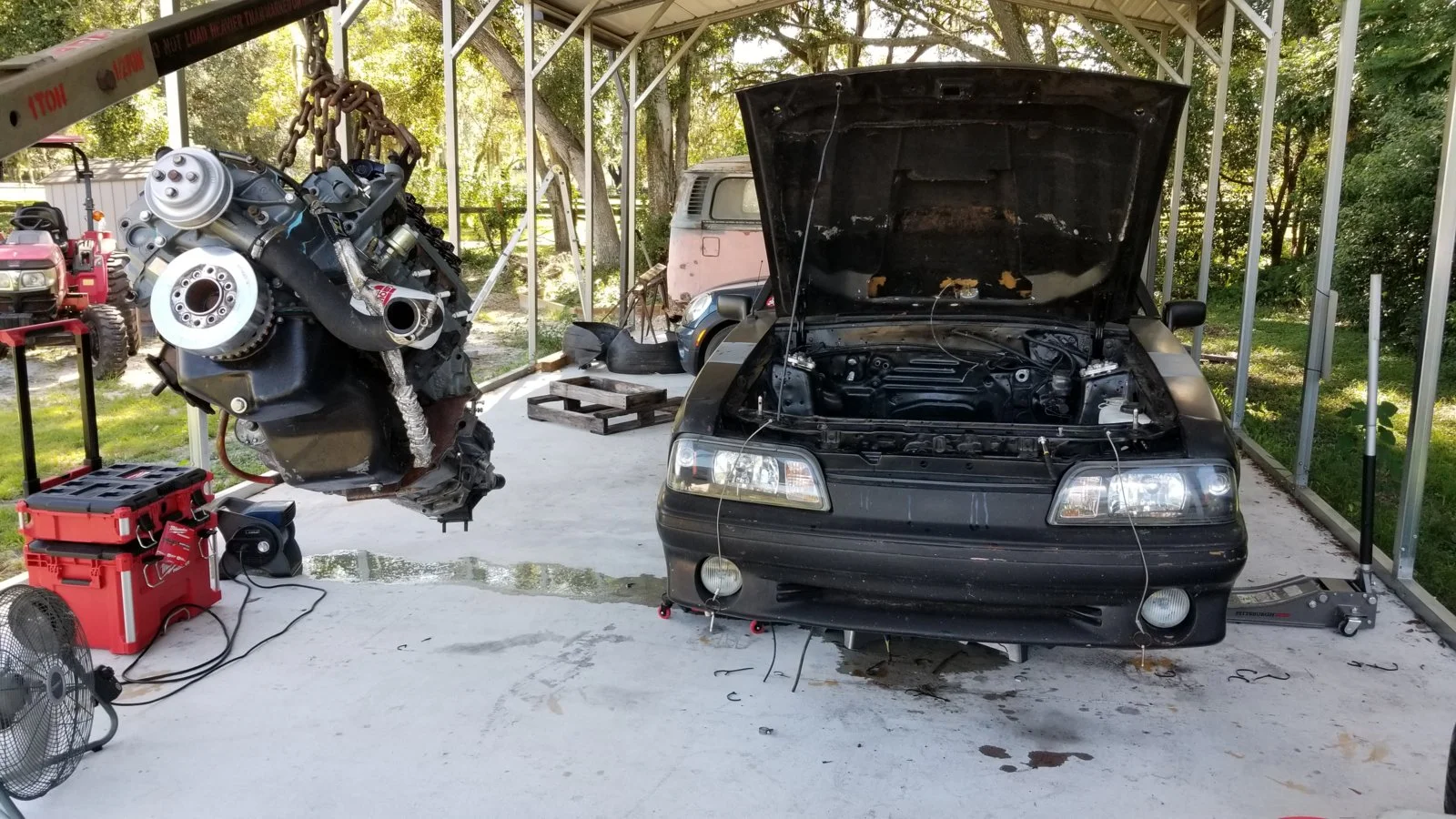

Have I mentioned yet that I love my new workspace? Shade, concrete, creeper, rolling stool, tool creeper, and a nice toolbox with everything in reach this went quickly and easily.
Reactions: 2Blue2, Olivethefet, 90sickfox and 3 others
Looks like you're also getting the surface properly exposed to the daily regimen itll see for the rest of its life.
Reactions: KZGUNS and General karthief

Yeah it just saw some coolant no biggie.

You are make'n the tractor jealous
