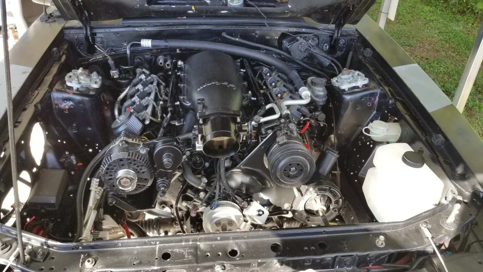

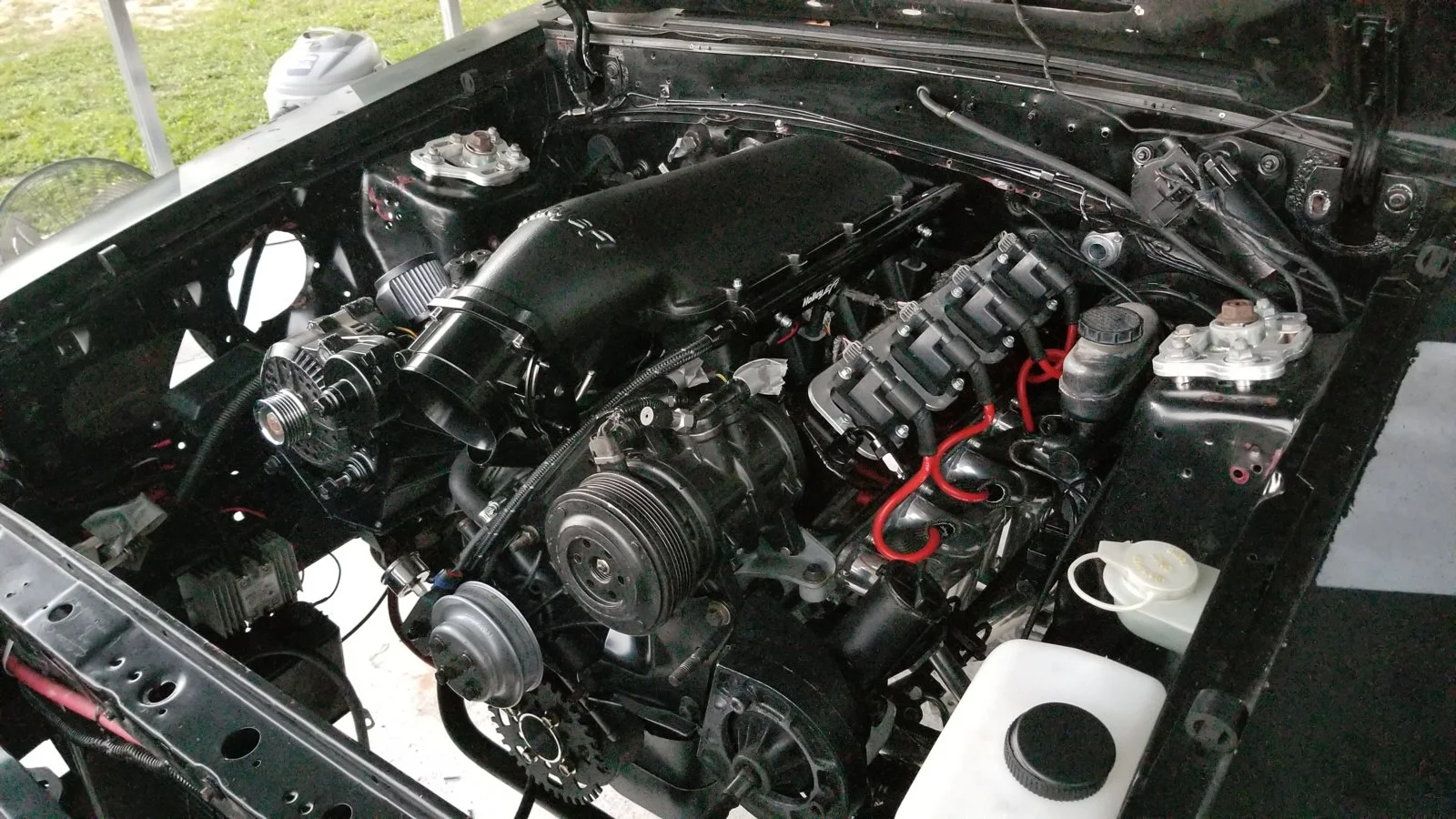

currently still working on getting the car wired, I am taking my time and working methodically at this. I have all the sensors and engine harness installed minus the AC clutch so far. Keep in mind the accessories will make the engine a bit less clean looking.
since taking these pictures i have covered the exposed parts of the harness in loom. I do plan on doing some spot painting to make the bay all black again and cover the red showing through. I also plan on leaving the water meth system installed, may as well use it. I am going to tune the engine on 87 and spray meth to get the timing up.

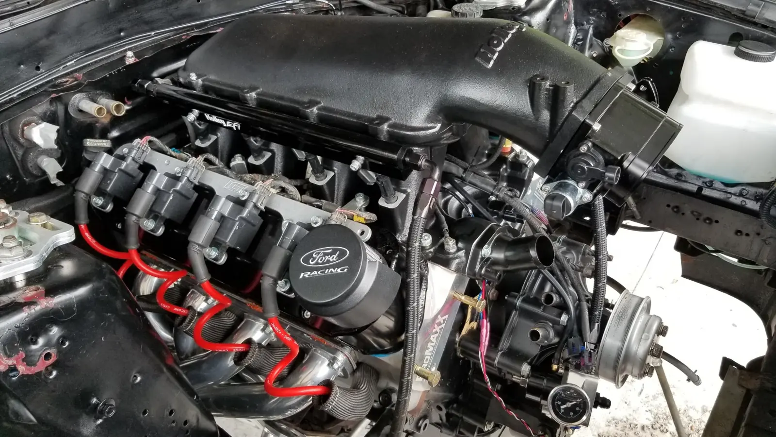

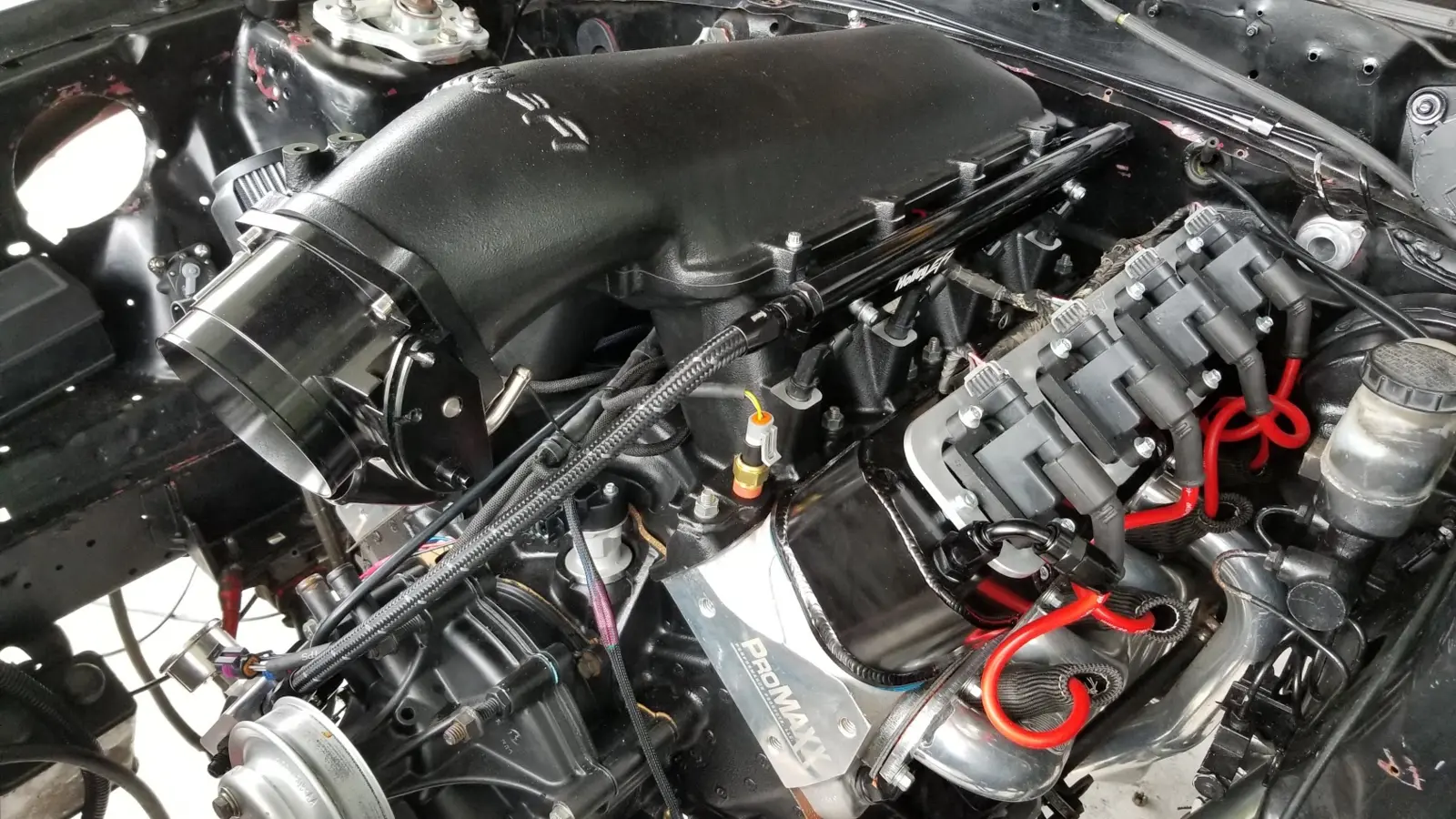

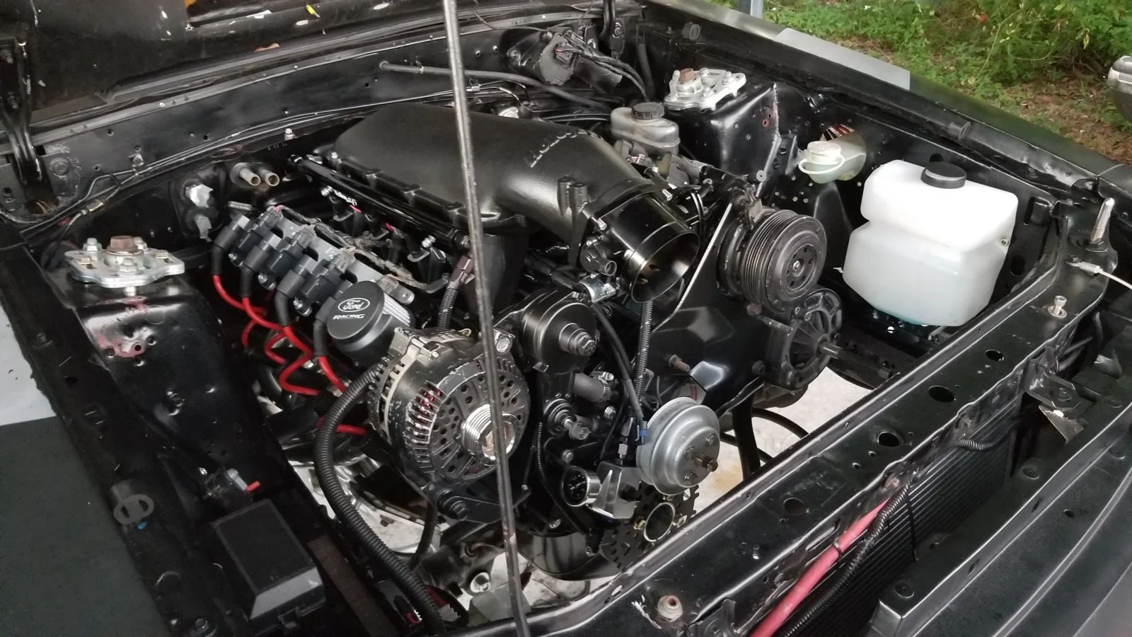

More pictures..
It's coming together, today I spent hours going over the harness and re-pinning it for the SBF from the LS it was meant for. I only have the pressure switch left to wire and I am done. The external relay box is all wired up and I even setup an SSR with heatsink to pwm the fan. In the morning I plan to cut the grommet in for the trans and O2 harnesses. The mass of my list is items that will take 30mins each to knock out.
