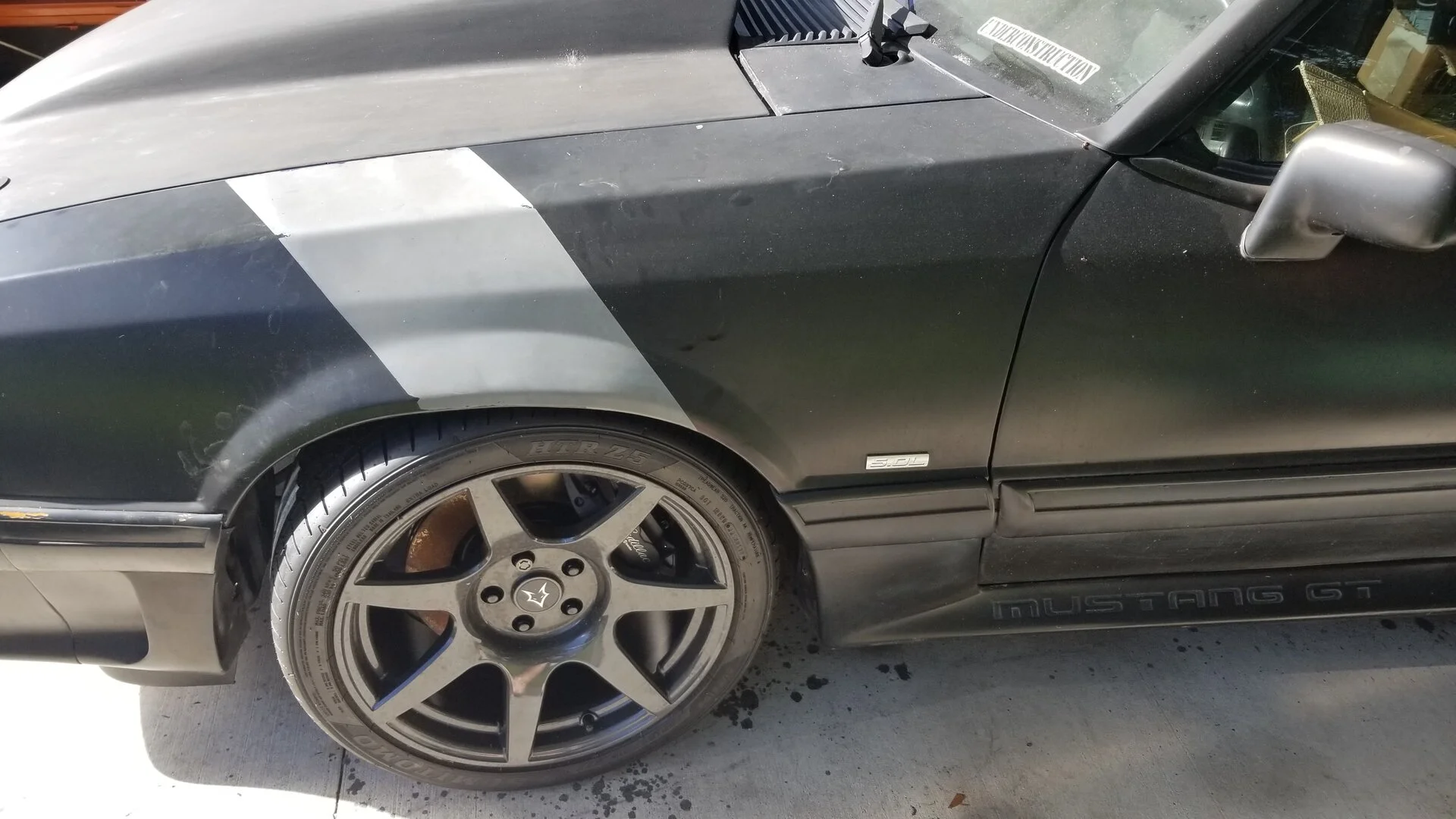

I like them, but maybe in a more subtle spot?
Underside of the hood as it sits at a show? Lower rear bumper cover?
I don’t know.... I’m just over the “in your face” decals as I’ve gotten older.

Ya know that's the thing about advertising, if its hidden it does not work.

I think they look awesome. The coloring will keep them subtle but show off the company. May one on the back glass as well?

a91what said:
I ordered some stickers for the car.. looking for feedback. Personally I like them, in case your wondering yes it is a company name.
Maybe incorporated in a lower fender door quarter stripe ?

I'm thinking you don't stick nothing on that car till you paint it. People aren't gonna get past the need for attention to detail, regardless of the quality of service you provide. Right now, your " billboard" needs jazzing up.

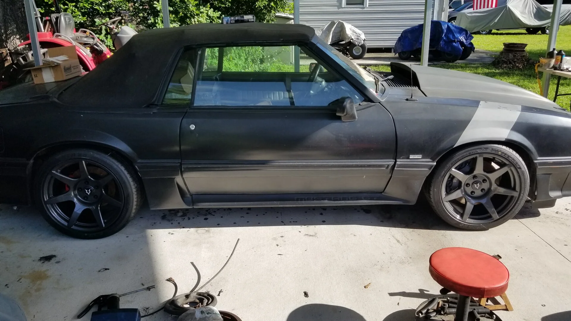

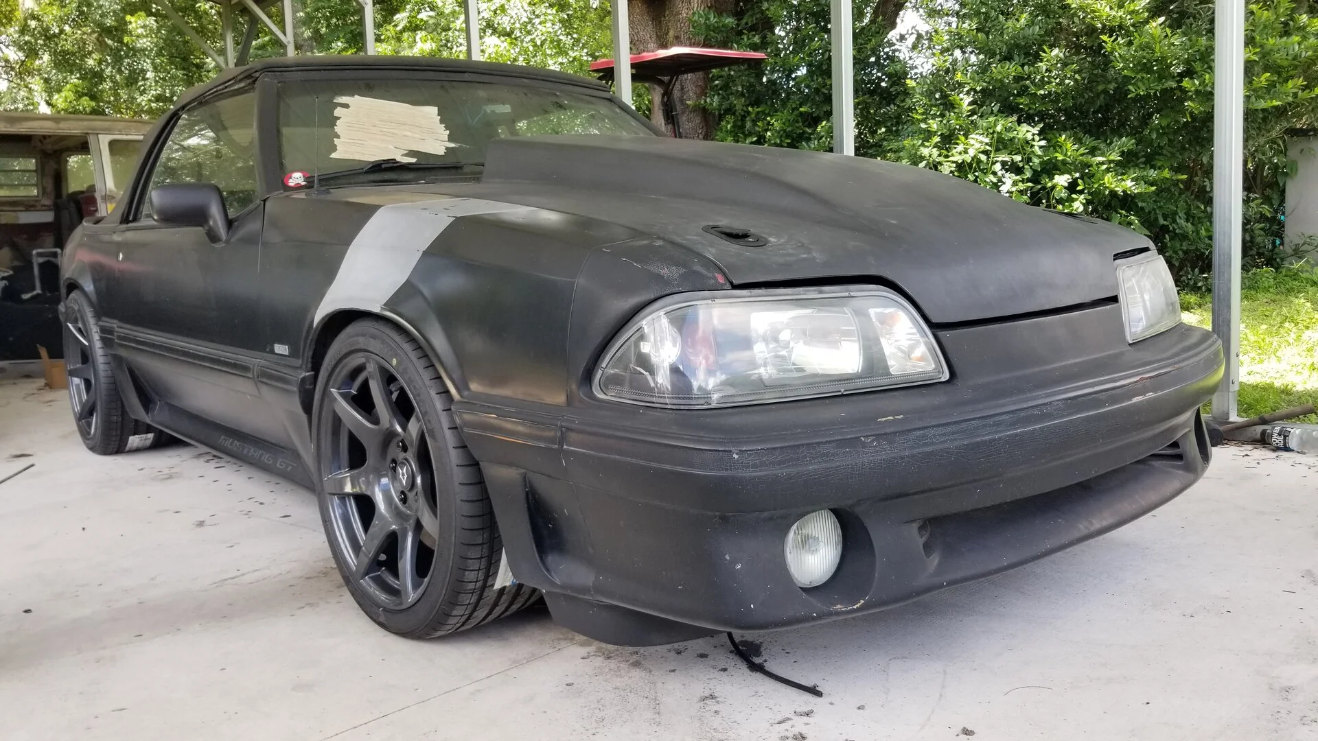

Today is a big step forward, I set the car on the ground! The first two pictures are of the car at first touchdown, the last picture is after I adjusted the tow. I noticed that after it was on the ground the bumpsteer is way off still the arm appears to need an upward adjustment. I did space the K-member 3/8" so not sure if that affects geometry that much. After the Tow adjustment the car was easy to push so its close-ish.
I still have to mount an air temp sensor in the bumper for ambient air temperature, I also want to monitor line pressure for tuning purposes [microsquirt on the transmission] so I need to add another 300psi transducer on the transmission. The car needs a bath but I have been making slow but steady progress. I did get the scott rod panels in but I have yet to install them I think I will wait until after the car has its test drives and initial tune and the paintjob.
If you are wondering
265/35 R18 front and 285/35 R18 rear
they tuck up into the fenders nicely, fox length axles and 96 spindles
have not checked for tire rub yet.

Did I miss why there is tape on the winshield?
Hole?
Peckerwood Fix?
Painting the rest of the windshield but just masked of this part?

It used to contain a list written in sharpie... project has been going to long and its no longer legible

Do you have a bump steer kit installed ?
The one I installed made a world of difference in the way my car handled.

Looks awesome! Love the wheels!
