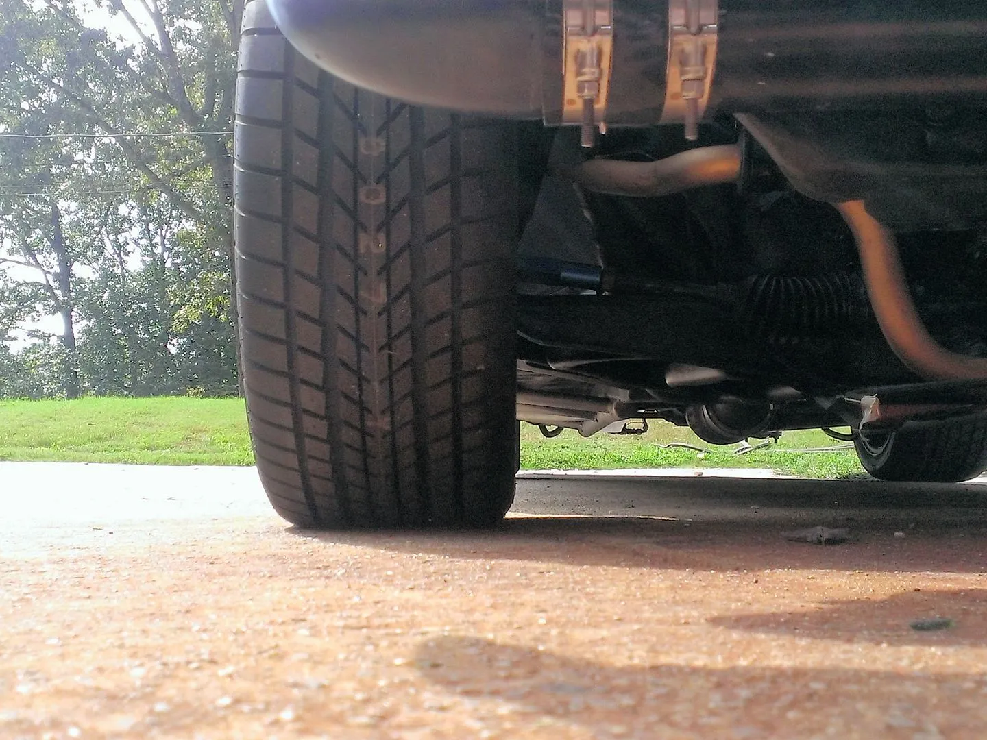

I’ve been looking for this for days..Now that I’ve re-opened the photobucket account so that I can get to all of the pics, Ive realized that I’ve just created a proverbial “ grandpa’s attic”, and I’ve been crawling through it searching for old, dusty, stuff.
Like this,...taken from 2014.
This is before I added the 50 thousand spacers to bring the tie rod parallel with the lower control arm. And despite having done that, have no “ after” pic to show it. All i’d have to do would be go downstairs, and take it IF the car was on the ground, but unfortunately, it’s not.
If I get lucky tomorrow, and the car gets started by sunday,...maybe it’ll be on the ground and i can give you the after too.

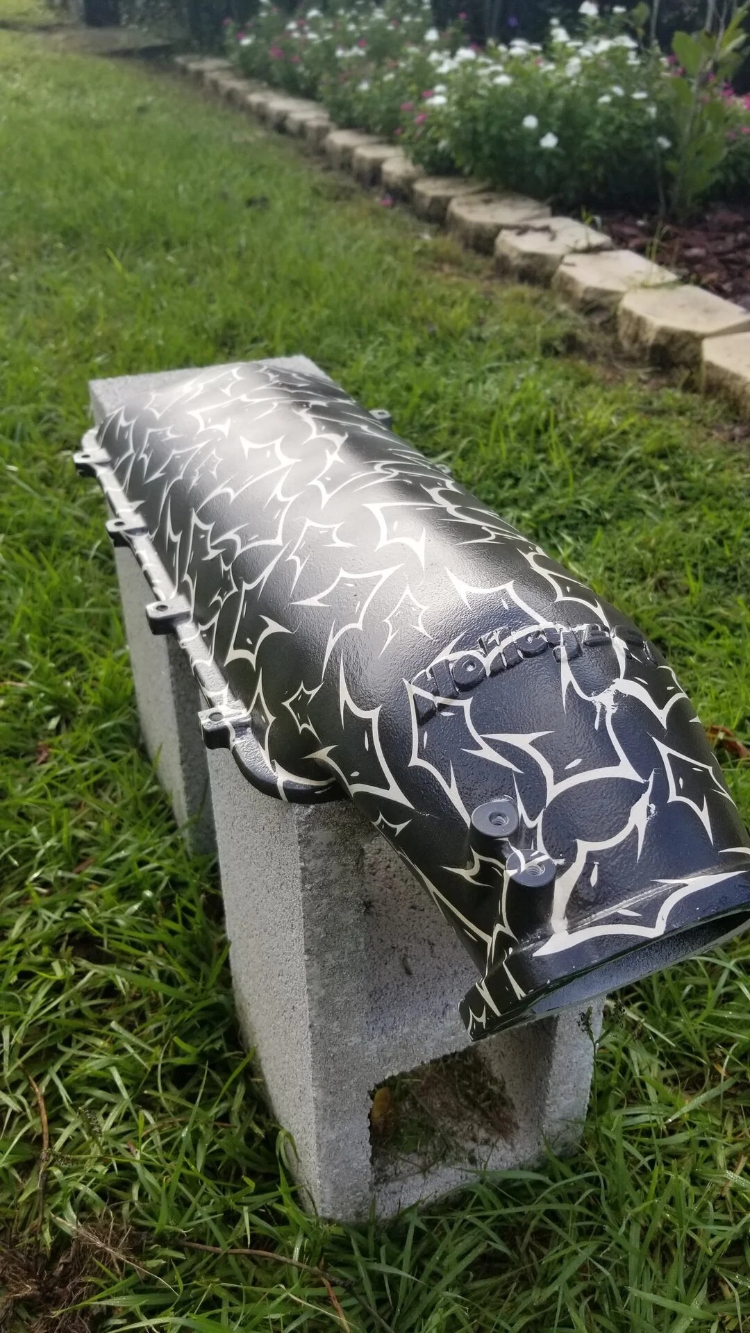

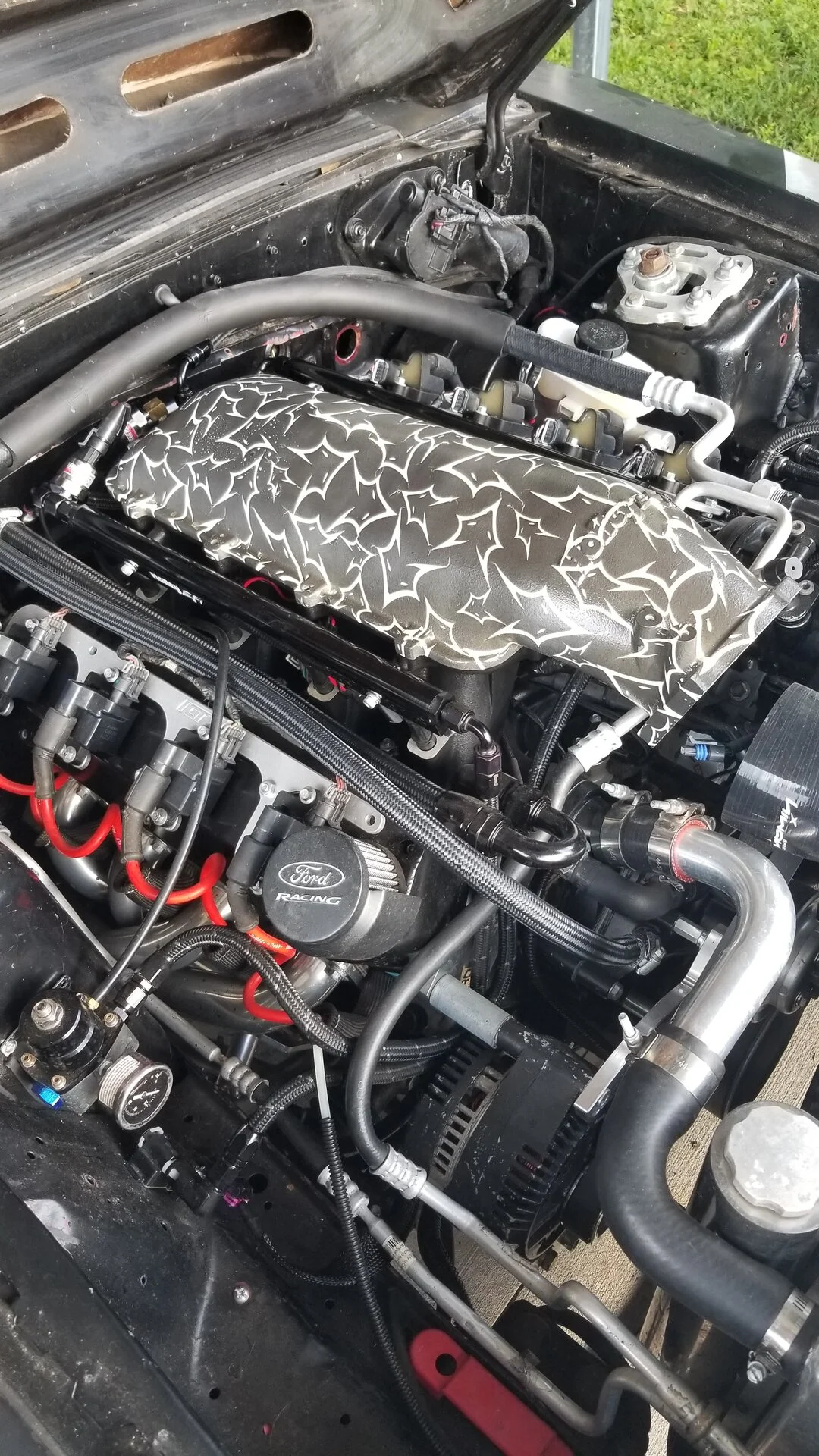

It took 4 tries to get this right... and it's still a little wonky but I dont care it looks cool. I used a pearl white basecoat.
Now I know why they say to let an experienced hand do parts this large.
