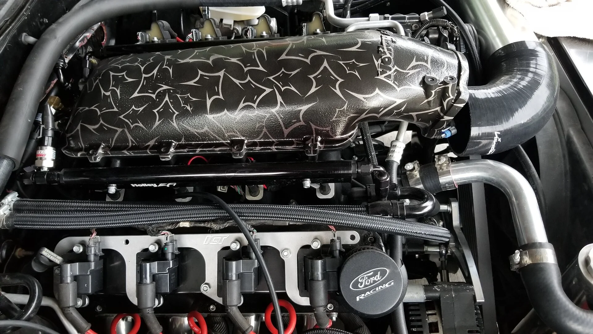

Finally done, I could not leave it that lightly colored. Some tinted clear worked nicely to darken it up.

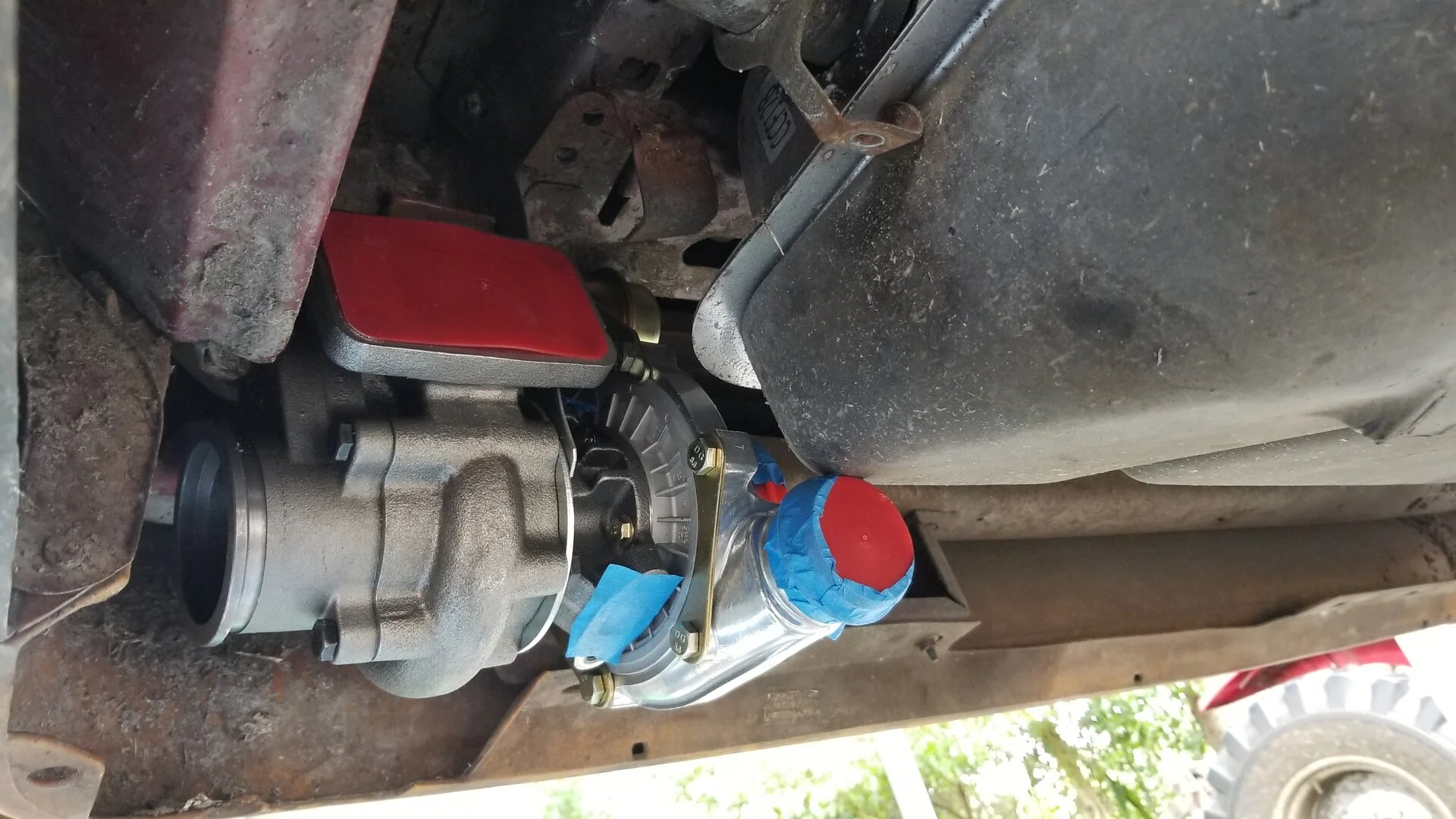

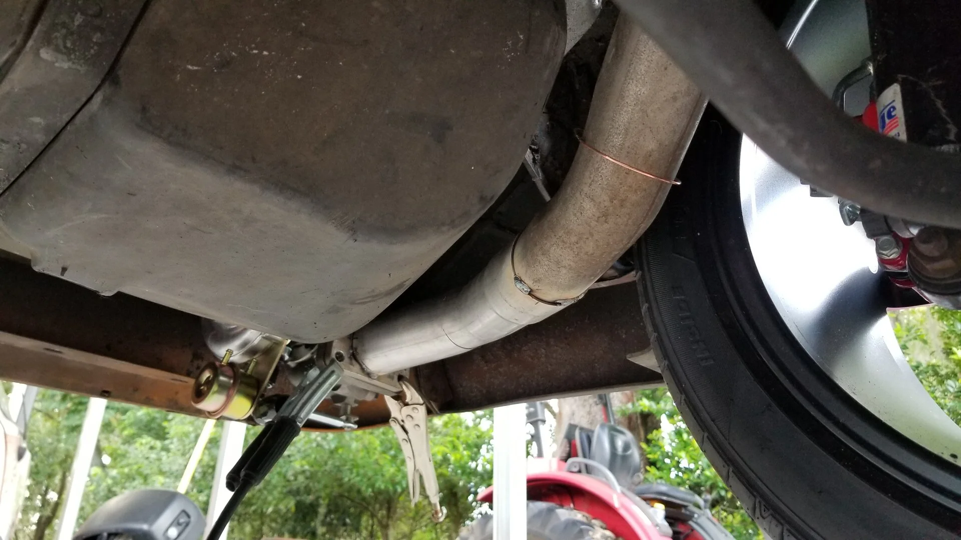

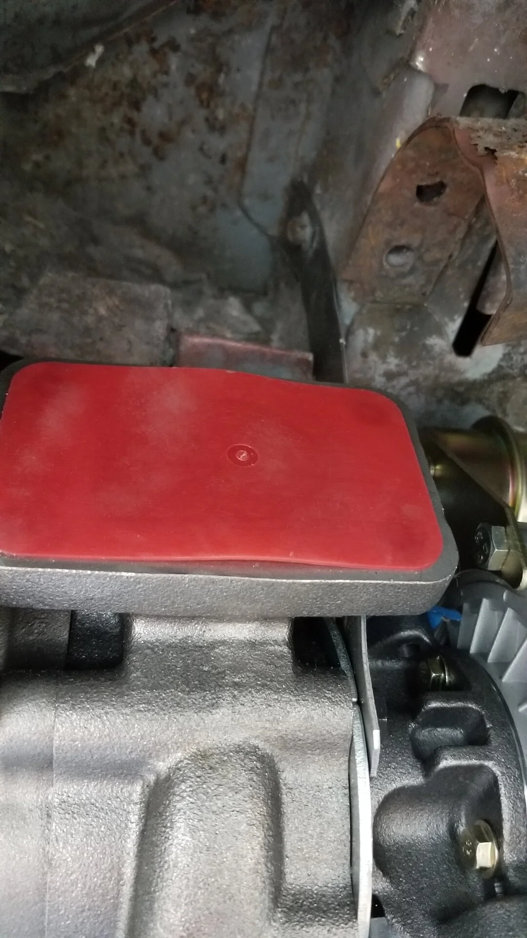

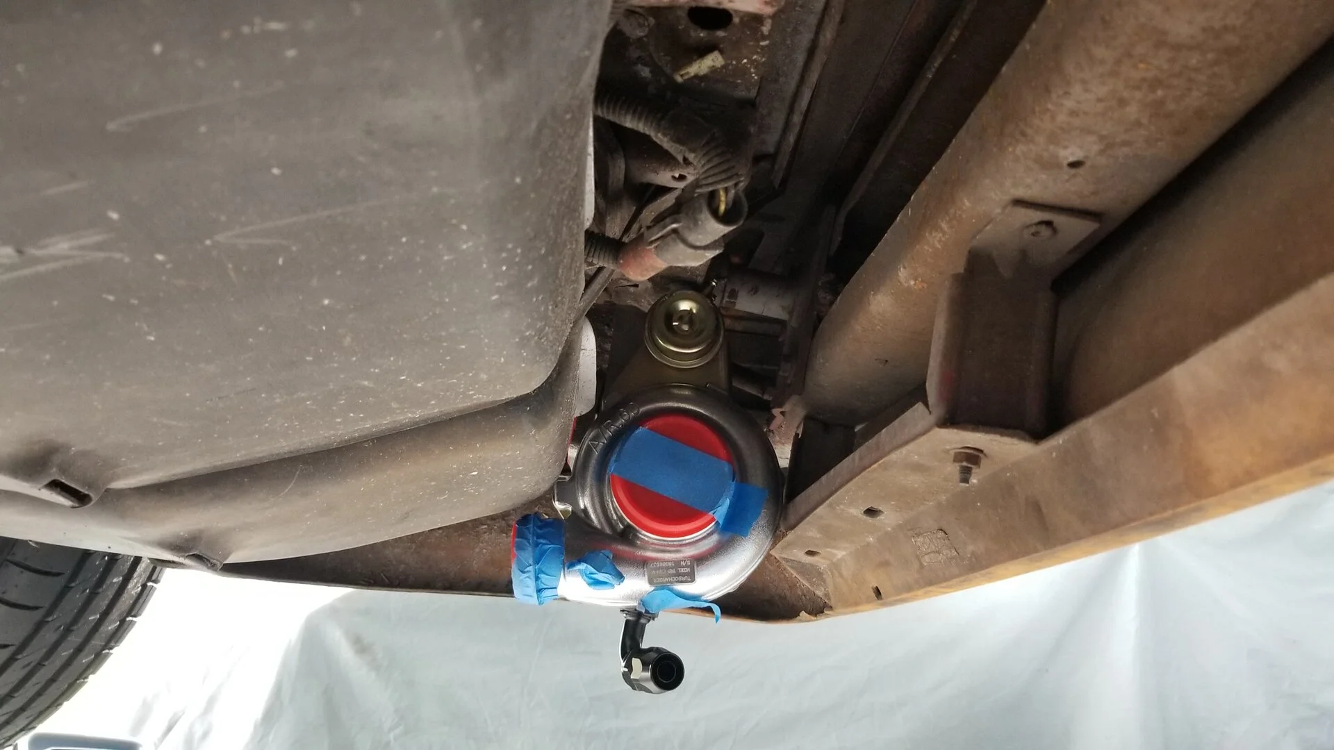

Well today was eventful and frustrating but I did get the turbos mounted and part of the hot side in. This took quite a bit of time as we looked at many mounting options and finally settled on a location. Unfortunately pops has been having pain issues so he took off after lunch so most of the mounting had to be done by myself.
I am just now getting the hot side tacked into place, I dont want to get too far ahead because I will have to route the cold side as well. I am being cautious and going slow.
The turbos ended up in the rear bumper, I did not want to mount them in this location but after mockup they fit great although the exhaust will have to do an odd side bumper exit. both exhaust will exit in the same location on either side, the wastegate looks lower than it is in this pictureit's actually fairly close to even with the bumper.
You can see in this picture how close it is to the bumper cover, luckily they wont get that hot but I am going to blanket them both anyway for good measure. The cold side here will pipe above the fuel tank, there is actually plenty of room to fit a 2.5" pipe above the tank lip. The cold side will then hug the body of the car and slide past the hot side. The turbo exit is only 2" so I have leeway to oval the pipe if needed.

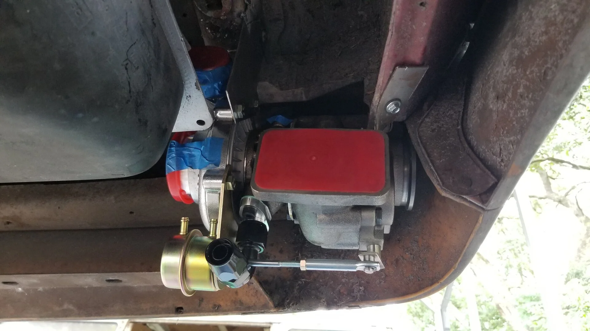

a look at the passenger side, both turbos will have enough room to breath from this space, they will get decent filters and I plan on making some coffee can splash covers.
Notice how low the oil drain hangs.. I ordered a tight 90* fitting that will save me .75" and i will clock the center so its tilted at a 30* angle to give more clearance, good forbid It snags a speed bump or some .
I will mount the suction pump between the turbos in the bumper area so even tilted I wont worry at all, its rated to be mounted above the turbos.

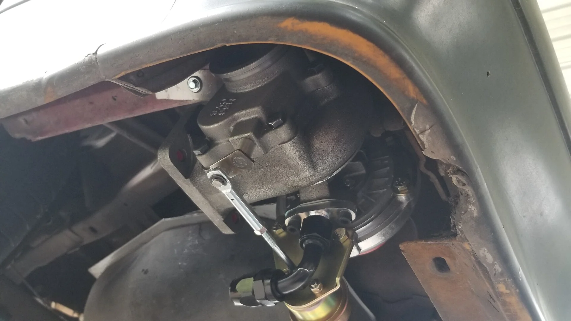

This side has the filler neck, I am going to take a 180* bend and cut it to make a s pipe to offset down away from the neck for the hot side. The cold side will have to be figured out maybe I can find a rubber offset coupler.
Reactions: stanglx2002, KZGUNS and Davedacarpainter

Looks to me like it’s not only viably safer, but for the sake of space, a fuel cell is in order. You are placing two glowing hot chunks of cast iron within inches of the gas tank. Not only that, but the confined space that won’t allow heat to escape will heat soak the surrounding areas. I have a problem putting a muffler that close, but a turbo adds a whole nother level of kelvin.

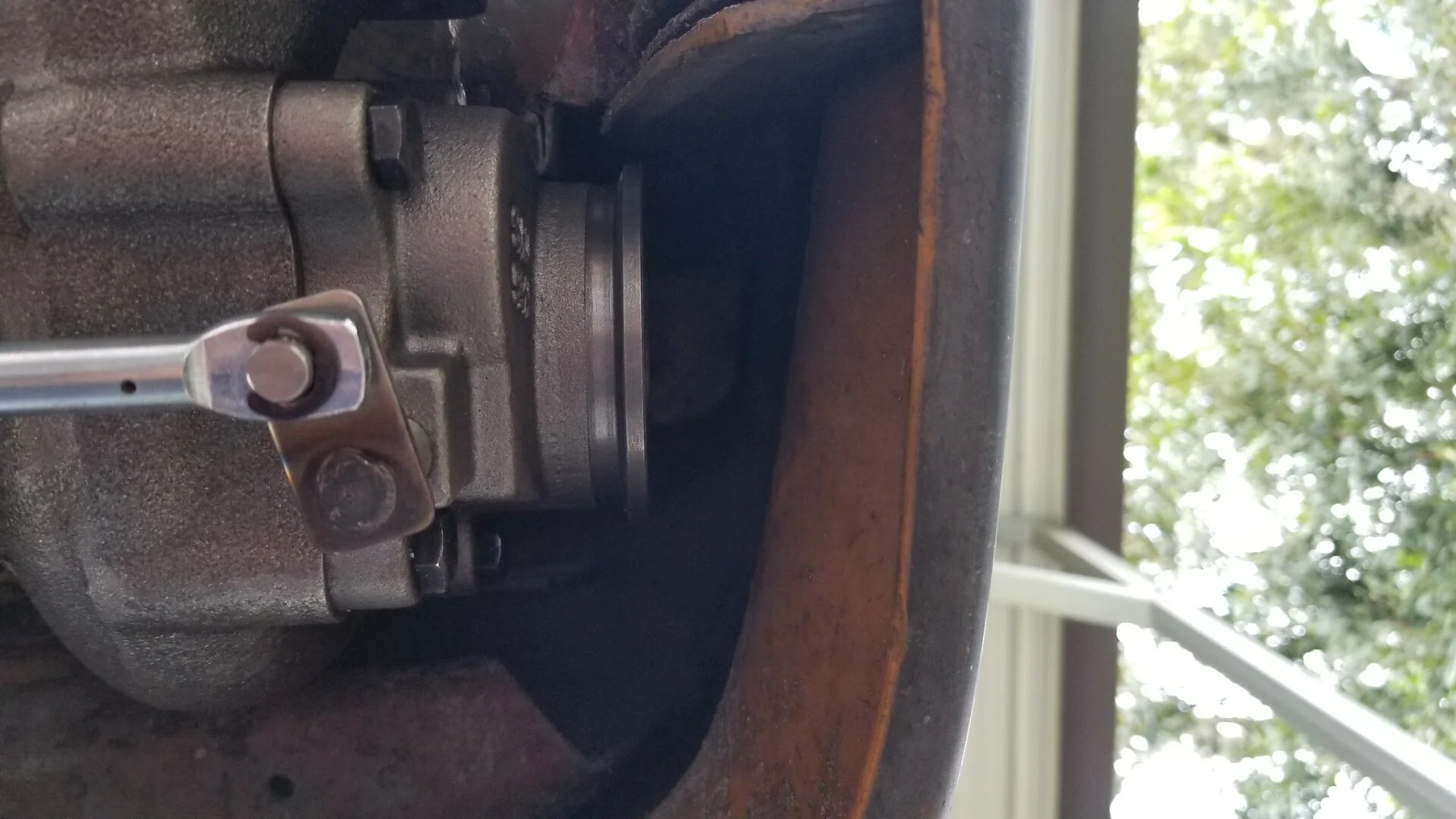

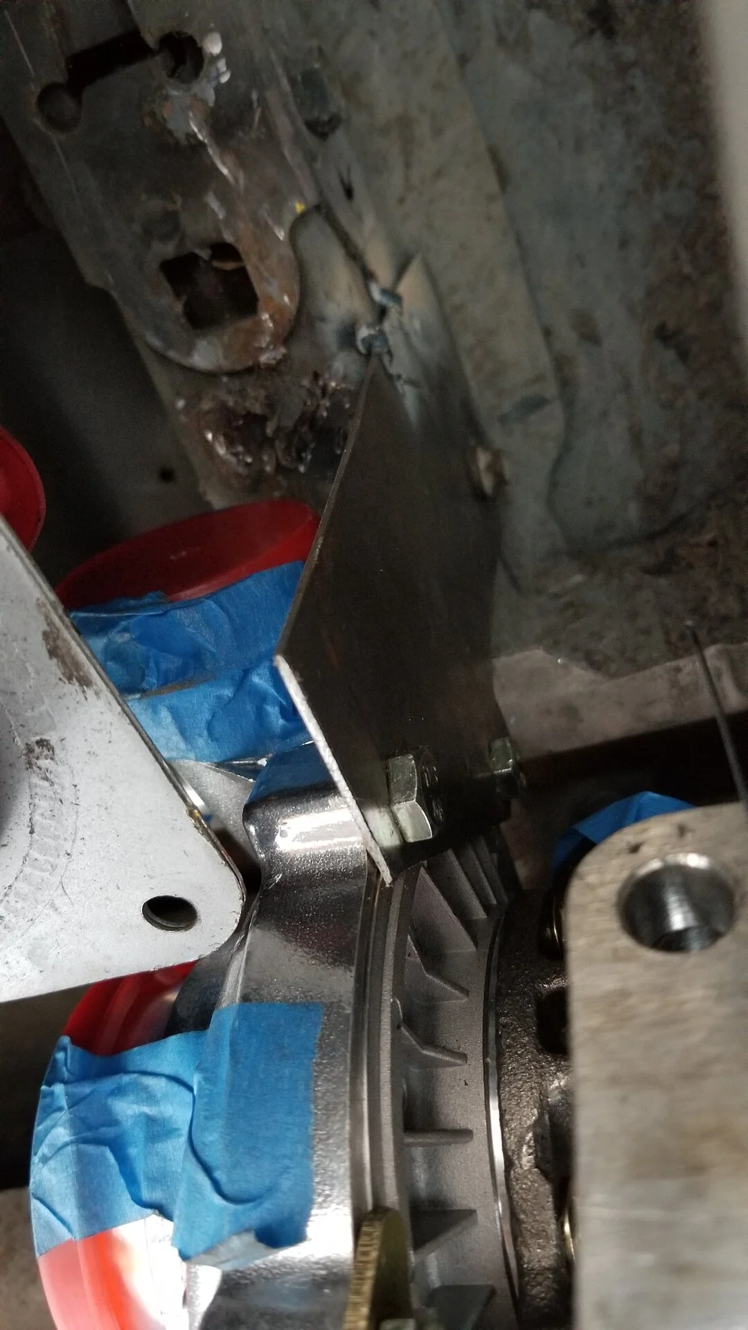

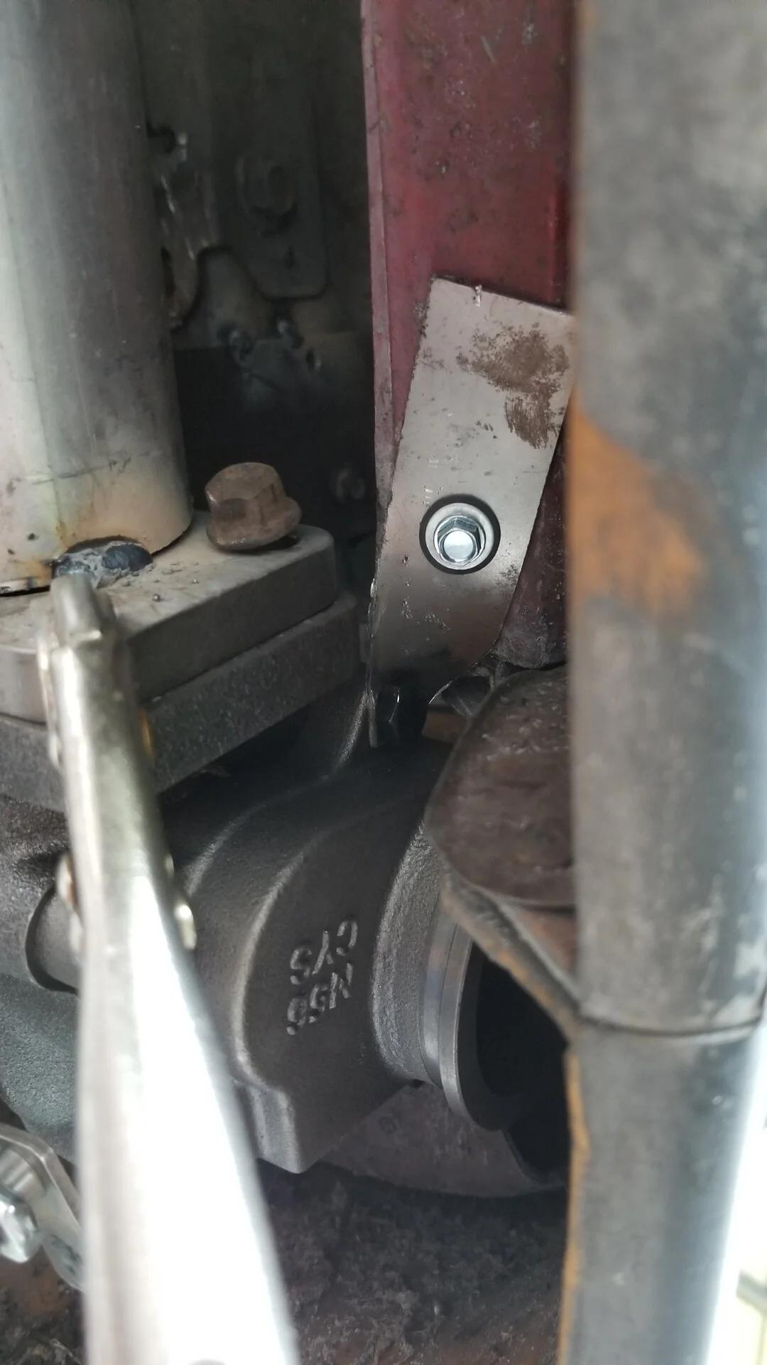

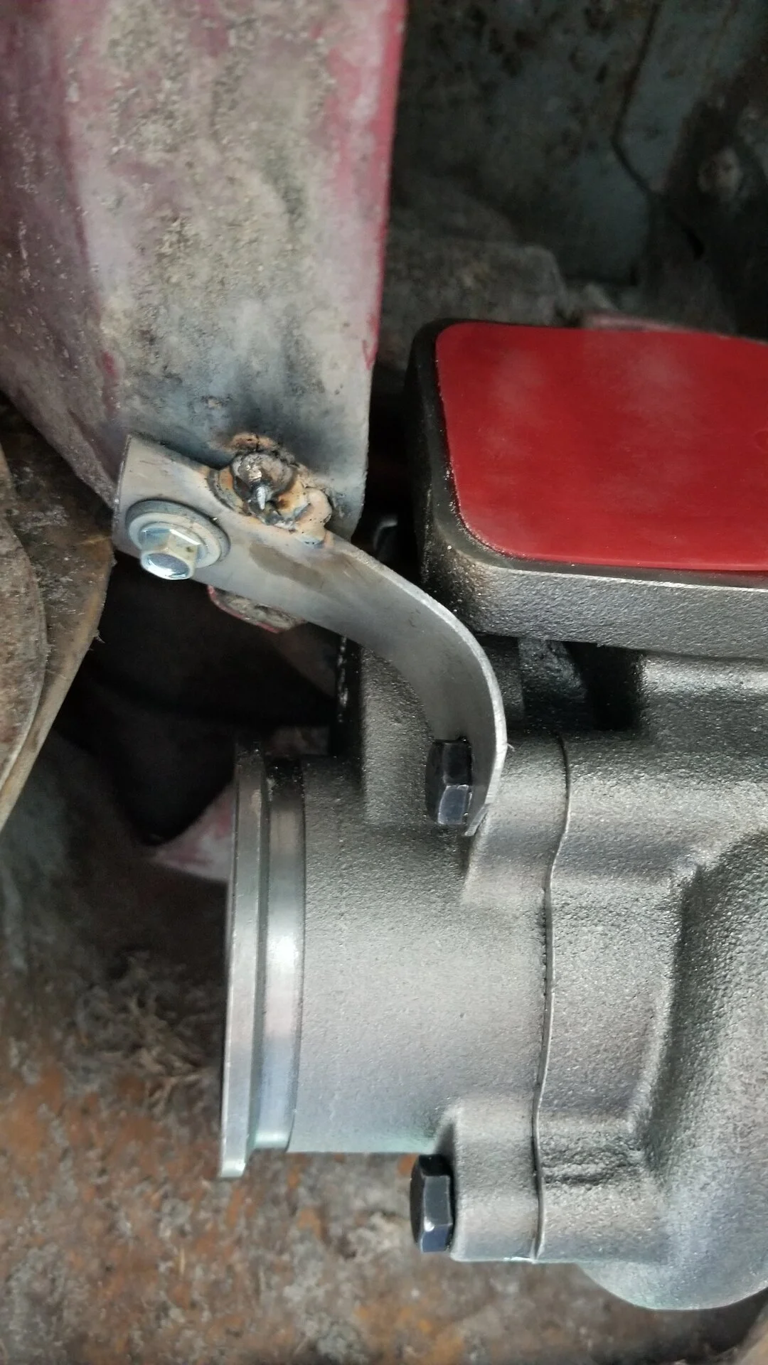

Mounting the turbos, we removed the factory exhaust hanger and reused the bolt to hold the brackets on both sides. The mounts are simple sheetmetal that will need to be painted when I remove the turbos for final install, i still have to put the oil feed lines in and i am not going to bother trying to do that with them installed. The turbos are mounted rigidly
Drivers side tacked in.
