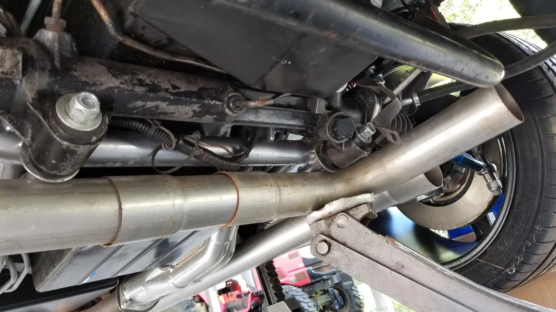

a91what said:
Some more progress made, I have the cold side all the way up under the k member and I am ready to begin fabricating the merge pipe. I am considering different ways to mount the cold side under the kmember, the simplest solution to me is welding it to the washers for the steering rack. I may even weld some tabs to the cold side and do a skid plate.... we will see.
Methinks you don't have enough protrusion of your steering rack bolts through the nuts.
They are not tight yet, I plan on supporting the coldside with a large washer through them.

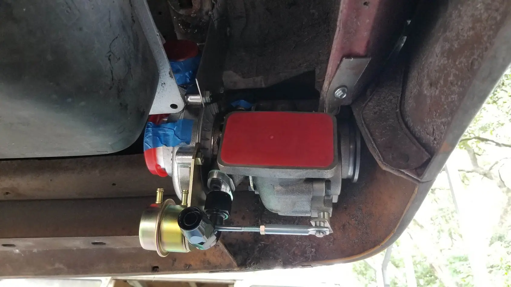

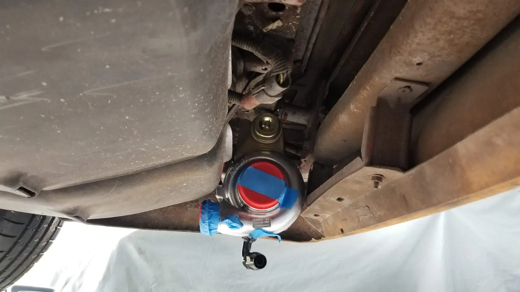

Well... my progress was dampened with 'honey do's ' last weekend but I have some time off over the Turkey day break.. I did get the fuel tank dropped and the new 340lph pump and hanger installed, the new hanger has -8 feed and -6 return built in to it so I started routing the nylon braided lines under the car. I went with Vibrant line as I found it on sale in 20' lengths.
I had to remove the turbos to get at the fuel tank so while I was in there I painted the turbo brackets ect. I also put all the fittings in place to make sure it all fit and clocked the passenger side turbo so the oil drain is not hanging down as low...
The items that are below the level of the bumper cover sortof concern me a bit, I dont think its a major issue but a large speed bump could wreck my day if it takes out the oil drain fitting.... so this brings me to my question of the day, rear skid plate/ diffuser..
the GT bumper already sits pretty low so I am not sure this would even serve a benefit beyond making me feel better about the one oil drain.
passenger side.. this is an older picture the fitting has been clocked 30* tward the bumper and is a short radius 90 so its significantly shorter.
this is the driver side, this one actually does not hang down that much maybe 1/2" past the bumper you cant see these standing next to the car and it sits higher that the fuel tank.

KZGUNS
I can swing up to 11”
5 Year Member
Jul 23, 2018
1,002
588
133
chardon, Ohio
Nov 19, 2020
#4,337
  • Nov 19, 2020
  • #4,337
I wonder if that drain adapter on the turbo can be made to accept a banjo type fitting that would tuck it up tight to the housing

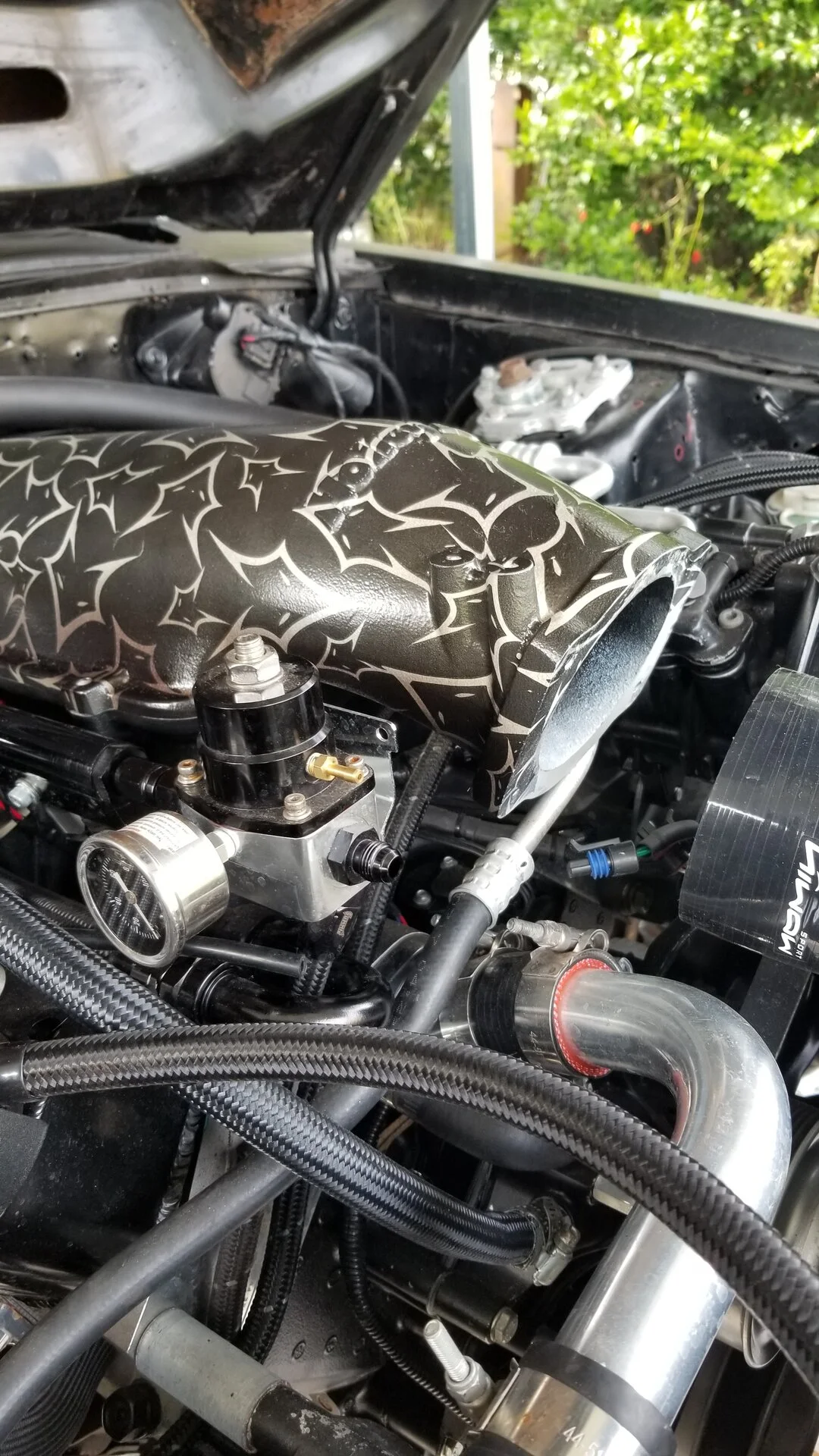

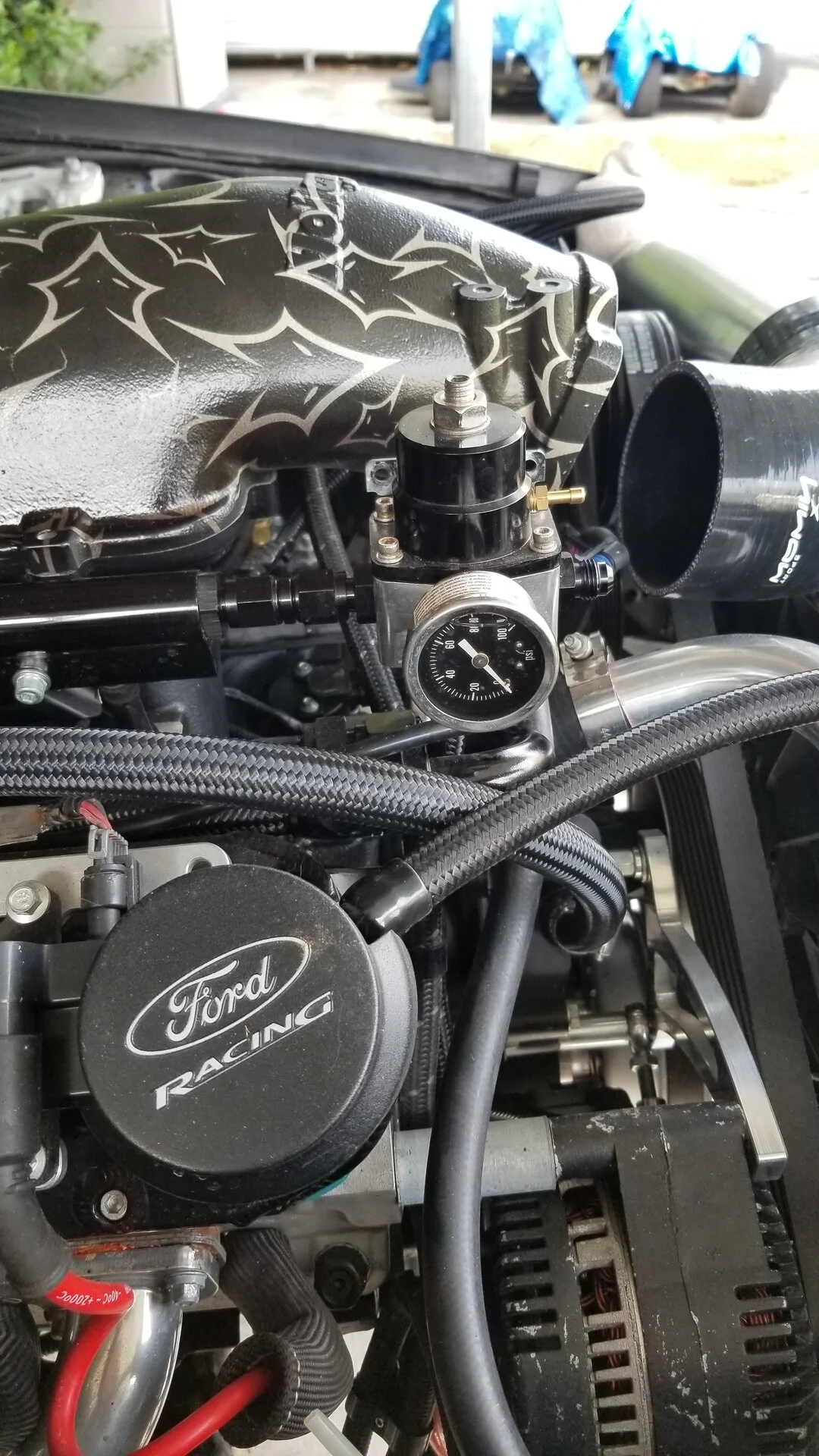

I am replumbing the fuel system, I decided to see what the regulator would look like mounted to the fuel rail.. if left in this location a bracket would help support it so the fitting did not.
Thoughts?

CarMichael Angelo
10,641
8,909
Birmingham, al
Nov 22, 2020
#4,339
  • Nov 22, 2020
  • #4,339
i’d remove the mount bracket from the bottom of the regulator, and run it there.
WhiteCobra95
May 2, 2006
634
177
74
Nov 22, 2020
#4,340
  • Nov 22, 2020
  • #4,340
That's too much free mass hanging on the other end of a fitting. It's going to vibrate and over time the fitting will loosen = fuel leak. It needs to be mounted to something in order to take the free mass out of the equation.
