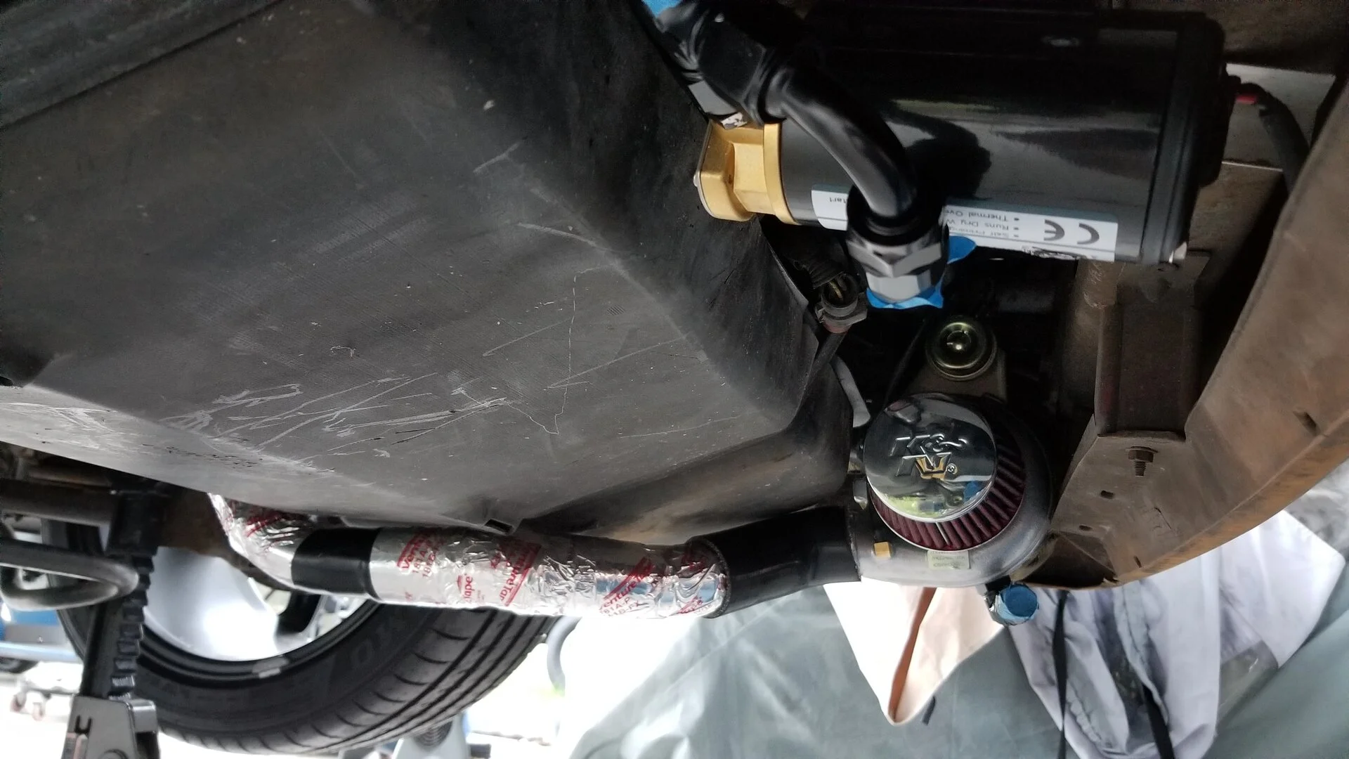

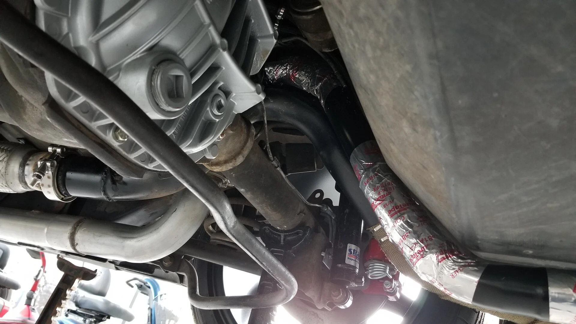

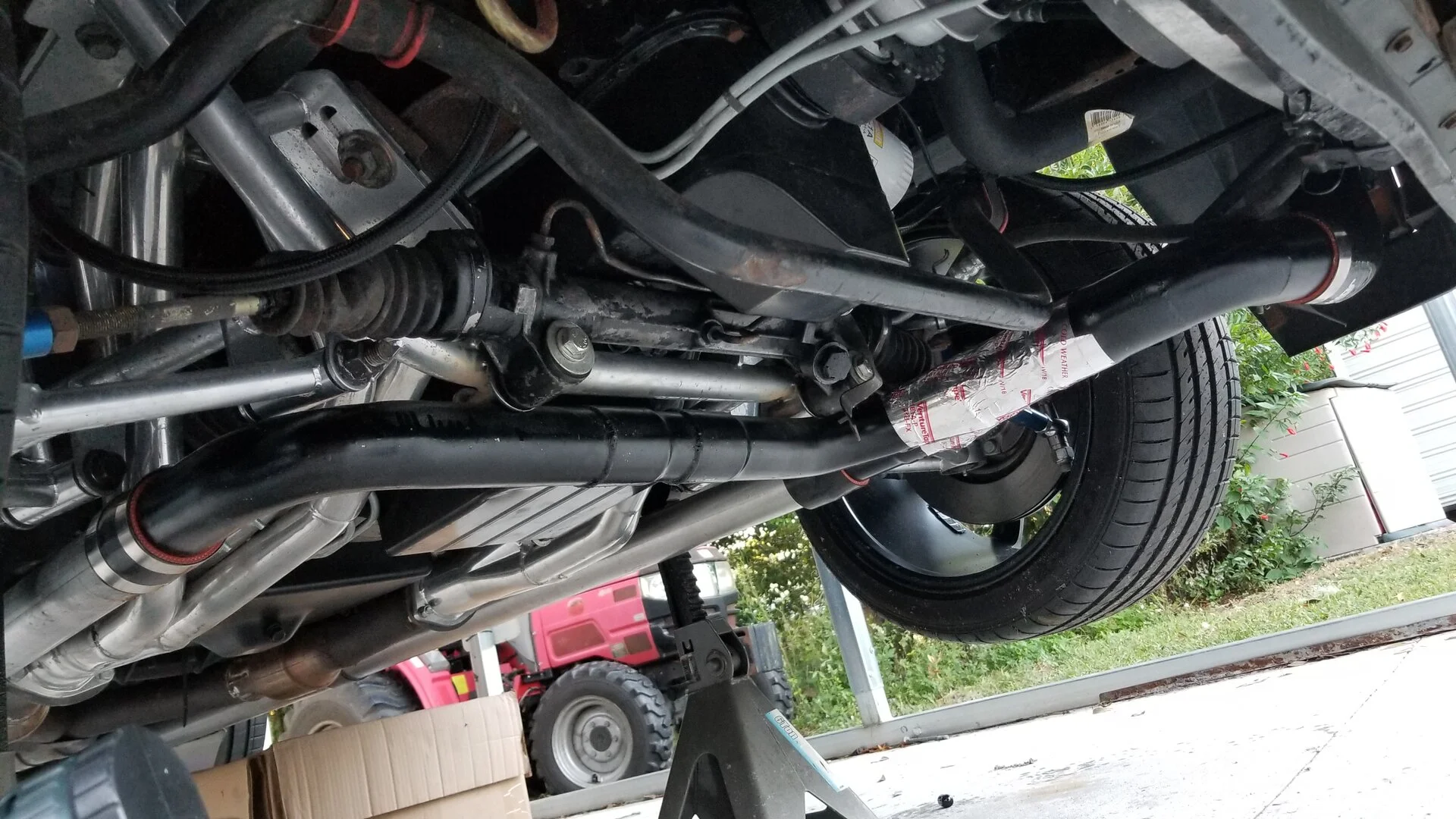

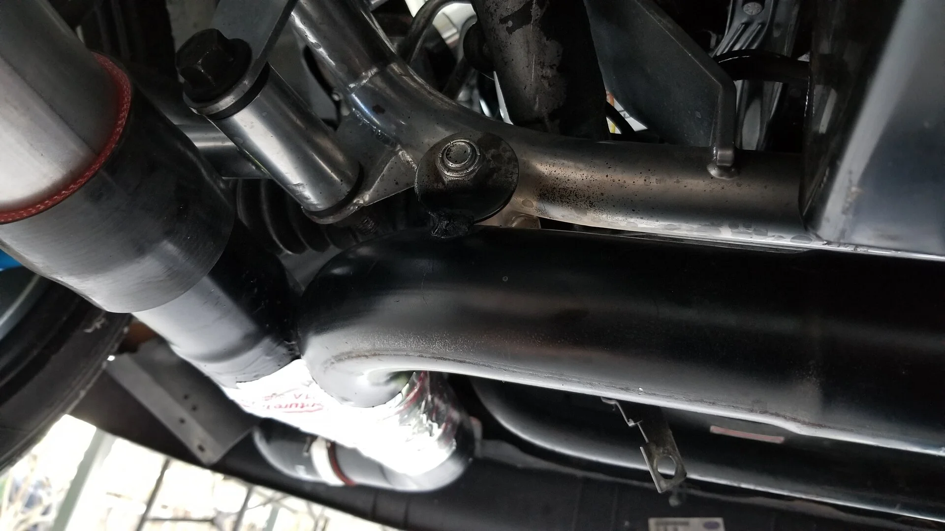

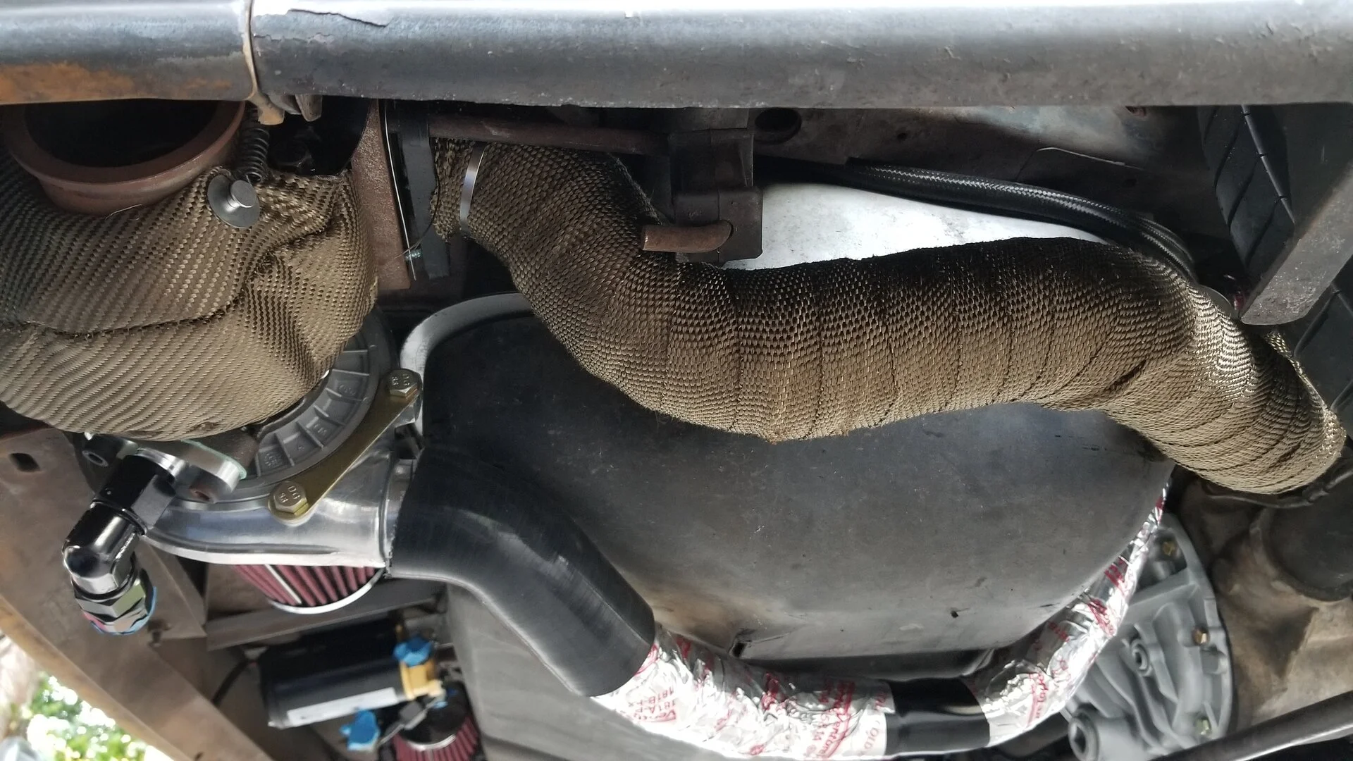

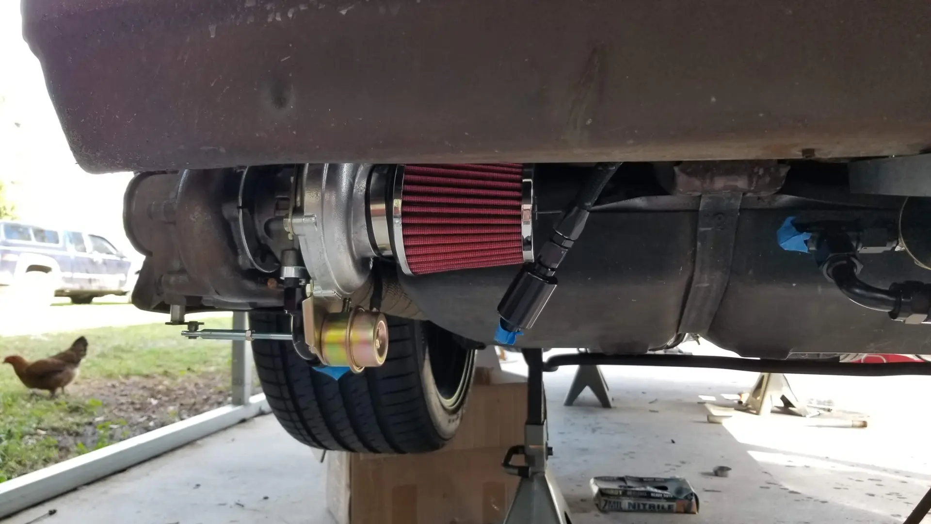

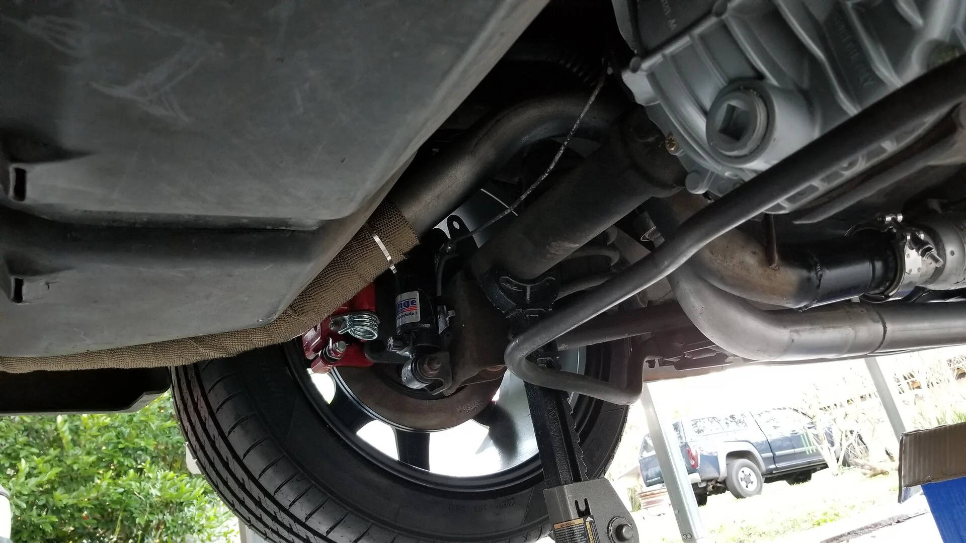

I have been working on this for a few days in a row... looks like I did not get much done but I am taking my time.
Driver side turbo.
The driver side fit way easier than the passenger side.. you can see both hot and cold sides running up to the front. I used Vbands everywhere so no leak issues I hope.

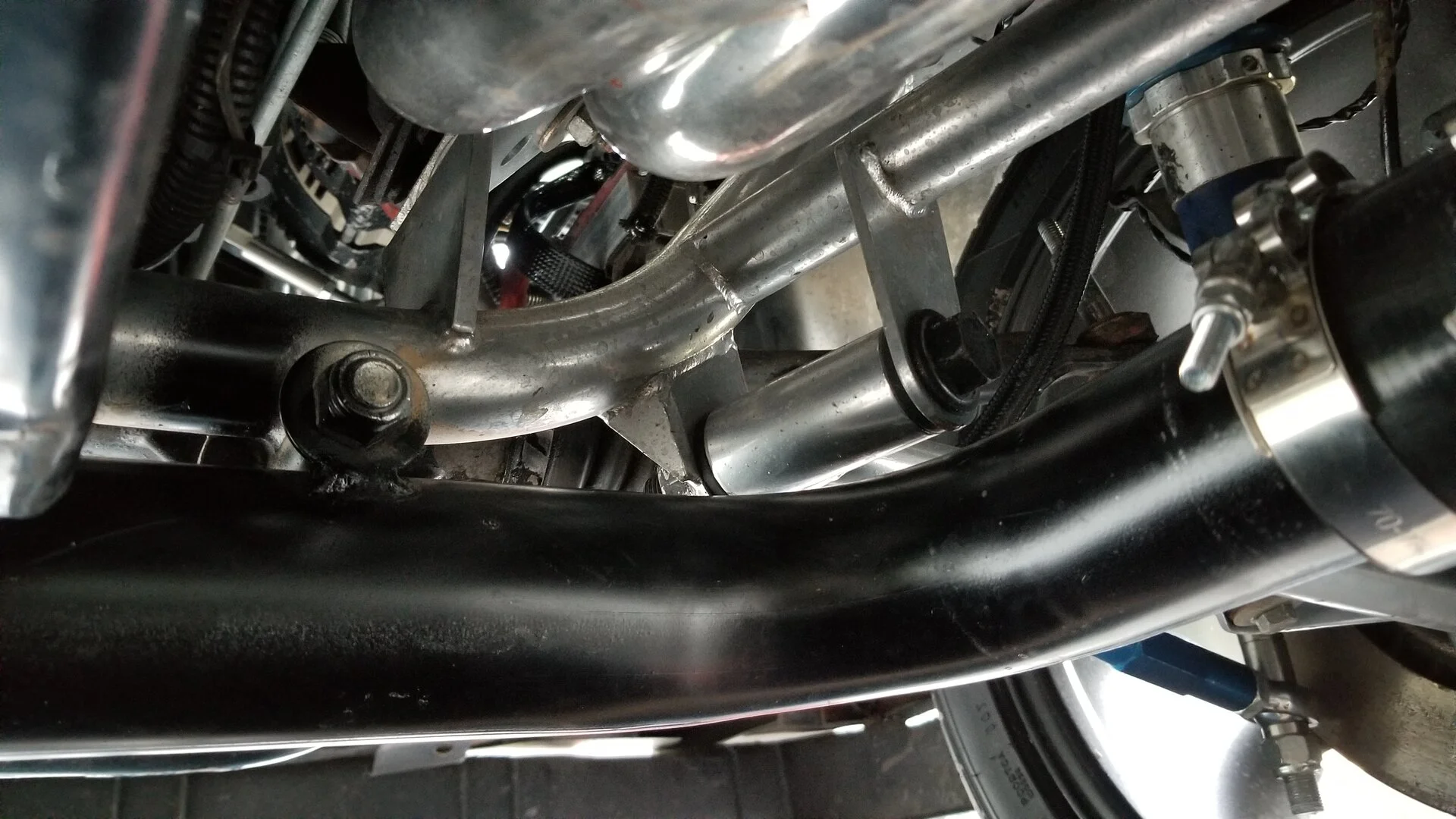

Passenger side. This is a bit messy
That pipe is the lowest point going under the fuel tank.. it should be ok I think or uhh hope. Lol. We will find out. Dont mind my foil tape.

Merge pipe is hung from washers on the rack, I can remove the bolts and pop it all apart if needed.
Driver side turbo.
in the last pic, it looks like there is almost no clearance for the exhaust to route coming off of the turbo..Optical illusion?
That's an illusion, there is plenty of space.

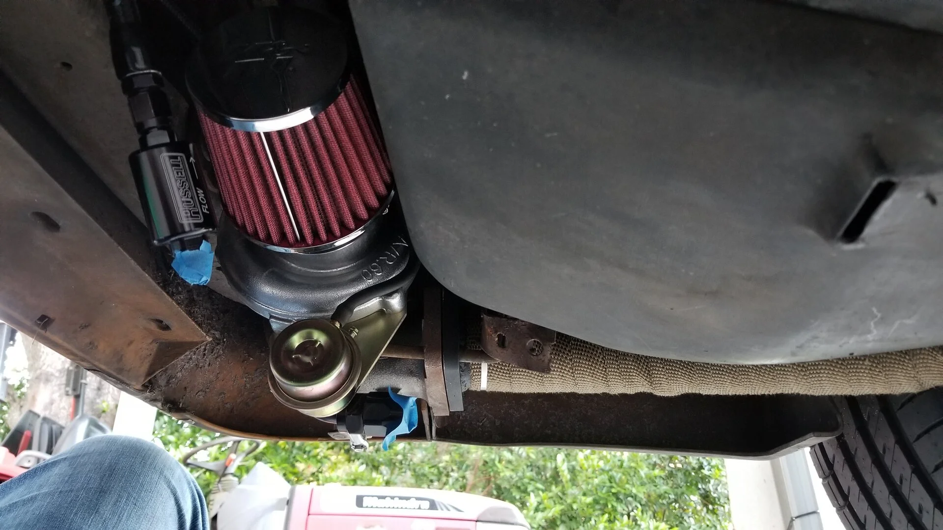

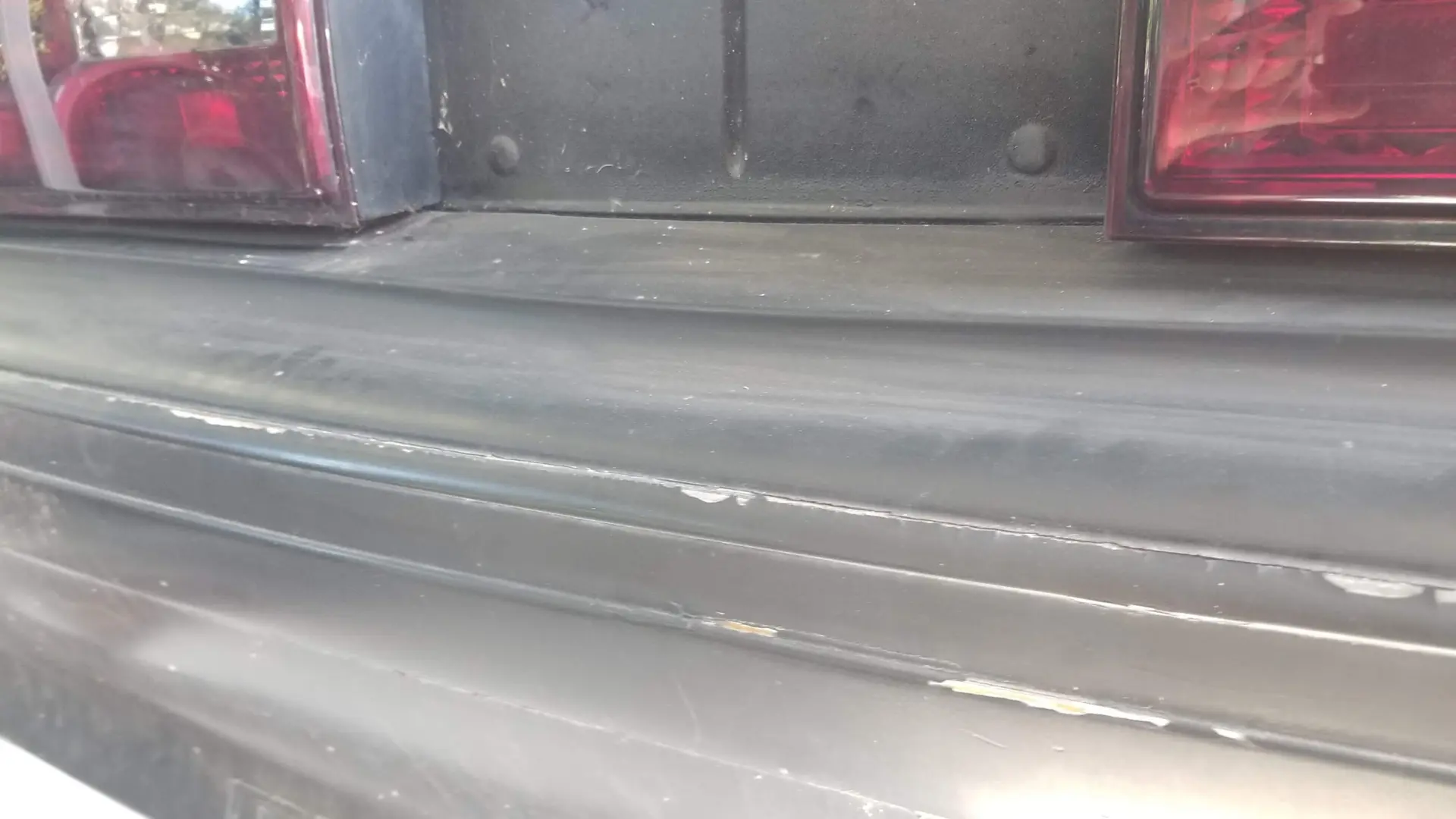

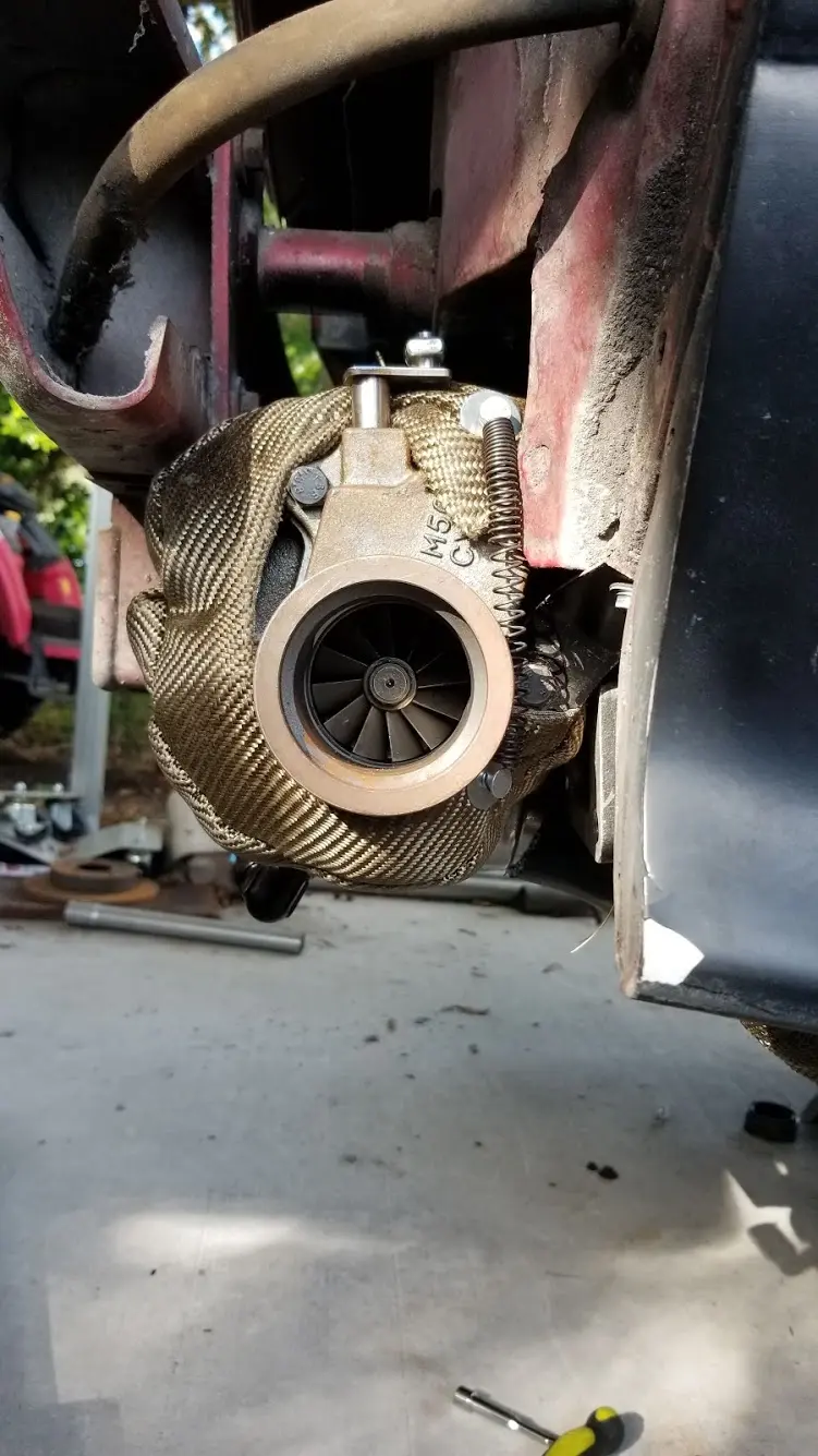

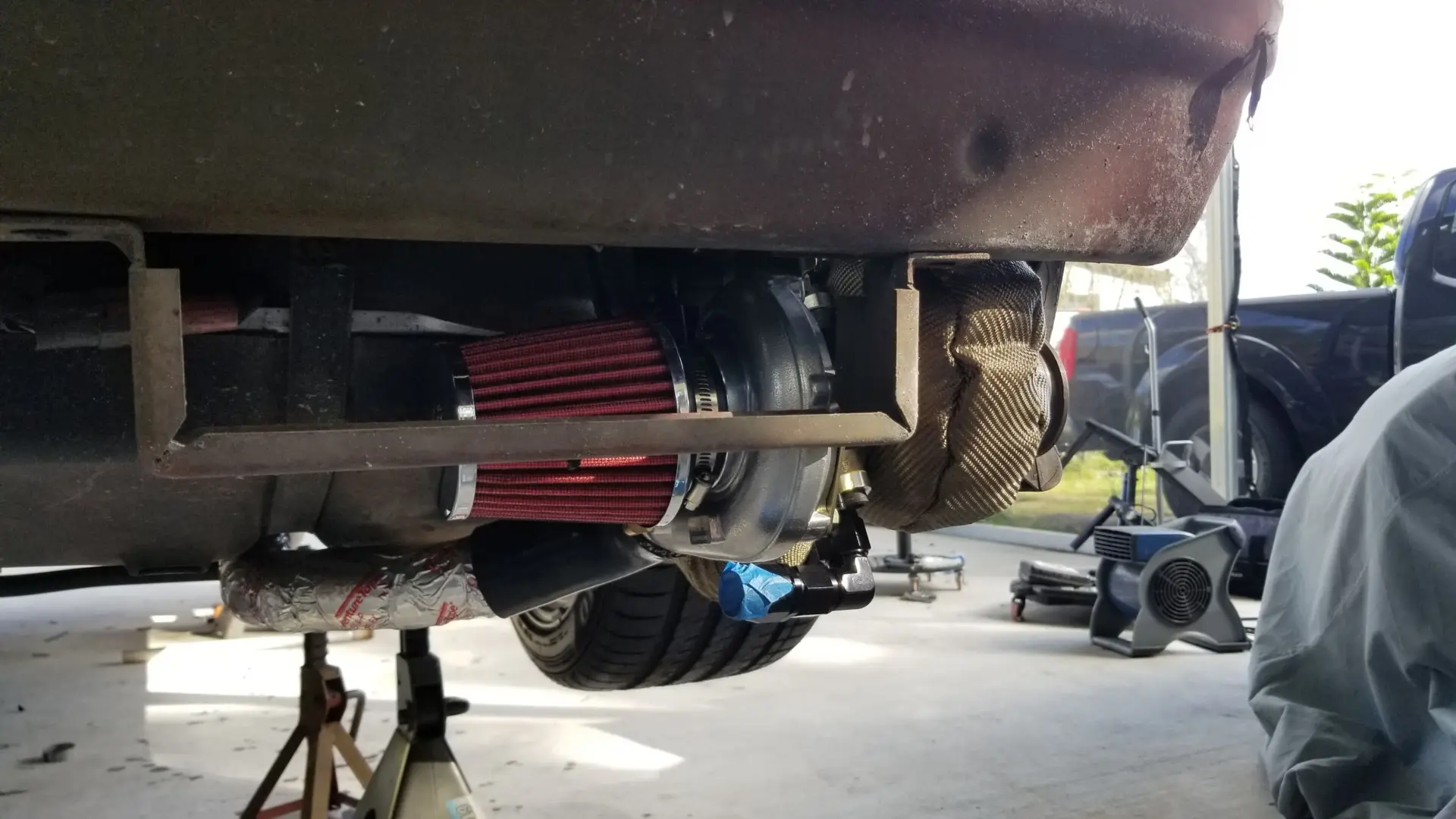

Ok so I am going to post this as a reference pic
the bumper before the insert.
bad paint aside, thats some serious droop on the bumper.

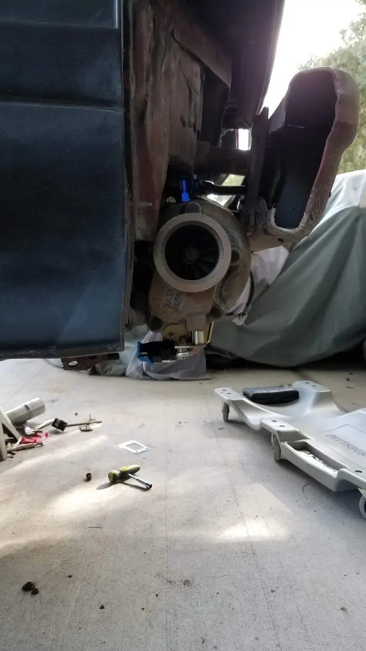

once I got the bumper off I decided to take some pictures of the turbos before I start wrapping up the install... why do I make things harder than they need to be? why didnt I take the 20mins to remove the bumper BEFORE i started making brackets and installing the turbos.. FML i am an idiot sometimes.
and now after looking at these two photos I have to go and take another measurement.. they do not look to be the same height in relation to the bottom of the bumper cover.. but it could be camera angle trickery

So they are off by enough that I will have to do some pie cuts to get them corrected.. not a big deal. I'll just cut the bumper cover where it looks the best then figure it out. I really wanted to do turn downs but the inward curve of the bumper does not allow enough room.

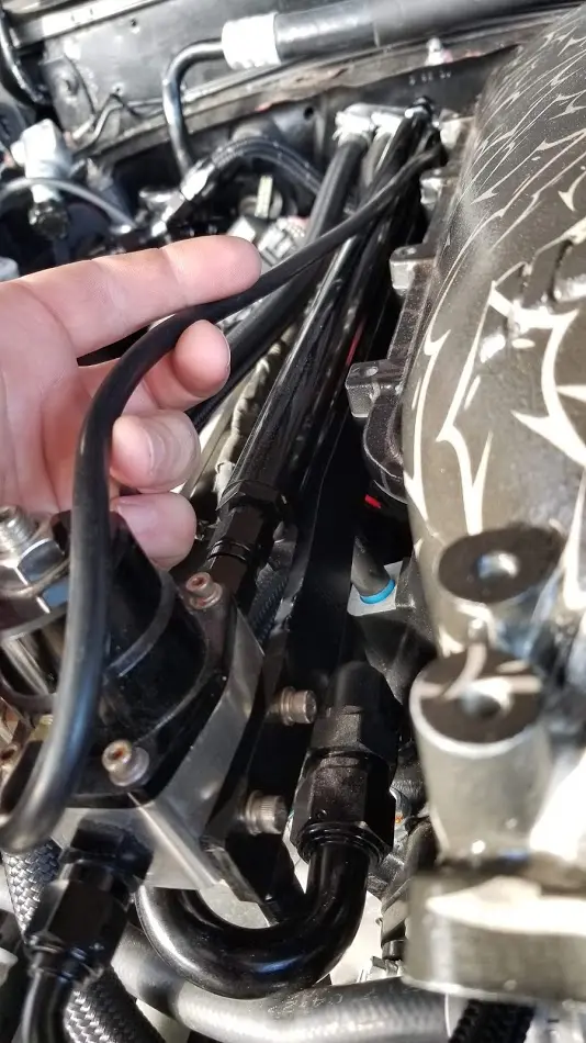

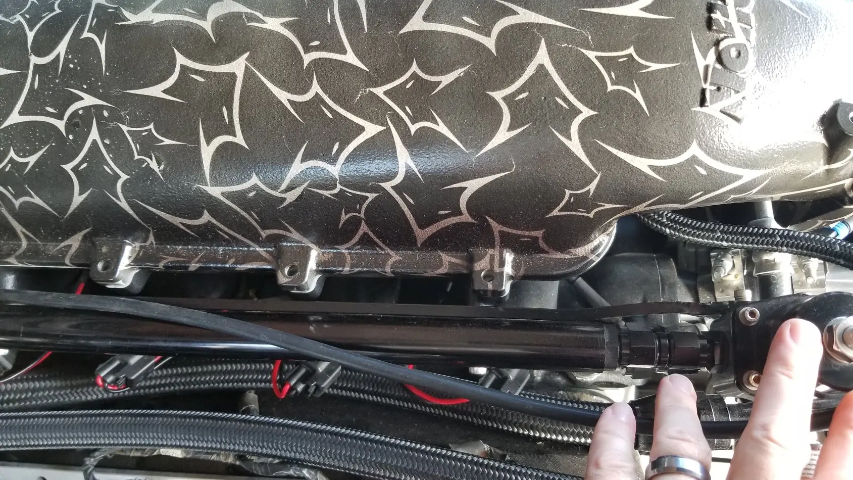

did a thing while swapping the injectors out for LU80's. You can see the piece of aluminum I bent and twisted, then drilled. it took the place of the spacers for the fuel rails and holds the regulator so the fitting will not come loose from vibration.
