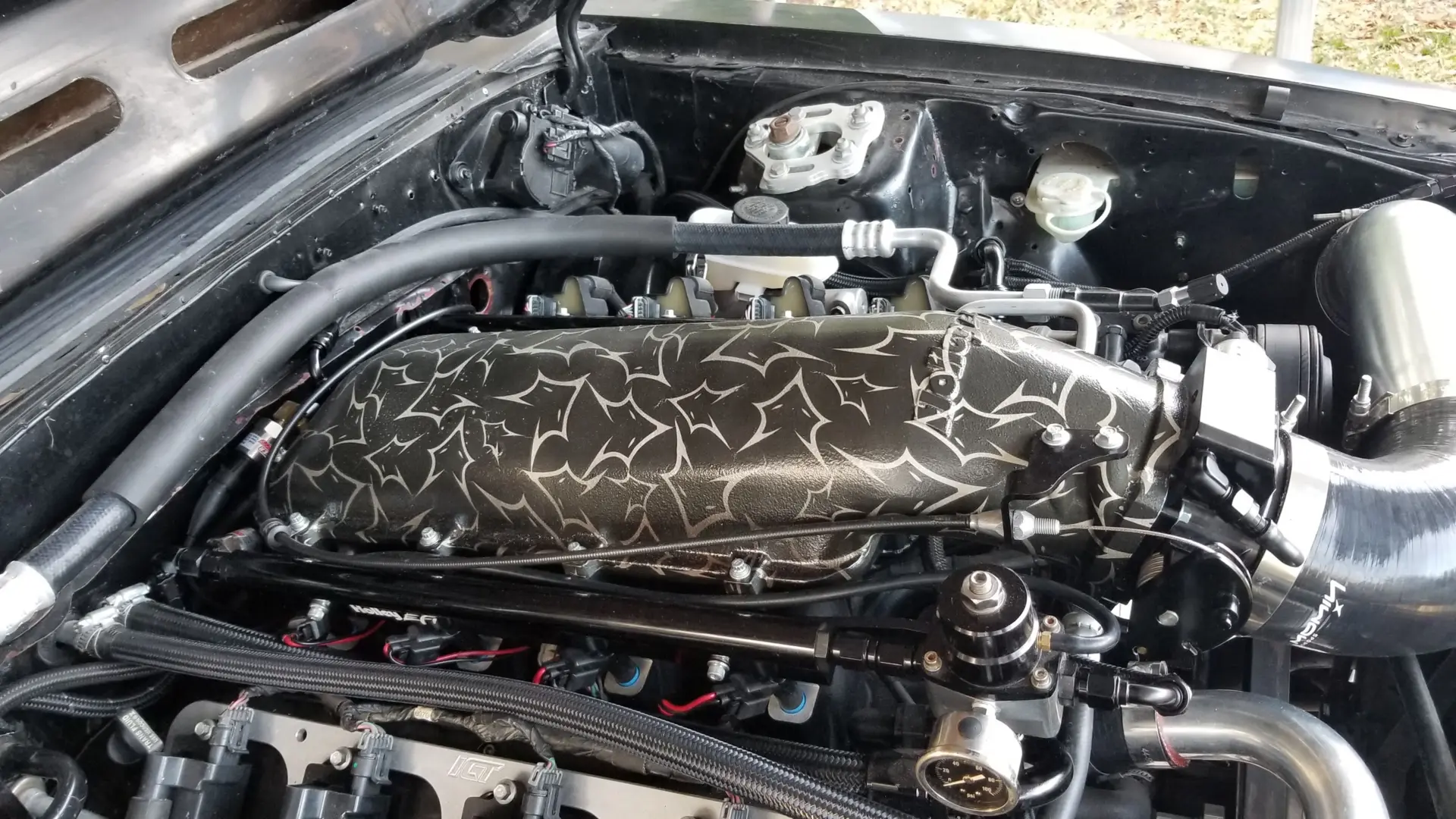

For those that look for updates..
- all oil lines are complete
- EBC is wired and plumbed in to both turbos
- Scavenger pump was tied into the fuel pump relay so its on when engine is running
- Fan control industrial SS relay was changed out for a dorman 902-310
- Transmission TCU was swapped out, I removed the microsquirt and am now using a MSGPIO board built as a TCU.. more robust option is all
The car should be ready to start and do leak tests...
now I have to begin the journey of cleaning the carpet and getting the entire interior reinstalled.

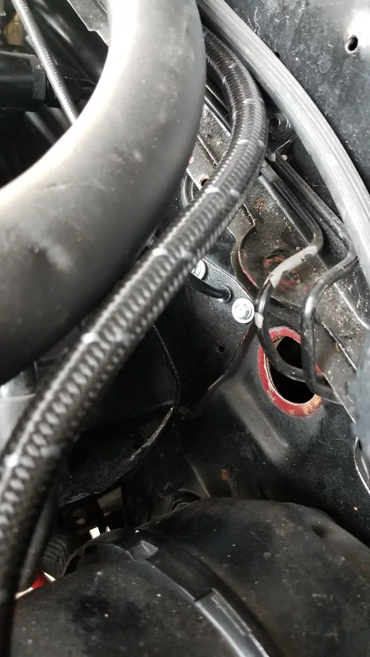

So... today Rich and JR came over for cars and coffee... mostly did alot of BS'ing but with the world being shut down it was a really nice change of pace.
So this actually turned out beautifully, we went to install the Lokar throttle cable and quickly realized that we were not going to be able to get the Jamb nut on the inside of the firewall.. So we took a step back and assessed what we had, turns out all we needed to do was cannibalize some of the parts from the stock throttle cable. So we cut the end off the stock unit and pulled it apart, the plastic clip went on the cable to hold it onto the pedal assembly first then I carefully cut around the crimped end that bolts to the firewall until I was able to pull it off the factory cable sheathing.
Then we took a small step bit and used it to make a beveled shoulder to accept the cable, a little pb blaster and it slid together nicely and looks pretty stock.

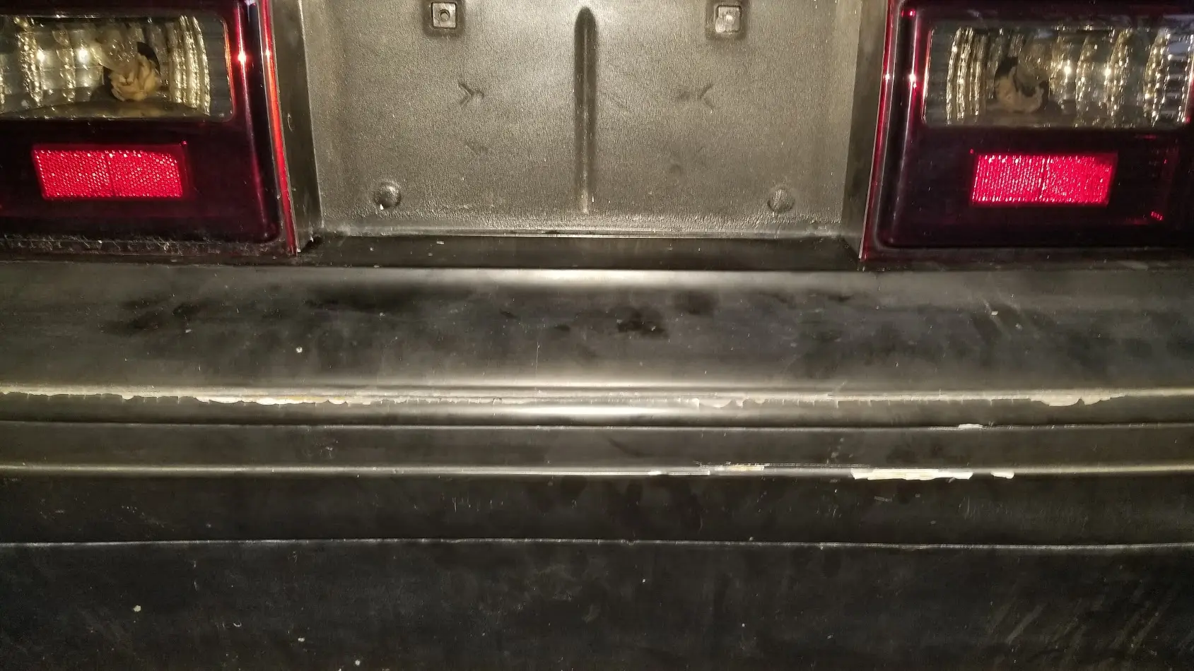

I got the bumper installed today, overall it went well but I did have to fight it a bit. The most important part is to make sure the foam does not slide all the way up against the body of the car, if it does then you cannot get the screws into the bumper from the trunk.
No more sag. overall I call it a win
