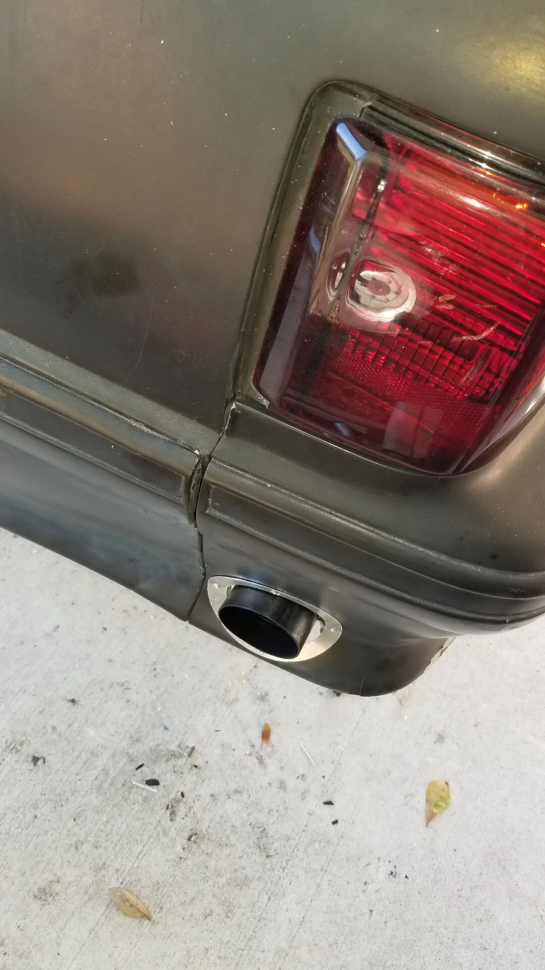

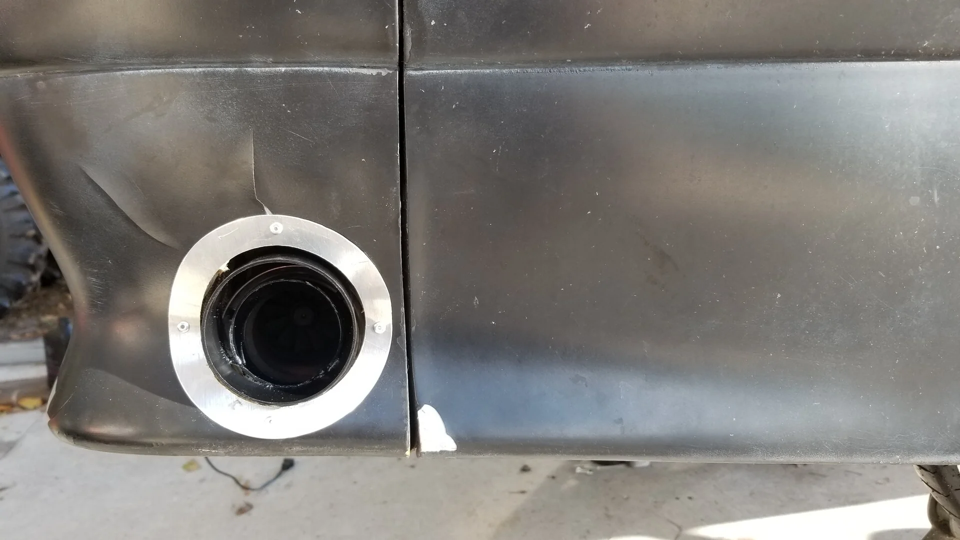

Getting close to needing insurance.. did an online Hagarty quote 10k claimed value with unlimited miles [I can even drive it to work]... came back with 580 a year. That's not bad I think?
got the oil pan done and even managed to get the exhaust tips done.. I will get some pics tomorrow, I ended up having to do the brakes on the Mini Cooper again today [I hate that car] oil change on the S2000 and dug up the portion of the culvert that decided to fail. I am whooped

Paint has seen better days but I am not concerned with it.
Got the trans filled correctly this morning, I do not seem to be getting a signal from the vss... the way I have the circuit configured it may be as simple as swapping the wires on it. We will see.

That exhaust is going to mess with a lot of people's minds.
a91what
SendMeUrDataLog
Apr 6, 2011
10,733
6,716
214
Hillsborough county
Jan 18, 2021
#4,398
  • Jan 18, 2021
  • #4,398
Lets hope so..
