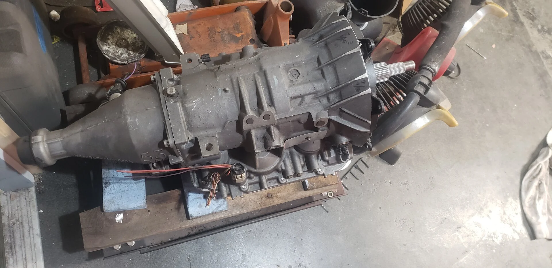

I was never able to get any speedo input from the internal sender on my 4r. I used some sort of sender that plugged in in place of the factory cable head. You are welcome to that if you need it.
The internal sender on the 4l didn't work either, so I just got a GPS based speedo sender that emits a 8000 pulse count to my speedo, which works OK.( but not good enough for what you are trying to do)
I know you need the speedo signal to shift your trans,..when/if you bail on that, I also have the solution to that headache sitting on a rolly cart..You'd just have to pay truck freight to get it.
That's the fully built manually shifted 4r ain't it.... yeah i may need that
