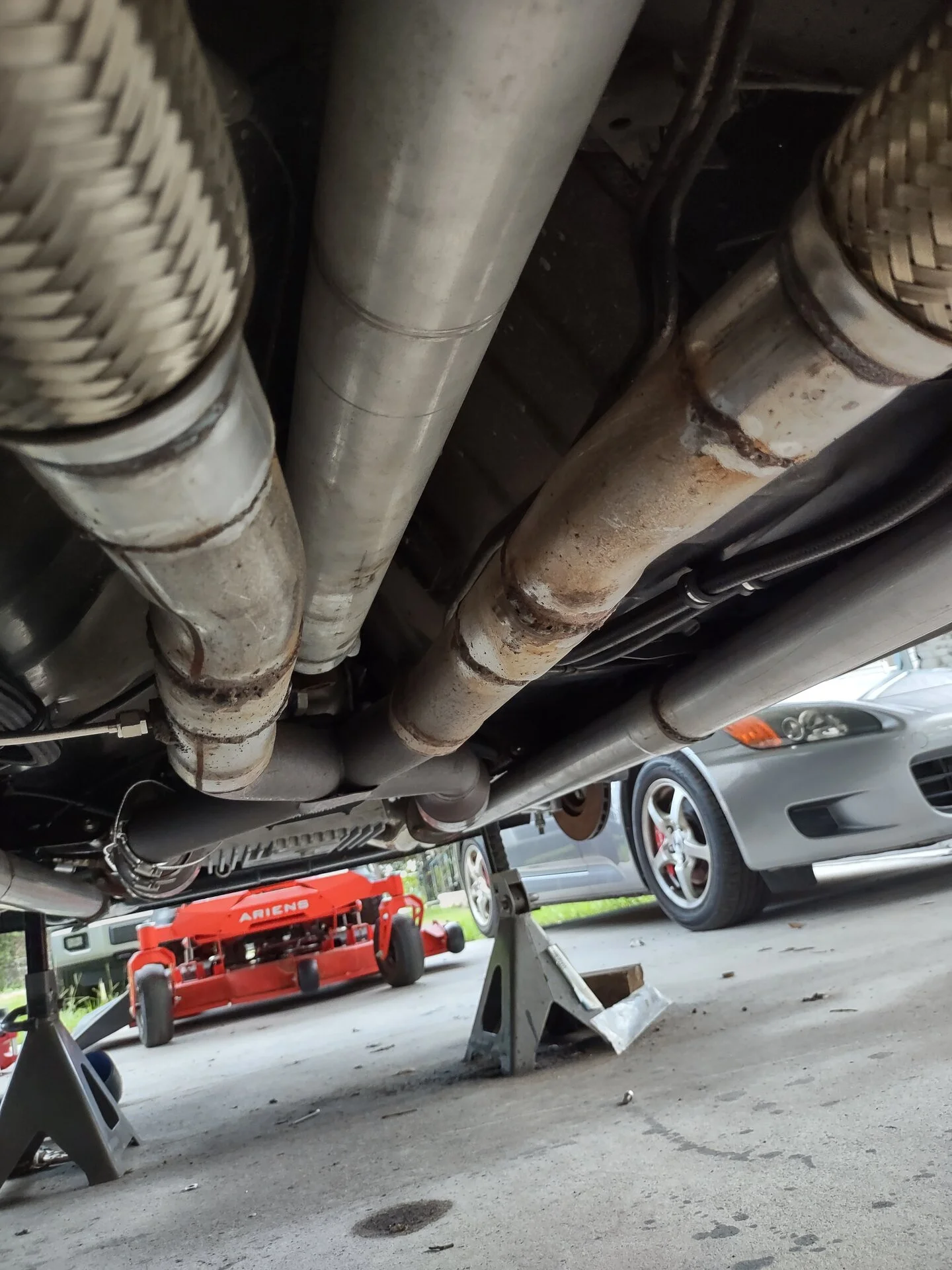

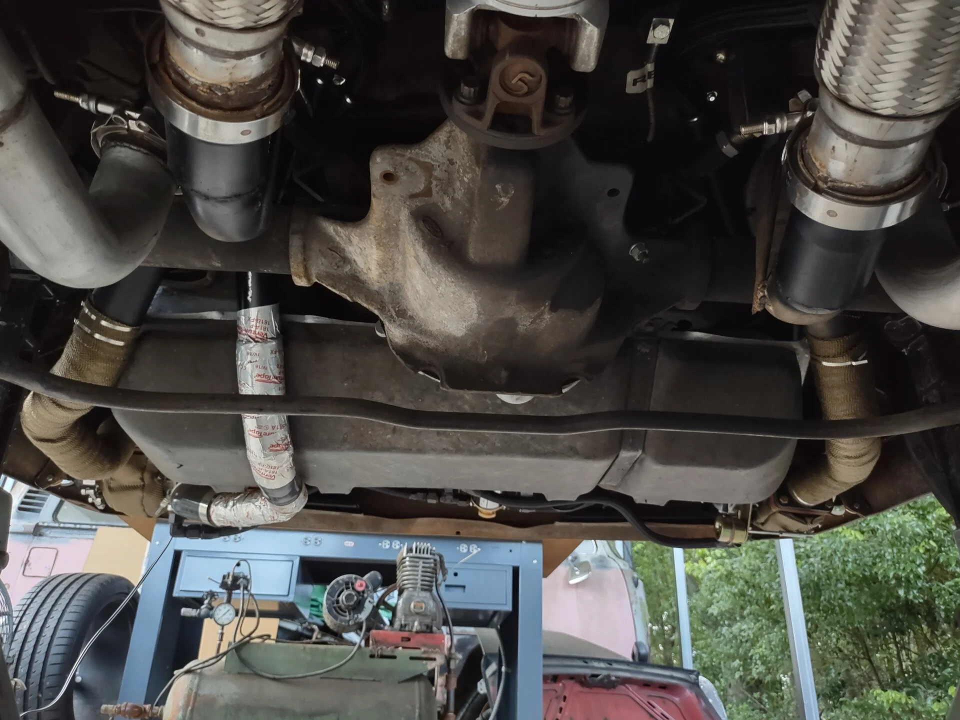

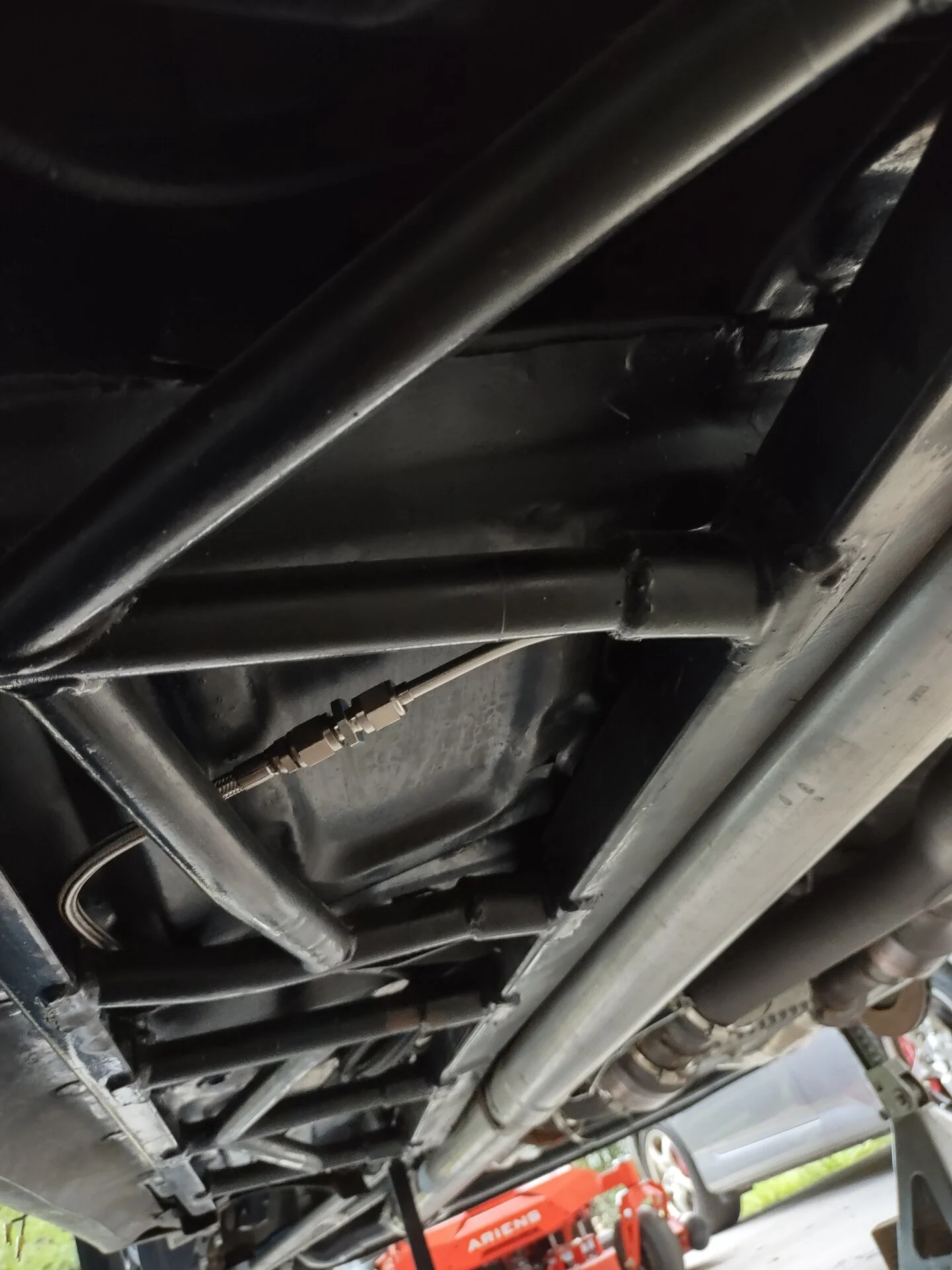

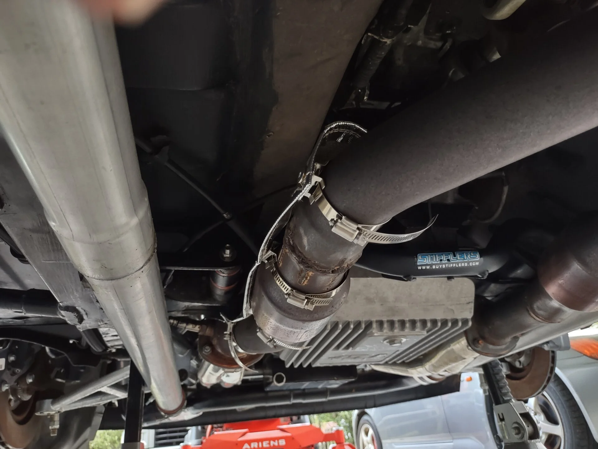

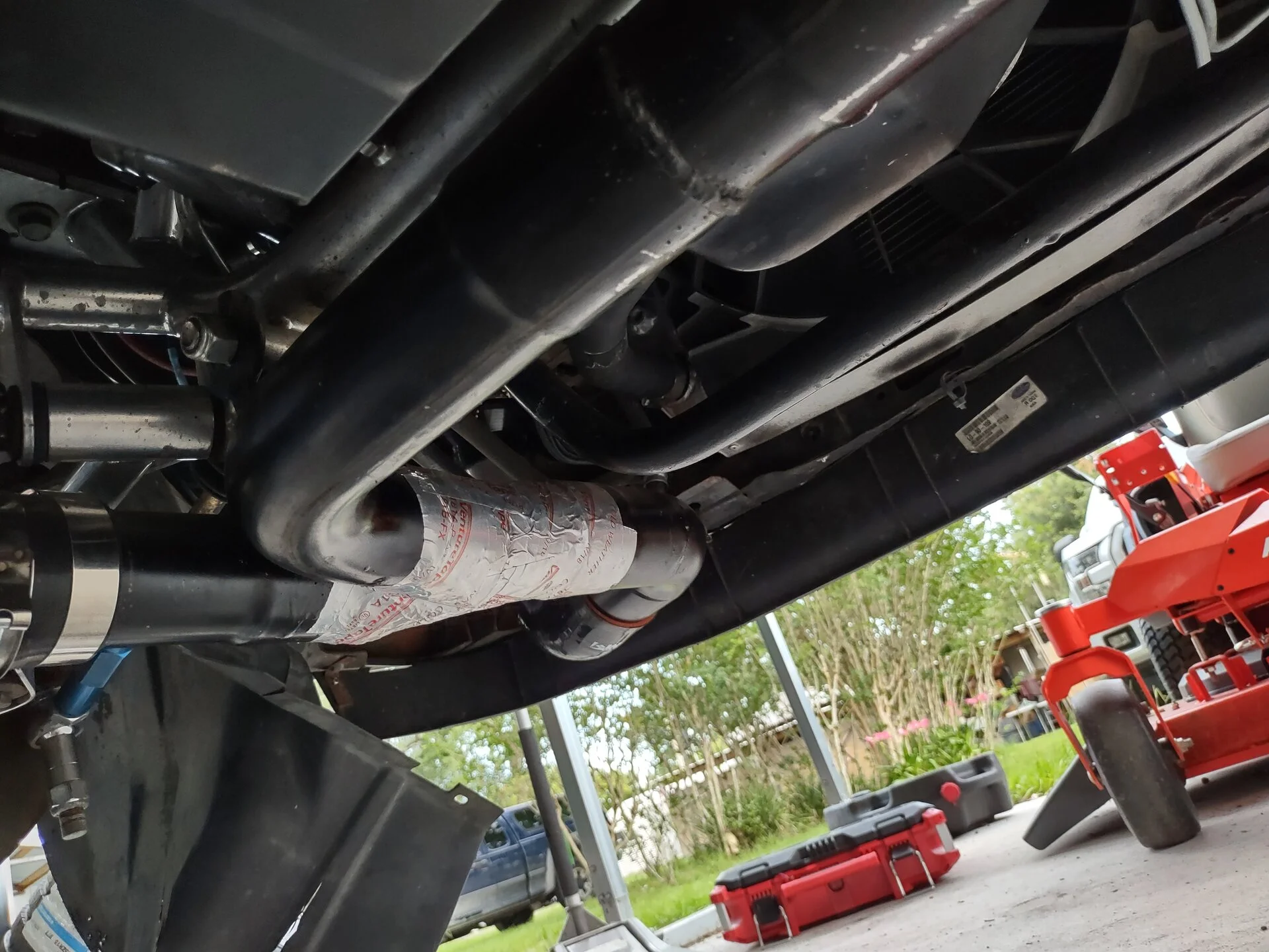

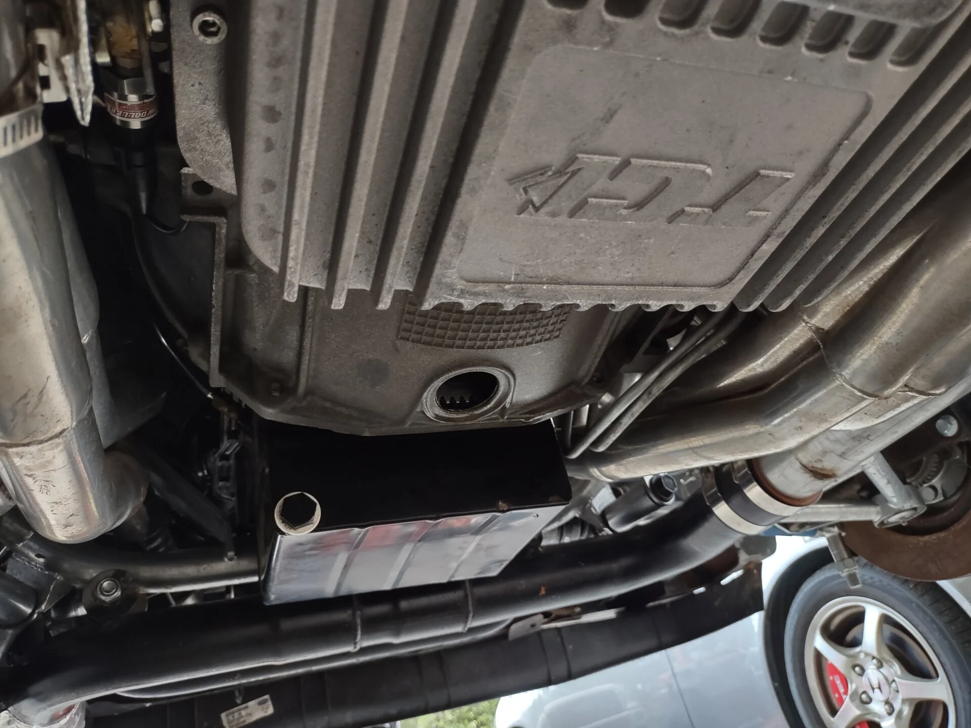

I have been promising pictures, I have some.
I have to redo the turn up on the cold-side piping, it is supported by washers welded to the piping and slid behind the bolts for the rack.
The headers are tight to the body and transmission but tuck nicely, everything sealed up great with the copper rtv treatment on the headers. You can see the tight clearance between the header and cold-side piping.
despite the look of it the welds don't leak on the exhaust. The tube coming off the piping on the driver side is for an exhaust back pressure sensor, I want to monitor the back pressure as it does affect the afr the wideband reports.
I put a heat shield on the driver side to protect the shift linkage and cable.
My nightmare.... One cold-side pipe run as tight as possible to the fuel tank the other runs over the tank. No intercooler,the long cold-side run cools the charge down.
More pics in another post.

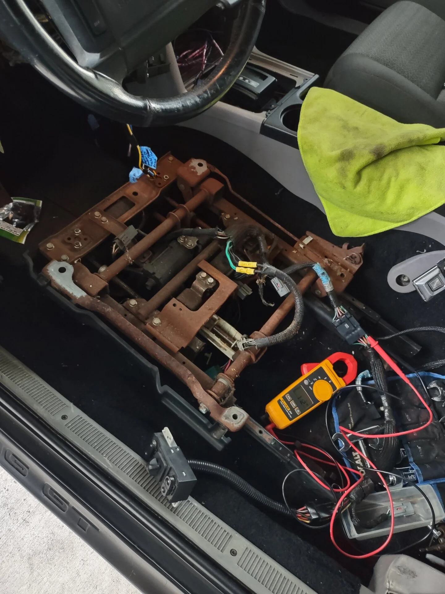

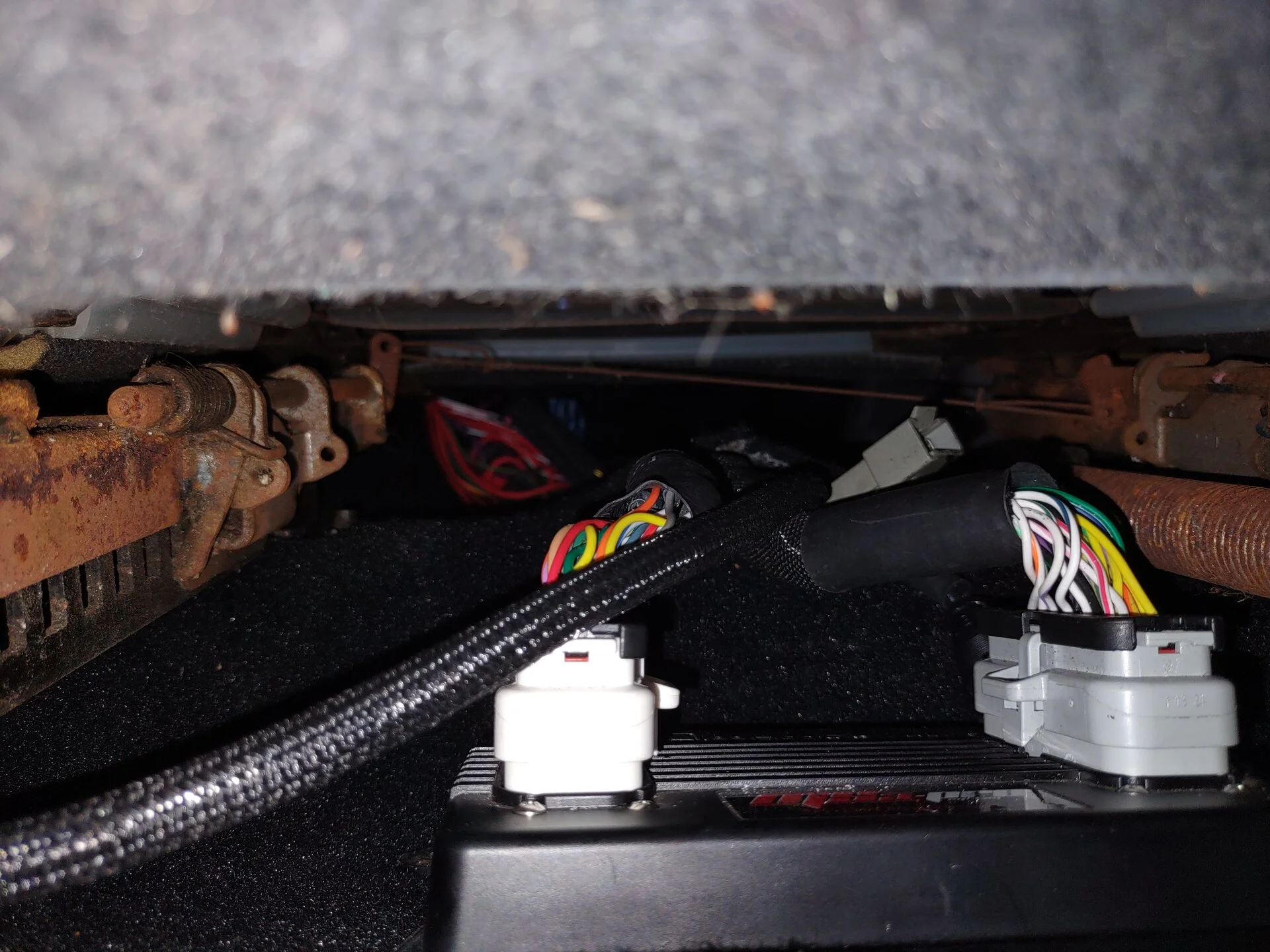

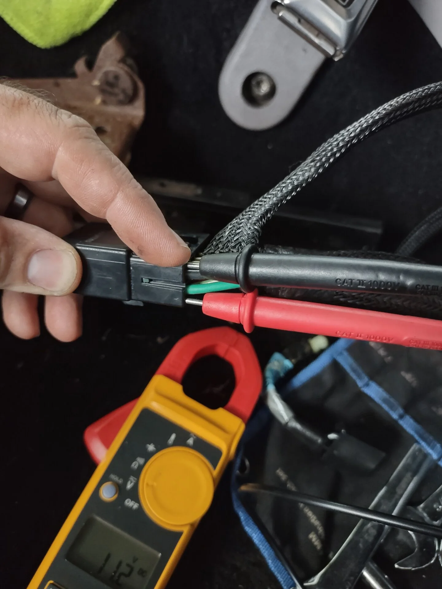

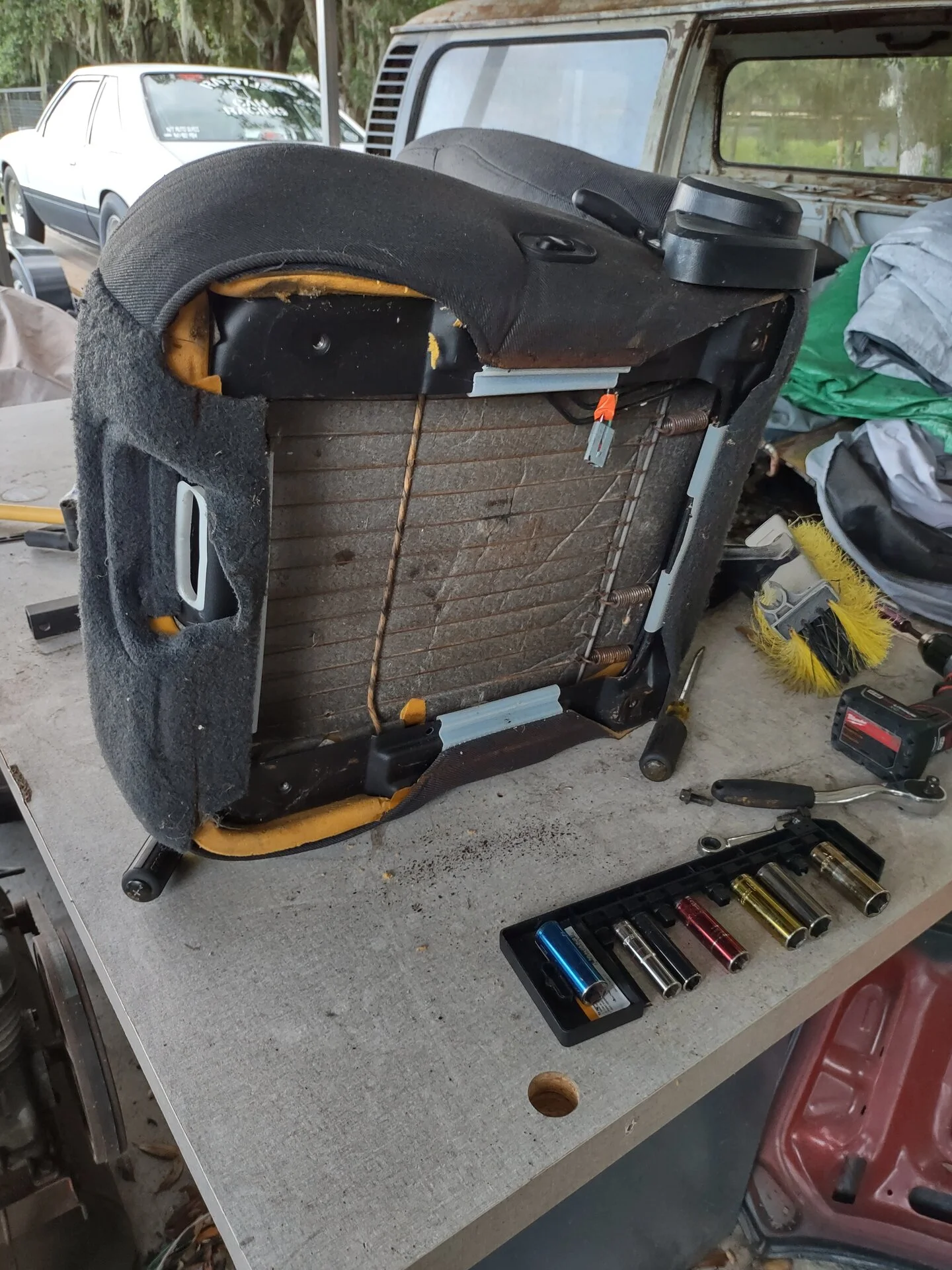

Here is where the sensor tube becomes a line.. a bit further down I put the sensor in a rubber lined clamp. This will get to the ecu through the expansion on the dash.
This took a bit to troubleshoot as it was a loose connection in the harness. I pulled the seat track off and worked on it in the car.
Doing some voltage testing. Didn't take to long to find the culprit once I ruled out the switch.
The ground wire had a loose pin, tighten the pin up some and we have working seats again.
I was concerned about this for a long time, it was unnecessary... The ms3pro tucked easily under the seat.
