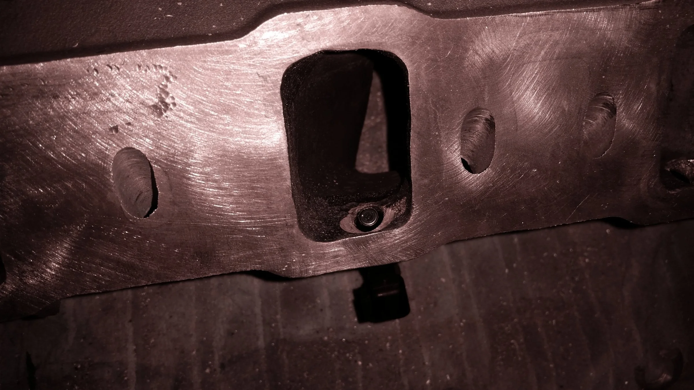

@Boosted92LX yes probably some aluminum square stock tapped into the intake then fuel rails to the stock.... needs spacers to get the injector angle correct.
@madmike1157 nope.... I just ground off the mountain of extra aluminum in the casting... I actually cut the pads down about .5-.75 inches.....

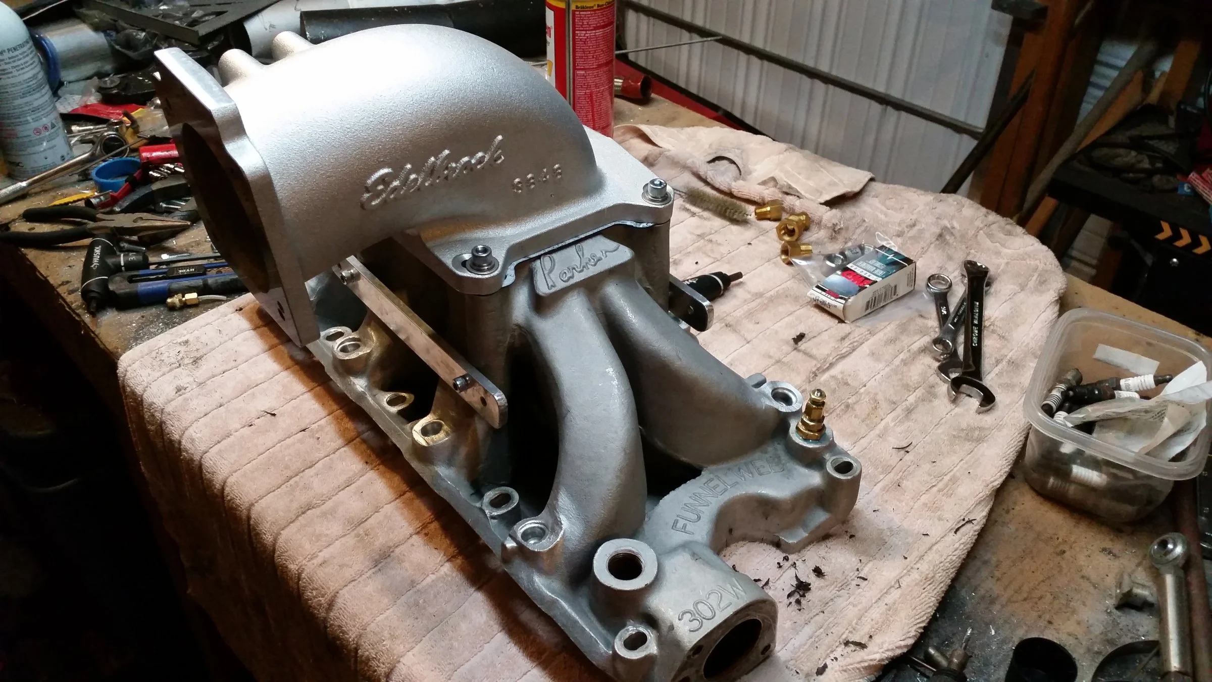

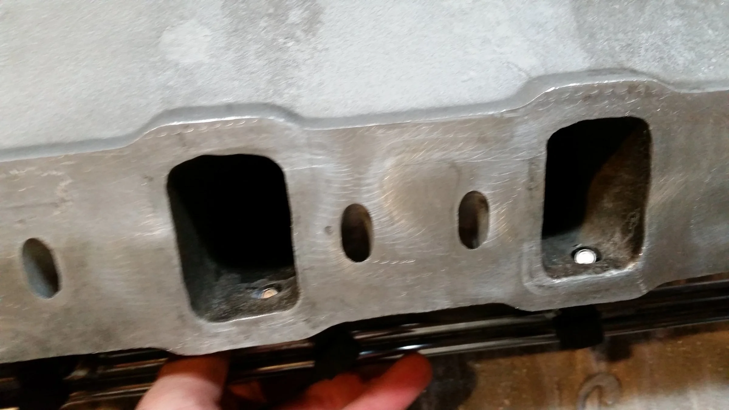

Update!
shrouded.....
unshrouded.....
Now I need to get an elbow...... make one or buy one? Hhmmmmm.......
The Franky in me says make one it would suit the build..... but buying one is ssoooooo much easier.....
Opinions?
I also picked up the aluminum stock to mount the injector rails with.... tomorrow.

Make it

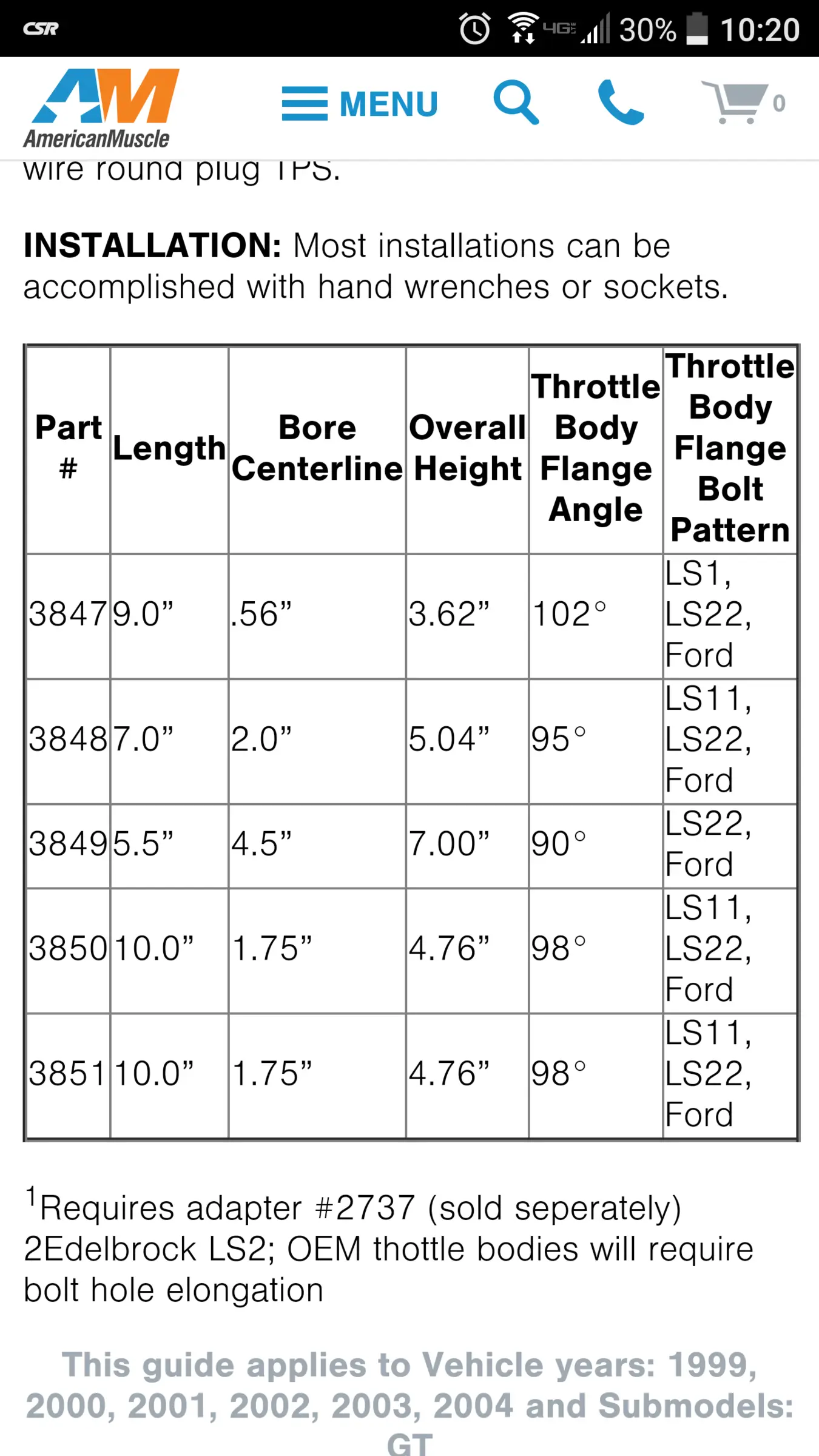

OK guys I need help picking out a throttle body elbow for this funnel web... the budget is 200$ needs to be low-ish profile but still flow well. Provisions for vacuum and MAT would be nice but not necessarily a deal breaker.

https://lmr.com/item/EDL-3847/edelb...OP0aWIZCFGO6GuGoaBZsMBNSHJjaHd-XicaAtzA8P8HAQ

https://m.summitracing.com/parts/ed...-_-edelbrock&gclid=COmOk6r5ss0CFUo2gQodxdoB2w
Says its low profile- @stykthyn link looks lower profile lol

https://www.summitracing.com/parts/edl-3851/overview/
what do you think the difference in flow is between this and the low profile????
NVM says up to 400hp.... that kinda defeats the purpose I think.
Found this. I would be curious to see what the difference in bend angle would do to velocity.
Reactions: a91what and RaggedGT
Think it would have the "bottle neck" effect?

ok just got back from measuring stuff... the high flow 3849 might fit... if I grind my fiberglass hood.. lol around .5" too tall at the TB flange. if I face it tward the firewall it will fit perfect... but who am I kidding I don't need 1400 cfm.
so it looks like the edelbrock 3848 will fit with room to spare, and wont be a bottleneck.
then I will need to modify it, drilled for vacuum ports.

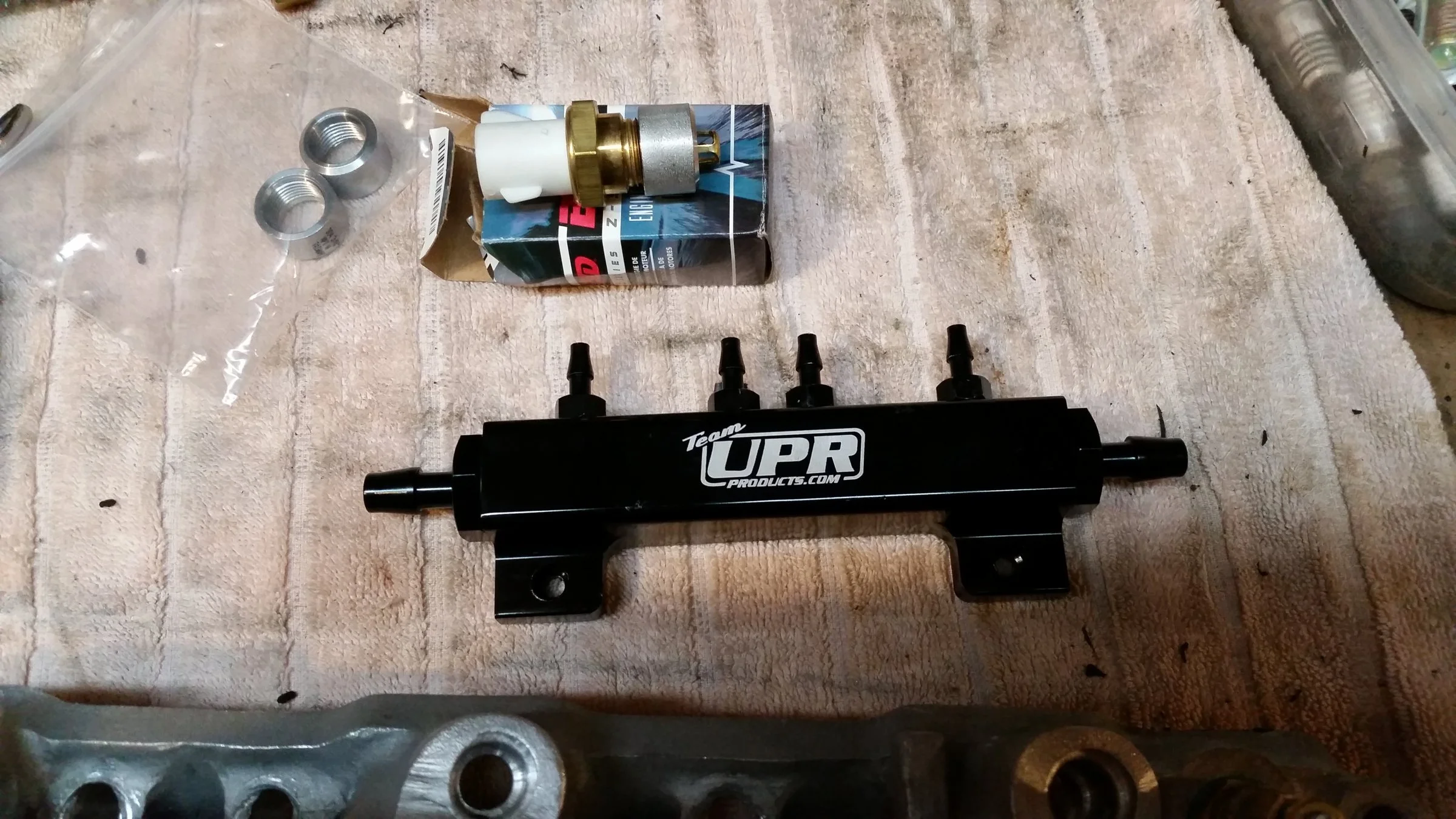

In other news, I ordered a UPR vacuum block and some heavy welding cable. Gonna fix the electrical issues the right way, with non chine cable.

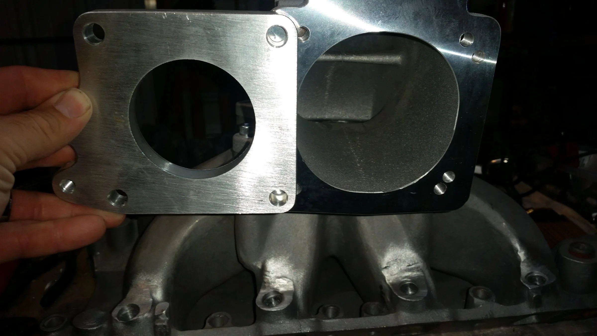

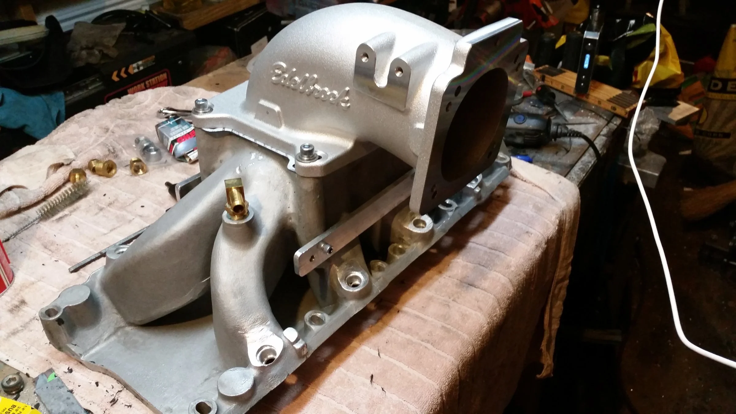

Got some ish done tonight. Sorry about the wait, my wife fractured her ankle, not cool. Needless to say she is top priority right now.
But tonight I got a reprieve here is what I got done.
you can see in this last pic that my 65mm tb is tiny compared to the 90mm elbow! Maybe..... soon I can sneak in a purchase for an 80+mm tb for the blower and move the 75mm to the intake. All the piping is 3" so I don't see a need for anything larger than a 75 at the intake itself.

Oh and the IAT sensor will be going in the intake piping before the tb. I knew I ordered these bugs wrong 2 years ago for a reason.... lol.
any reason I can't feed all the vacuum loads with one block? (Including the brake booster)??
Vacuum is the same anyplace in the manifold after the TB, A vacuum tree or log is that the stock system uses, so you should be OK. The only thing I would not share a vacuum source with is the fuel pressure regulator. Even the stock vacuum plumbing has a separate vacuum source for the fuel pressure regulator
