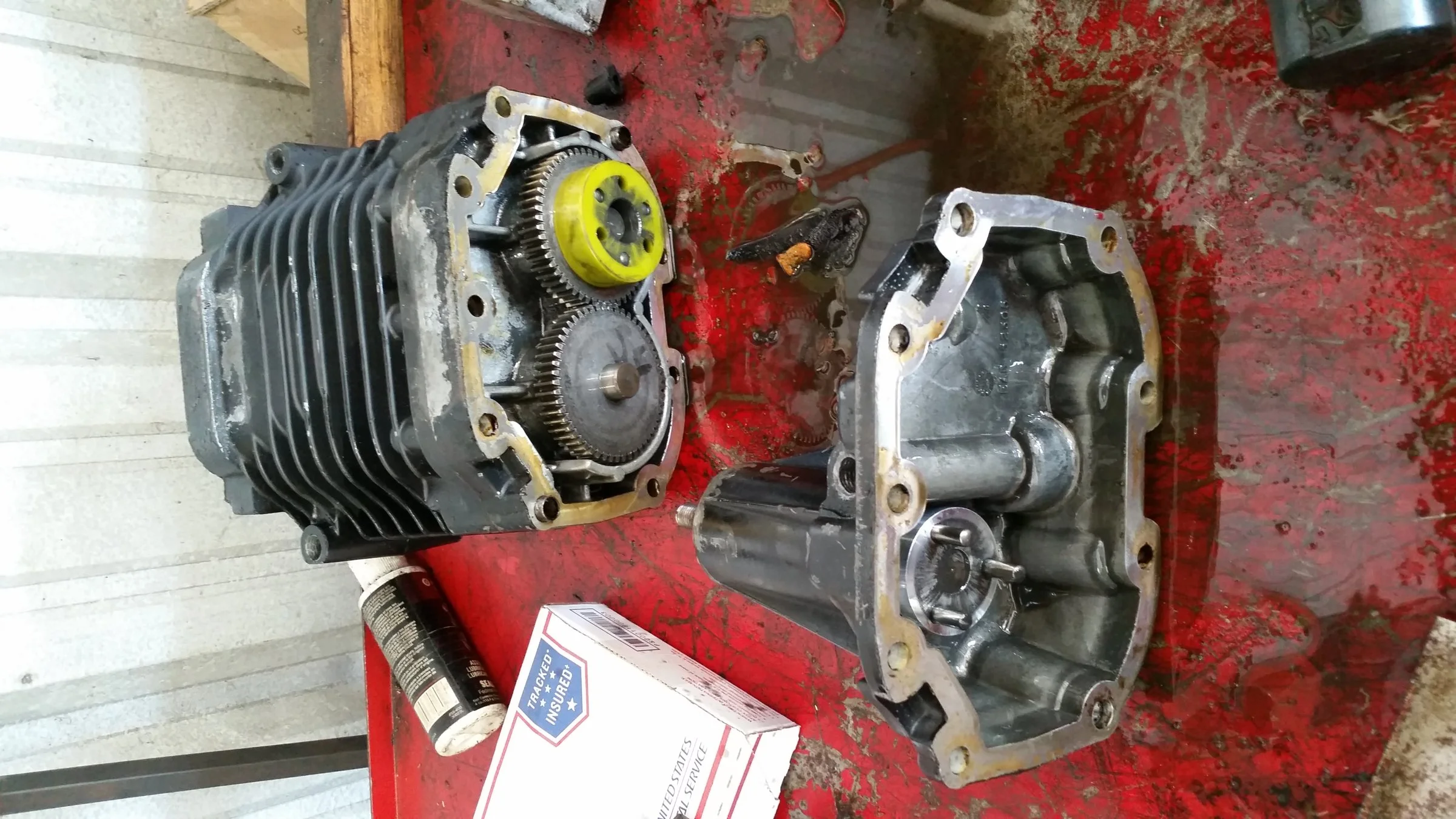

So today I crawled under the car and remove the transmission. Low and behold the throwout bearing was in a million pieces and the retainer was scarred. So I pulled the retainer off the transmission and the supercharger out of the engine Bay and headed into town. The transmission shop had all the tools I needed to rebuild the supercharger and they went ahead and ordered me a new retainer this one's got a steel shaft so this won't happen again.
this is the only picture I got of the rebuild, my hands were slimy so I refrained from reaching into my pockets for the phone. It wasn't as hard as some people make it out to be a few YouTube videos later I was done. On my way home I picked up a new transmission mount and some new exhaust hangers and couplers I had to cut the exhaust out from underneath the car so while I'm in there I may as well try to fix it. The next time it happens to come off I will be upgrading

Got the car back together on Friday so I decided to drive it to work on Saturday with new parts the clutch engagement is nice and smooth it even shift better. Supercharger doesn't leak anymore which is really nice because adding fluid to it is impossible without pulling it out. I drove the car all the way out to a friend's house after work and on my way home I got caught in a rainstorm that's when I realized that I have overlooked some very serious Parts on this car. When you're driving down the road and it's raining water constantly drips into the driver's window and on to your leg which during a half hour drive means you're incredibly frustrated by the time you get home. Car has no AC so I turned on the vent and realize that none of my AC controls in the dash work that was strike 2. I found a break in the storm so I roll the windows down to air out the car when it started raining again I roll the windows back up the passenger side window rolled up fine the driver side window got caught half a dozen times and I had to stop and open the door to get it to roll up all the way. On top of that when you're moving slow through traffic all kinds of exhaust fumes and wonderful crankcase evaporation smells come into the car that was strike three. Now I knew from the get-go that convertibles inherently leak but the leak should not be this bad so if anyone has any information on how to adjust these stupid doors and windows I am all ears because for the life of me after fiddling with that I cannot figure it out there's half a million adjustments for the doors and windows
