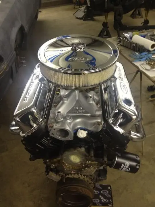

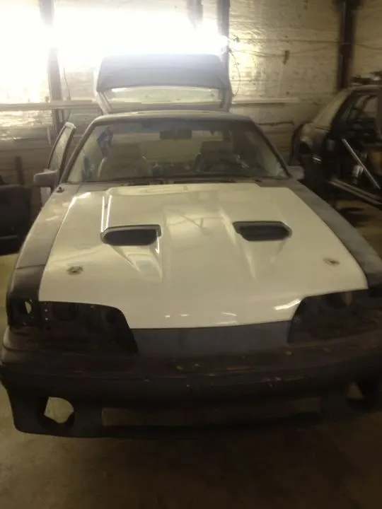

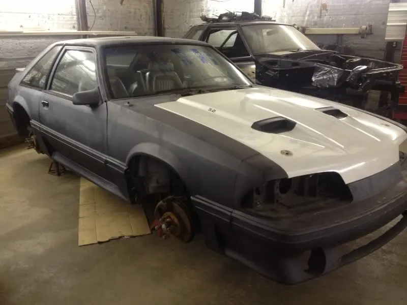

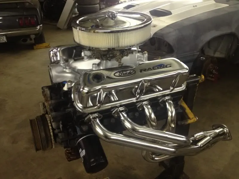

Here are some pics of the engine and car. I picked corvette atomic orange for the color. I also ordered new smoked one piece headlights, smoked fog lights and smoked tail lights. I bought a new front bumper because the one on their was a little messed up. Also got a chrome oil pan.
Thanks. Not sure what u mean about removing them and not having them line up again. I am very new and still learning about the mechanics of cars. Only knowledge I have is from these forums and other Internet research so sorry if some of my questions sound dumb.
I've done some research and also my mechanic told me this combo of Mac long tubes and Mac off road h pipe is pretty good. What u guys think?
just be sure to use good exhaust manifold gaskets or they will be coming off. since they have separate flanges for each exhaust runner they are easy to install but due to the individual flanges and how metal works they will "flex" over time and prove difficult to reinstall after a few thousand miles. however they are great for what they are and many thousands of people have used them.
