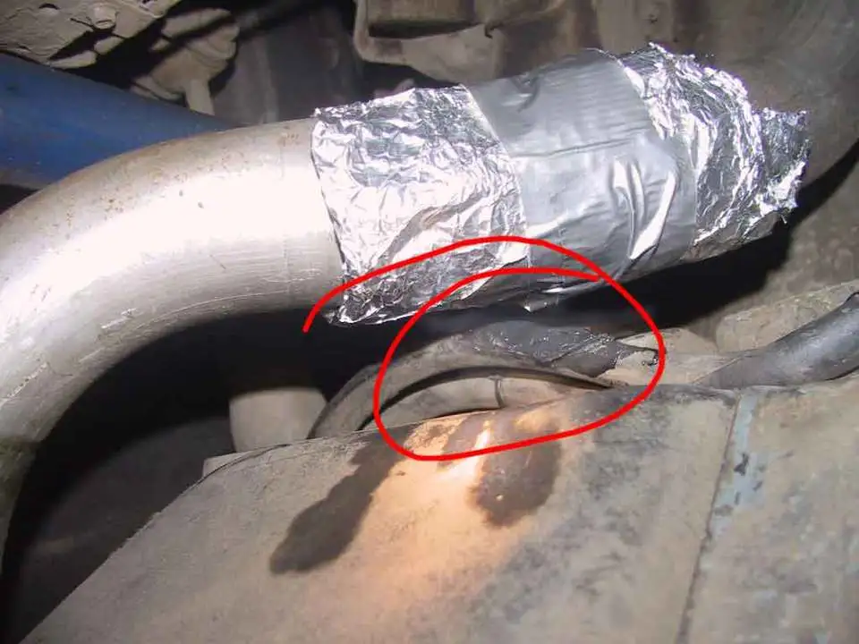

I found a fuel leak in my 88 GT, it was dumping raw fuel on the exaust pipes, so I decided I needed to fix it pretty quickly ;) so I found out that the previous owner installed the Exaust system too close to the rubber fuel lines, so the pipe melted my fuel line.. So anyhow, I patched the line, and let the car idle for a few minutes, but I need some type of heat shield to keep it from re-melting the line... I think I've seen some type of matieral wrap for pipes that is a heat shield... I saw it used for Headers before, i forget where... Any suggestions?
here's a pic of how it looks- the aluminum foil shields it a little, but not enough. The patched fuel line is circled.

Best I can tell, what im looking at is where the tails go over the rearend. If it was my car the only way to fix it would be to get a sawzall and cut those tailpipes off. You can drive it without them until you can buy the right ones. Or just go ahead and buy the right ones and take it to a muffler shop. Thats dangerous, I'd get a new fuel line and cut those tails off. Soon
best time to put in the $$$ for some SS fuel lines......................no need to worry about exhaust anymore and it is gonna be cheaper then cutting the tails off since they are to close and it will happen again.....................
Man...be careful driving that thing with a patched fuel line. I had a buddy several years ago who had the same problem. Paid $300 to have a custom cat-back exhaust "professionally" installed on his 1993 Teal Cobra with 6K miles. Long story short, the "professionally installed custom exhuast" ended up touching a small portion of the fuel delivery line and burnt a hole right through it. My buddy figured he would temporarily fix the fuel leak by making a clean cut through the damaged fuel line (including the plastic inner tubing) and joining the two ends with a brass barb and a couple of worm drive clamps. He had no idea that the fuel line was under HIGH PRESSURE. You guessed it, a few days later, while cruising down the highway, the hose blew off dumping raw fuel on his hot exhaust which ignited almost immediatly. He was able to get the car pulled into the breakdown lane, but not before extensive fire damage was done to the undercarrige, RR tire & rim, and passanger 1/4 pannel. Lucky for him someone carrying a fire extinguisher stopped to help, otherwise he may not have been so lucky.
Moral of the story: 1. Always carry a fire extinguisher, 2.replace the damaged fuel line hose. Takes 2 seconds (2 clips), but it could save you a boat load of headaches.
