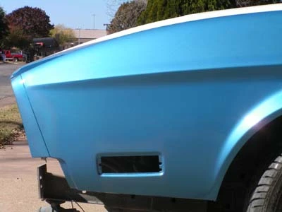

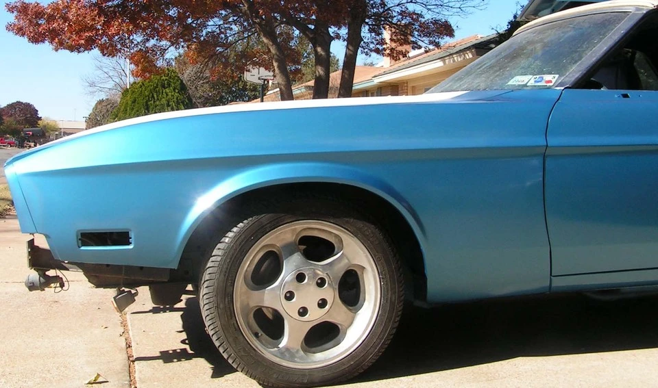

I think I've decided to simply live with my screwups. I really don't want to risk making the problem worse by trying to fix them. You can really see the main problem area real well in these pictures.
Is that a good or bad decision? :shrug:

Ahh I got worse problems now I think. It looks like the clear/base didn't cure or harden correctly. The paint seems a bit too easy to chip, but maybe not everywhere. I've got a few chips on the front fender where I think my roommate bumped it with a wrench or something.
So, I tried to chip a spot on the trunk with a star bit screwdriver. It chipped under light blows, a little more than a tap, but I didn't swing back on it.
I tried a spot down low under the fender, where the trunk floor meets the fender apron thing. I hit it with the same amount of force, but it only resulted in a scratch. Hey, I hit it a little harder and it chipped, but not as much as the trunk, so I don't know what to think.
Can I just lay under it and someone push the car over me a few times? I'd feel a lot better I think. Sucks when you work really hard on something and it turns out like crap anyway. Maybe once the sun comes back I can get it out in the heat and it will finish hardening, but it's been like three months so if it ain't hard now I don't think it's gonna get hard. Do they make Viagra for car finishes?
So, I tried to chip a spot on the trunk with a star bit screwdriver. It chipped under light blows, a little more than a tap, but I didn't swing back on it.......
I tried a spot down low under the fender....
... I hit it with the same amount of force.....
..... Hey, I hit it a little harder and it chipped, but not as much as the trunk, so I don't know what to think.
Stop doing that!
Don't worry I stopped. I think it might be okay. I tested the finish on our other car and it had about the same chip resistance as that lower spot on my car. Then I tested a spot on my fender where I already will have to do a touch up and it had pretty good chip resistance. Maybe it's alright after all.
We'll find out. I'll let you know. Eventually I'll put together a write up of my painting experience. It'll be filled with what not to do's. :)
