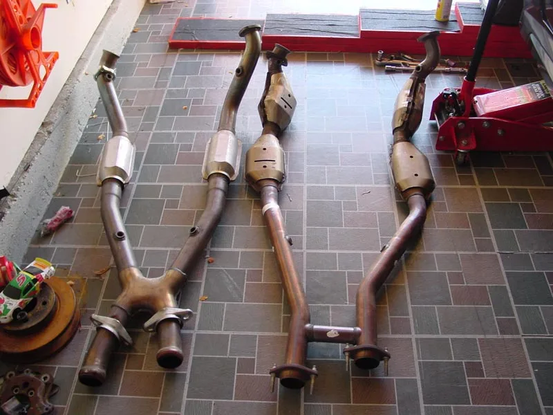

Oh, and here's an image from the article as well. You can clearly see the difference in design between the "X" and the "H:"

Now I'm really going to sound like a dummy asking this, but where do the cats fit into all of this? Stock has 4, right? Do the H and/or X pipes eliminate these? (which I don't want to do, although 2 of them should be ok) Or do these H and/or X pipes having nothing to do with the cats?

No problem, I'll briefly outline everything here:
In the pic above you are looking at an aftermarket Bassani X pipe w/ catalytic converters (2) on the left. On the right, you can see the 4 cats on the factory H pipe (some Mustangs were equipped with 6 cats!).
Aftermarket X & H midpipes come in two flavors:
1) offroad (having "no cats")
or
2) "with cats" (equipped with 2 high-flow cats)
Today's high-flow catalytic converters perform very well (there was an old saying that cats choke performance, not so true with newer technology).
* In very high horsepower applications, there probably are a few ponies that could be realized by switching from a "catted" aftermarket midpipe to an offroad midpipe...but the gains are probably not too significant.
Offroad X or H pipes tend to really wake up the dB (loudness) of an exhaust system. I couldn't justify going to an off-road exhaust because of the increased sound level. The cats on my aftermarket X pipe help keep the sound level in check (mellow at idle & semi-loud at WOT) while still delivering great performance. The best way to decide is to listen to several exhaust combos in person because the topic of exhaust sound is such a subjective issue...g'luck!
