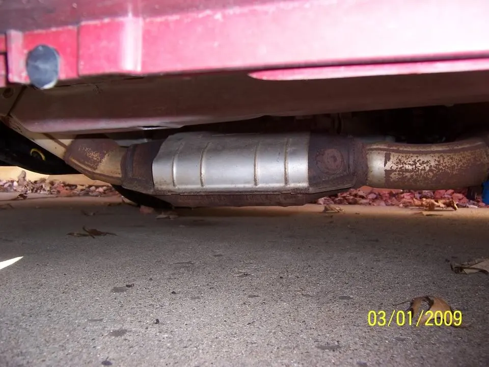

This one shows the drivers side cat. There is no precat in front of it.

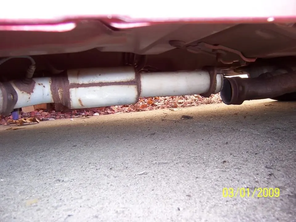

This one shows the H which looks like a prochamber H. Also shows the connection between the mid and catback. Like I said I still have the passenger side manifold left to unhook so its pretty much just hanging there right now.

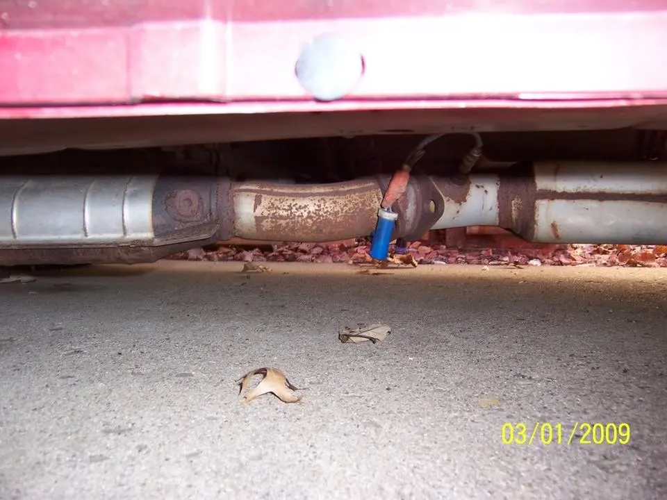

This one shows the cat and H in one pic. The connection can be side by the hanging O2 sensor connector. Again this connection is in the same place as the prochamber 3 pc on the drivers side. The passenger side is solid all the way back to the H.
It does look like you have an older model of the catted prochamber to me. It's too bad you have the older version, since the newer ones you can simply order the catless legs for them. You could always cut those cats off and weld in a stick of 2.5" pipe.
