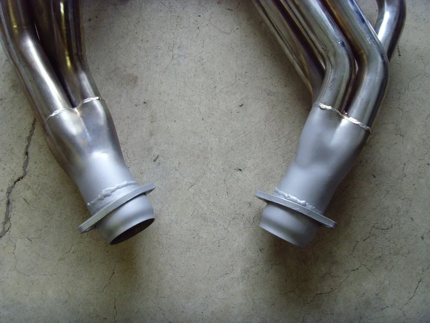

I bought some 3" Pro Dumps and VRS Exhaust 3" X pipes for the BBK headers. The problem is even though the BBK have a 3" collectors it has a 2 1/2" ball joint and the 3" socket joint on the X pipe doesn't match up. I'm think of cutting the ends off of the BBK headers and welding up a 3" ball joint so I can make these work. I been looking around Web for pictures.
If you know where a local big rig truck shop is, you can get s.s. 3" band clamps, simply cut off the ball end of your header and but up the new x pipe, wrap the clamp around them both and tighten, these clamps work great, no welding involved!
Ive used a die grinder to open up the collector to 3" in the past. Just take your time so you dont go to far.
While its to late the Dr Gas is all individual pieces you weld together. Tack and mock up on the car then weld on the bench.
I ended up cutting 1 1/2" off of the BBK collectors and bought some 3" ball flanges from Summit and cutting a 1 3/4" off of them and wellding them up. I forgot what a pain it is to remove these headers. Steering shaft drivers side and jack up the engine for the passenger side.
