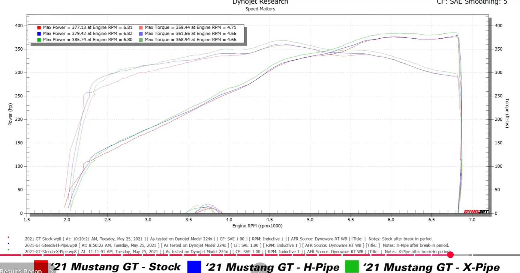

The graph above is a higher HP Coyote but: Take your FHP as a percentage of what is on the graph and multiply it by the improvements seen above and that will give you an idea. So, a 7 peak HP gain in the graph above would mean roughly (all things being equal) a best of 5-6 HP peak gain.

It's not apples to apples but it should give some idea.
