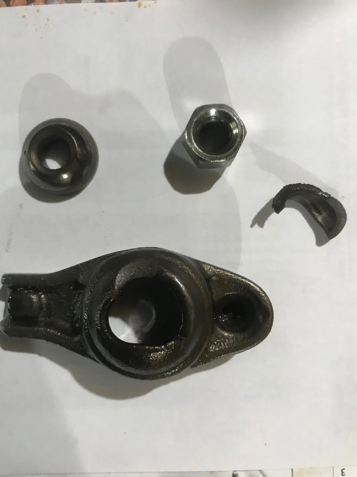

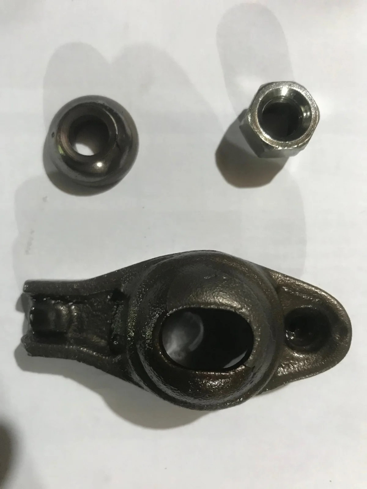

Back from hunting for a little while. Waiting for frost. Got the first load of firewood unloaded and stacked. I put the Cobra II back together this morning and got it running. I'm going to need to move things around in the garage in order to get the engine pulled in the spring so I'll need to keep it going through the winter in order to do so.
I pull the broken rocker (see post #29) off and replaced it. I'm pretty sure it was a casting flaw. Either way it doesn't have to last long.
