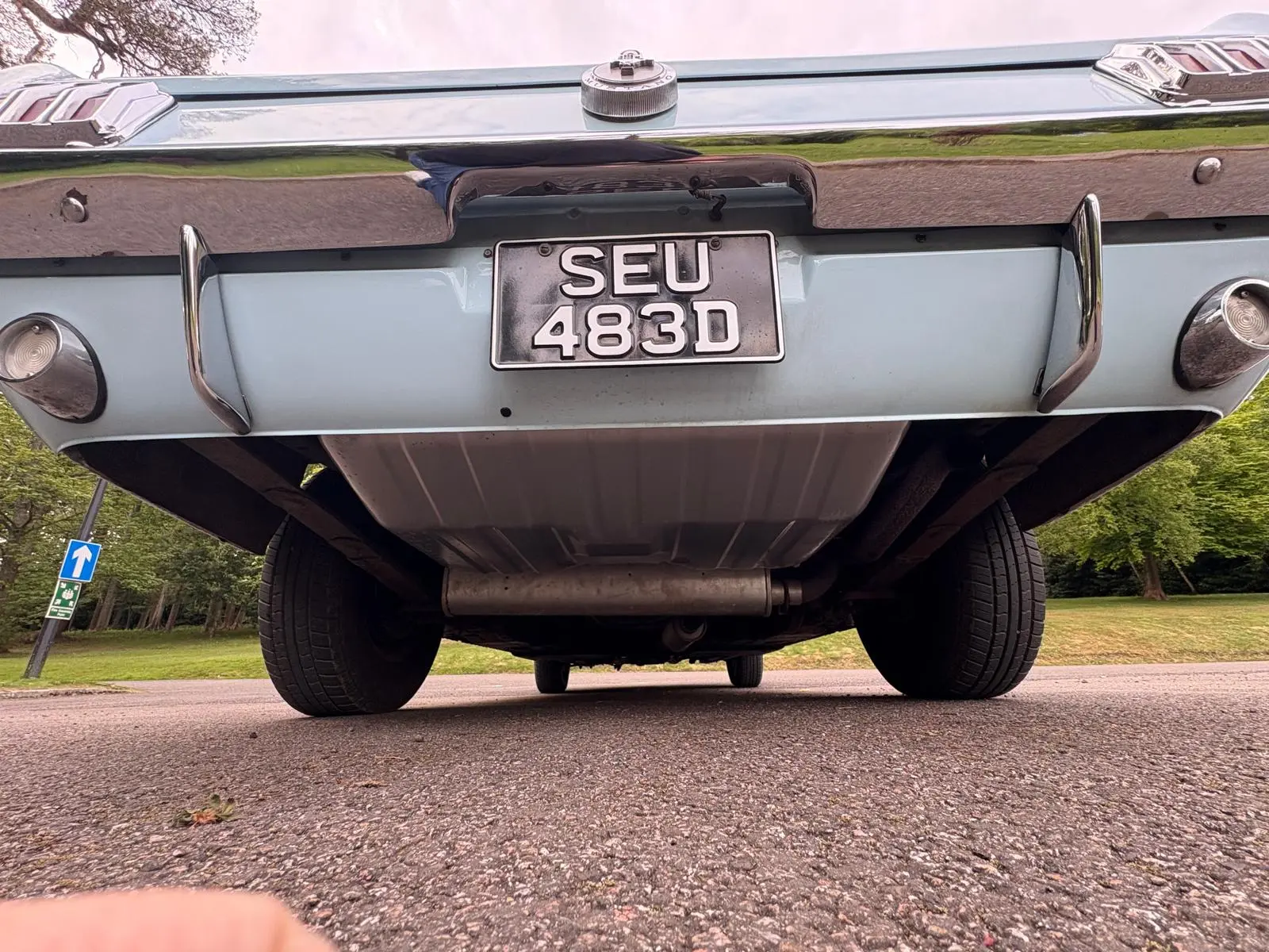

Hi there, I am looking at purchasing this 66. The muffler (pictured along the front side of the gas tank) is surprisingly quiet and definitely all wrong on any Mustang. I had original flowmaster 40s on my Foxbody which were great and no 'drone' issue at higher speed as the auto gearbox had overdrive to quieten things down just enough. So my question is what's the simplest muffler swap to do to get the right balance of sound at idle, when accelerating and when cruising - gearbox is a three speed auto. Thanks

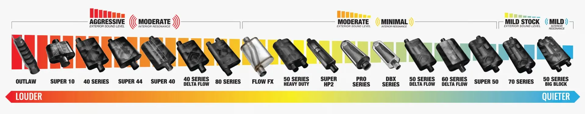

So I guess it all depends on what your individual tastes are, but YouTube can be a good resource to use when shopping for the exhaust you'd like. Another resource is to use Flowmaster's sound chart if you like their sound. Then you'd have some sort of reference to have an idea of how loud vs how quiet a particular offering may be.
