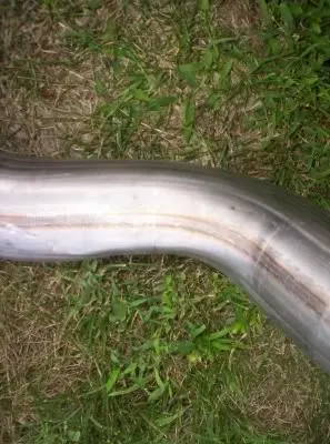

the stock exhaust is mandrel bent, but it does have a slightly flat spot above the rear axle. most people agree that it is not worth the extra money for a complete catback system. there are some that claim the catback is better, but no dynosheets are coming to mind where they proved it. the stock exhaust flows pretty well as it is, so there are not huge gains to be had when replacing the pipes or mufflers. another point that has been brought up about the catback is that some of them eliminate a few bends in the pipe, allowing easier flow.
IMO, stick with axleback.

here is a pic of the said flat spot.
