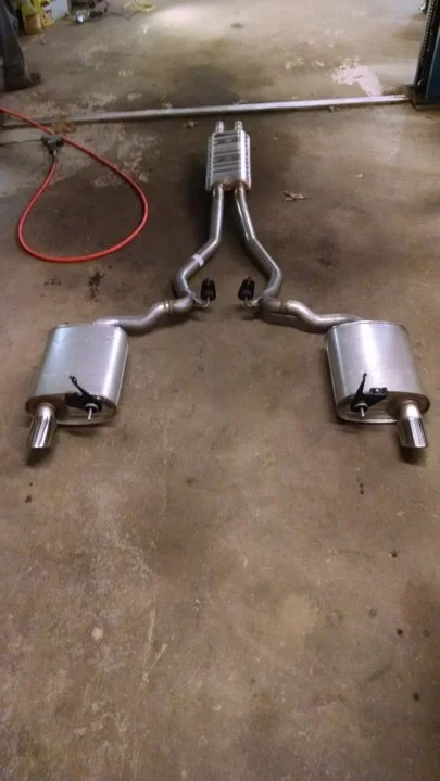

Here is the factory exhaust system as removed in one piece: (note the big bulky resonator. Where the welds are just past the hangers is the location the axle back will have you cut the exhaust system

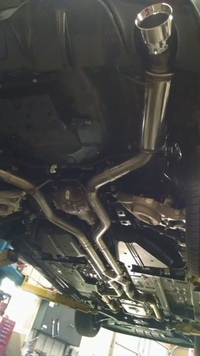

This is the Magnaflow competition cat back system that I installed on my GT:

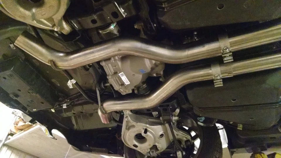

This is where the exhaust runs under the axle:

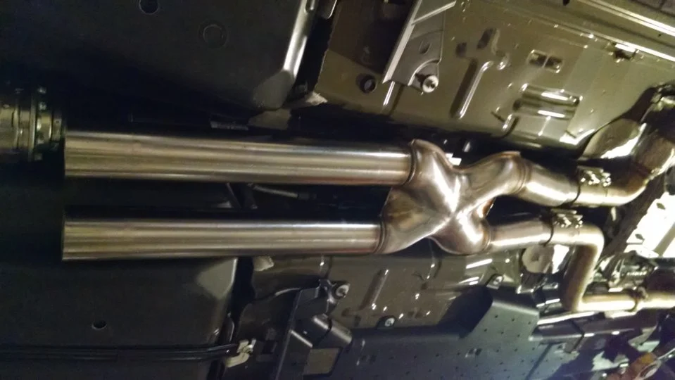

This is a good look at the X pipe and where/how it attached to the factory exhaust:
FWIW, the factory exhaust is 2 1/2" and this Magnaflow setup is 3". I am not sure if the axle back kits increase to 3" or not. I saw an increase of 10 rwhp with just the exhaust system, not to mention a great new sound!
