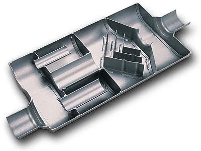

Chambered mufflers are called chambered mufflers because they have chambers inside the muffler to deflect/muffle the noise. Straight-through mufflers (SLP, Magnaflow, etc.) feature an unobstructed straight clear path right through the center of the muffler but the walls are packed with sound-deadening material (that's how they muffle the noise).
The more chambers in a muffler, the more the sound is deflected and muffled. Flowmaster has single, double, and triple chamber mufflers. The single chamber (10 series) sound mean as heal but are unbelievably loud (youtube single chamber flowmaster). Double chamber mufflers (40 series) are more common on muscle cars because they offer the same rumble/growl but t a tolerable noise level. The 3 chambered mufflers are basically truck mufflers.

Cool, I learned something new. Thanks! Yes, these are chambered for sure, I think that's the rattling noise going on inside. So if it's 3 chamber, what series is that? I'll prob just get two replacement mufflers either 10 or 40 series then.
If it's rattling the one of the baffles (metal pieces you see in the diagram) has probably let loose. Like I posted earlier, the original 40 series muffs are what you want. They are two chamber with maximum flow so they are louder/meaner.

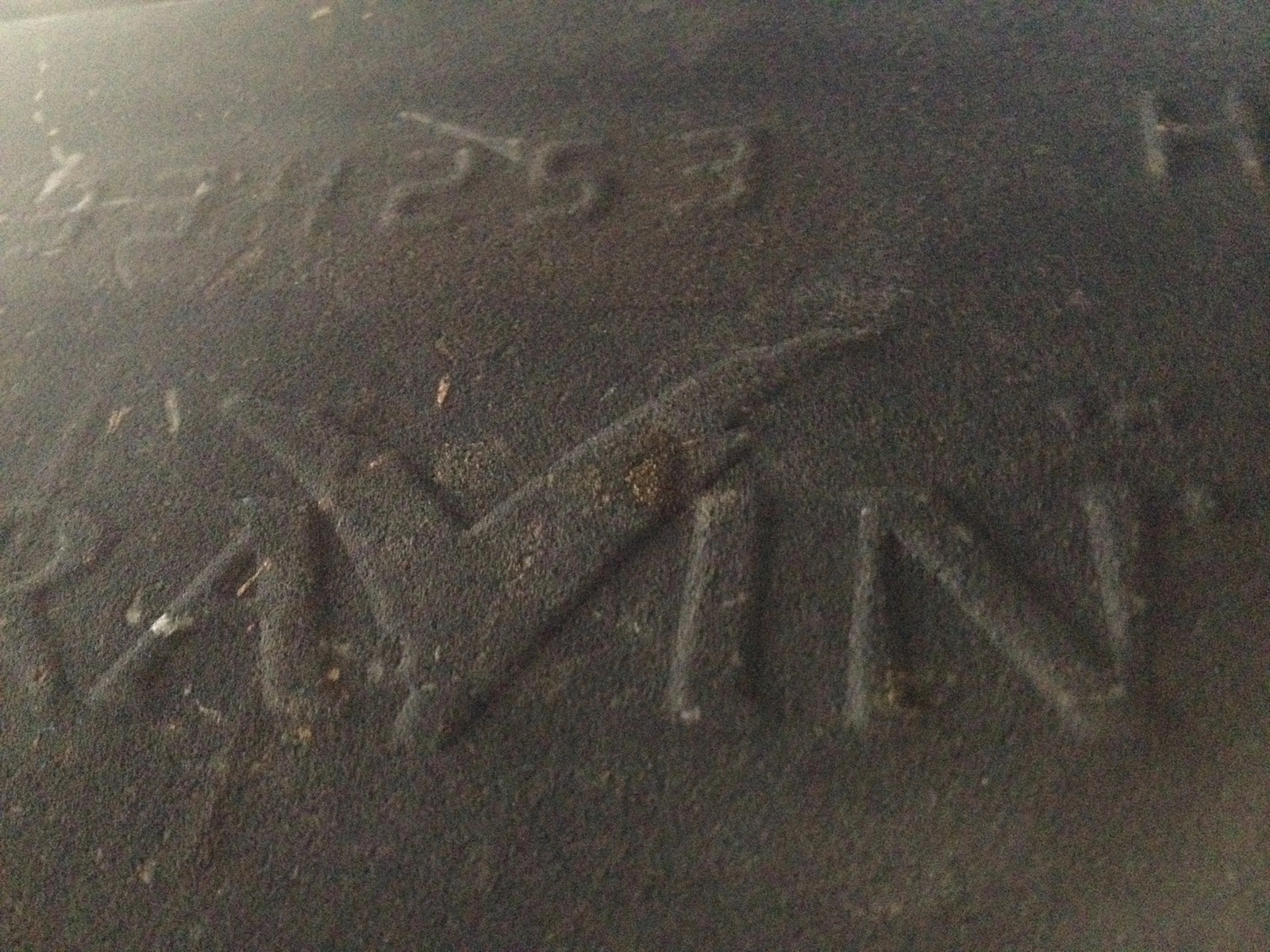

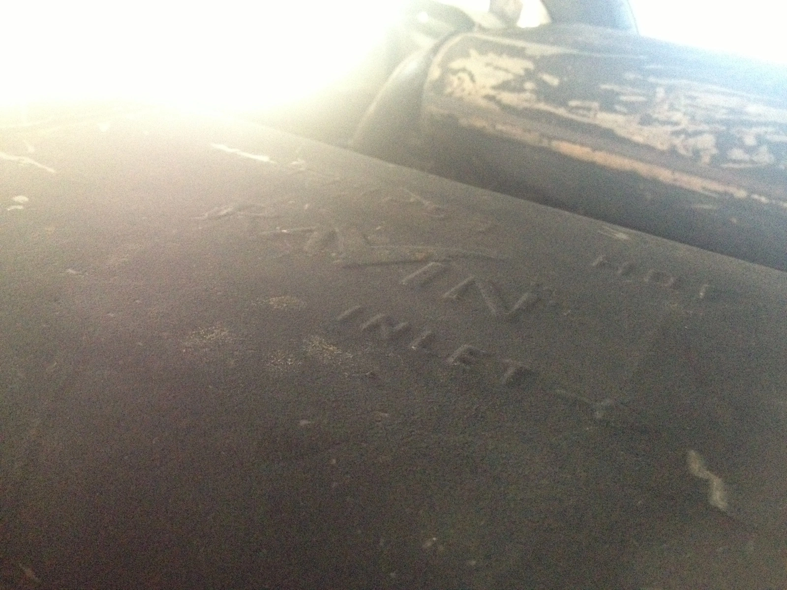

I got under the car best I could using a speed bump, until I can get to a shop and look. From what I could see, I have "Ravin" mufflers.... Wtf?!? I looked them up online and Midas used to sell them at the shop but now they are discontinued....
I think I'll replace them with 10 series flowmasters, what do you think?
Ravins are fkn garbage!
