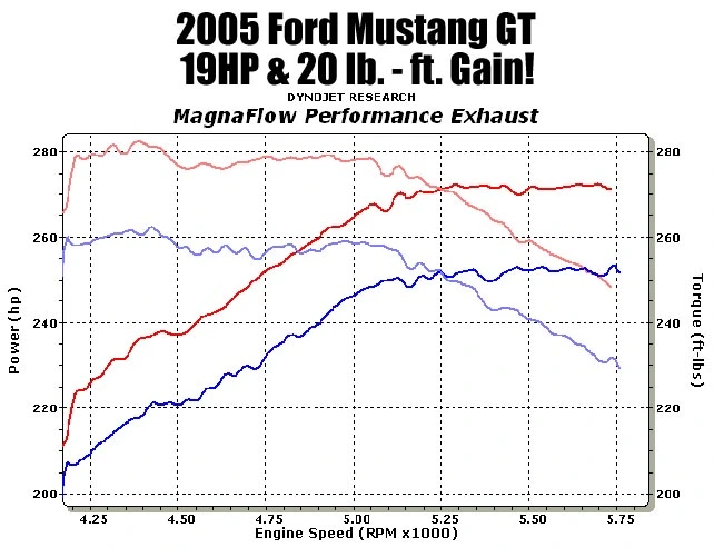

This system produces 19 hp 20 torque. 15881
