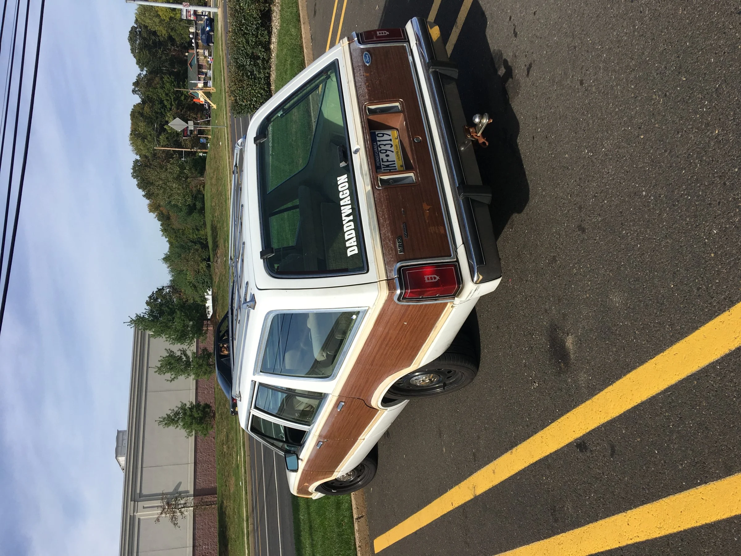

I would switch to H.O. roller camshaft and A9L ecm. Then use Ford’s swap harness, part# M-12071-A50. That is what is in my Daddywagon.
