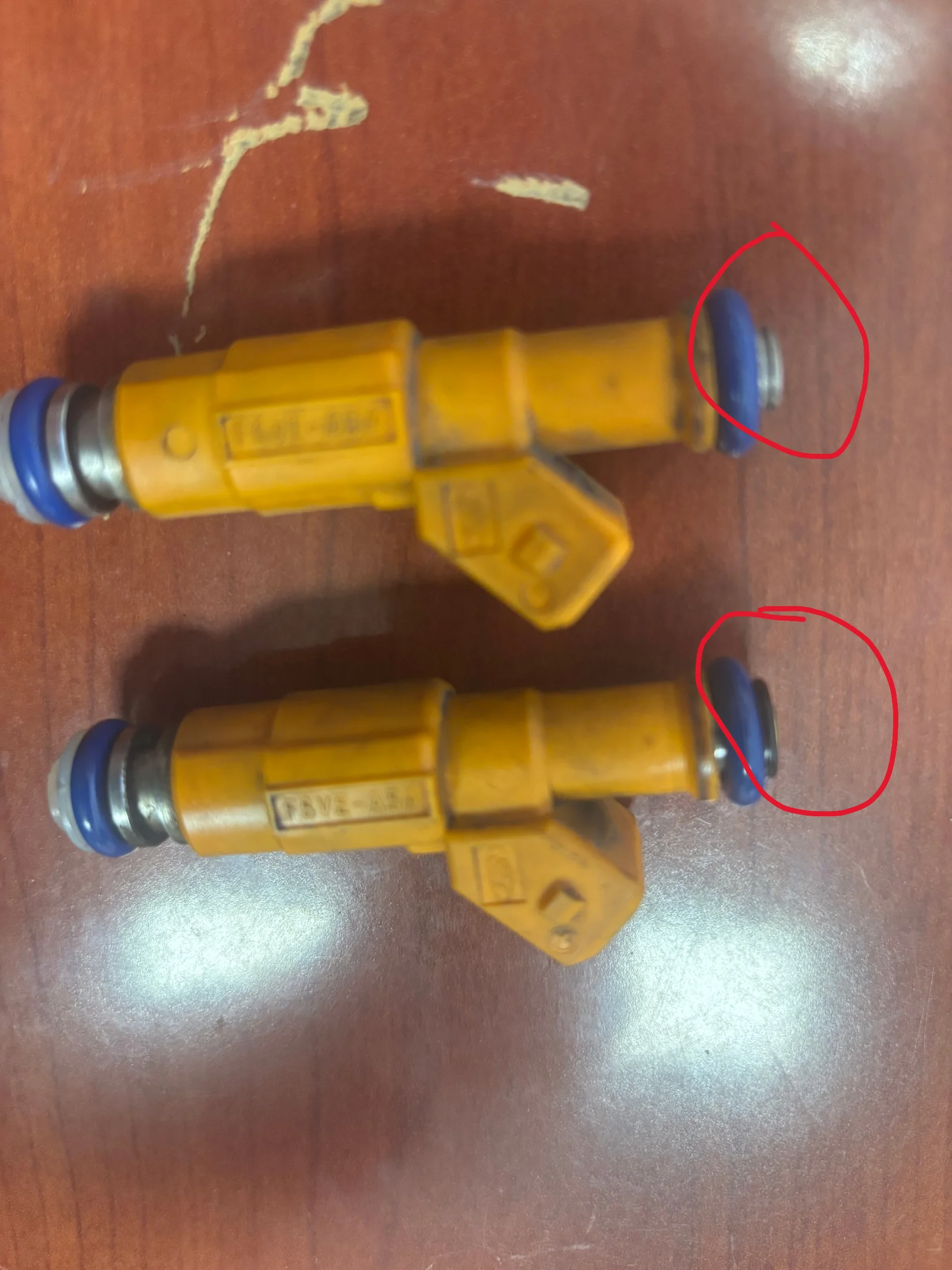

I have a use set of explorer 19lb injectors. Rebuild kit only has two orings, plastic cap (for the lower side) and filter. Where can I buy the small oring that goes on the top of the injector? Is it not needed? See picture which shows the red circle - one injector doesn't have the small black oring and the other does. Thanks for any thoughts.

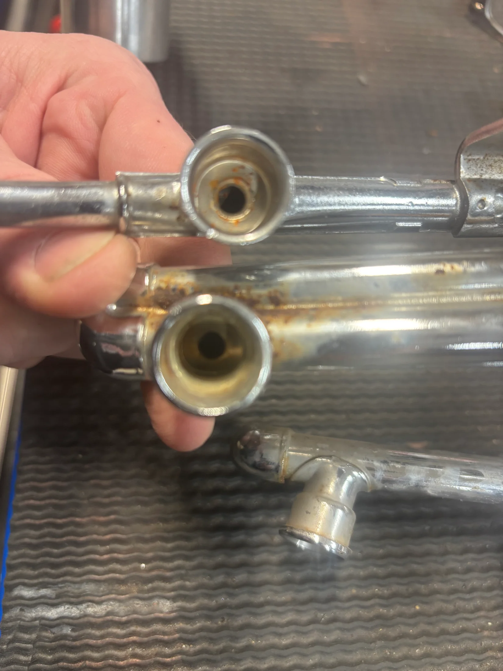

I don't know if you need them as they would be inside the fuel rail and I am not sure what they would seal against. Maybe the explorer fuel rail is different than the Mustang.
I will have to check some of the explorer injectors I have in the garage.
The explorer o-rings are the same. These are somewhat standard.
See pic. Mustang fuel rail on left/top; Explorer rail on right/bottom. Explorer rail is deeper for sure. I am going to use the Mustang fuel rail.

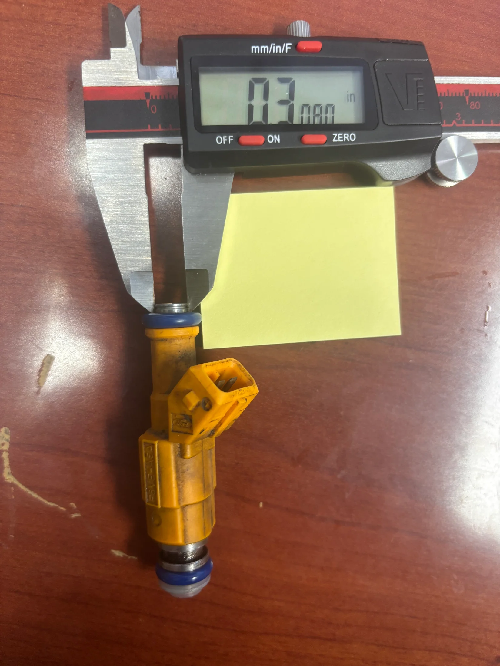

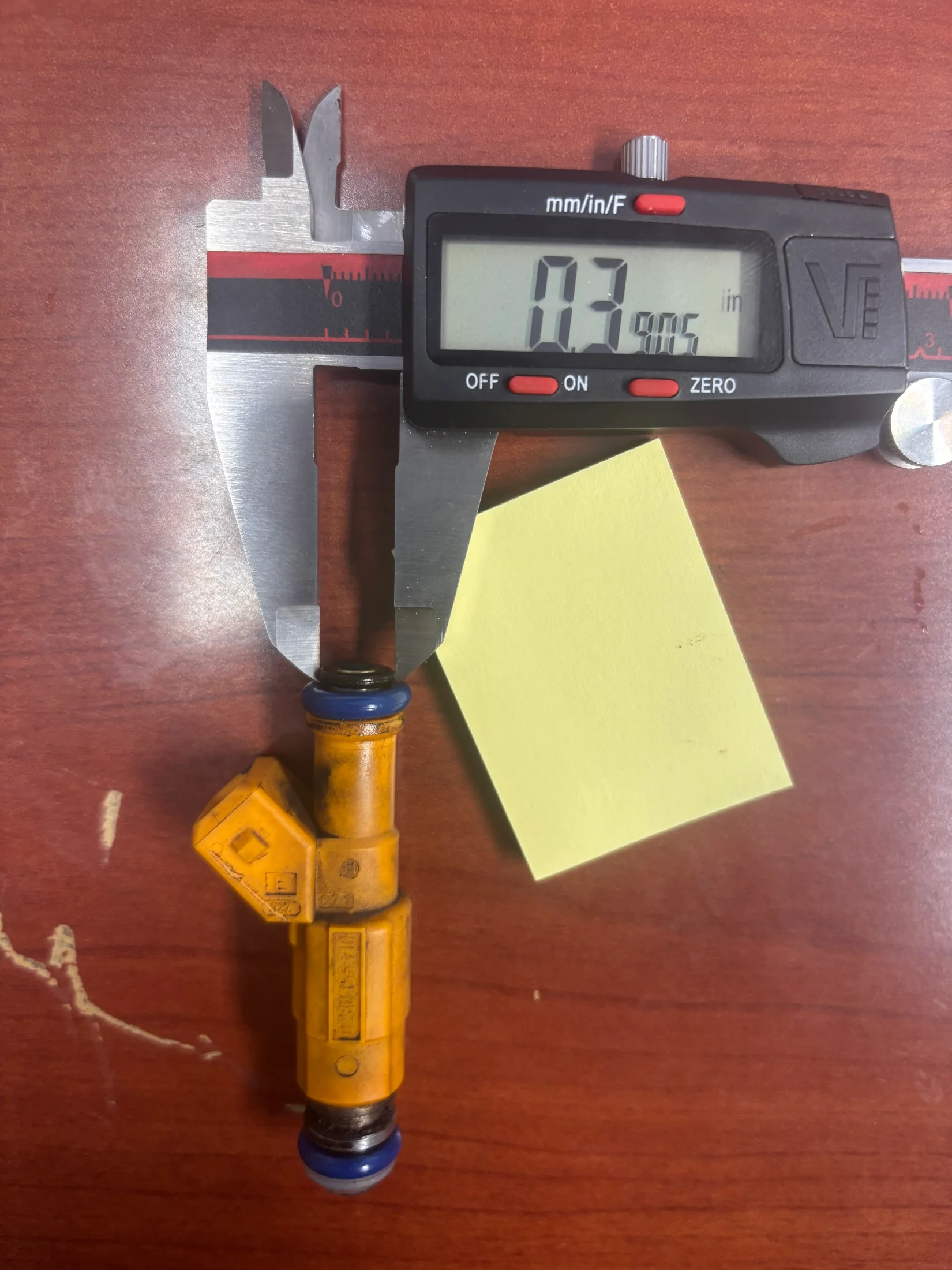

See pics with the measurements. Does this help?
