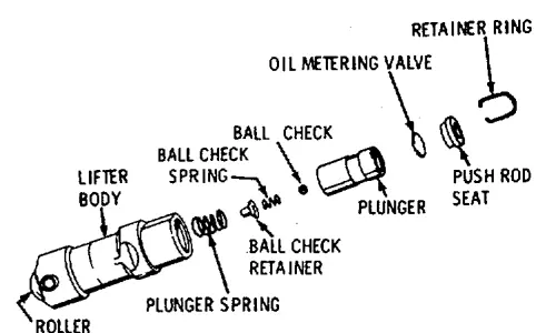

If the #3 exhaust lifter was collapsed then you would have some noise in the valve train. If you suspect this then definitely pull the lower intake and inspect that lifter. Even if the lifter does not have oil in it you should still be able to feel the plunger engage the spring in it and it compress. In case you do not know how looks here is a diagram:

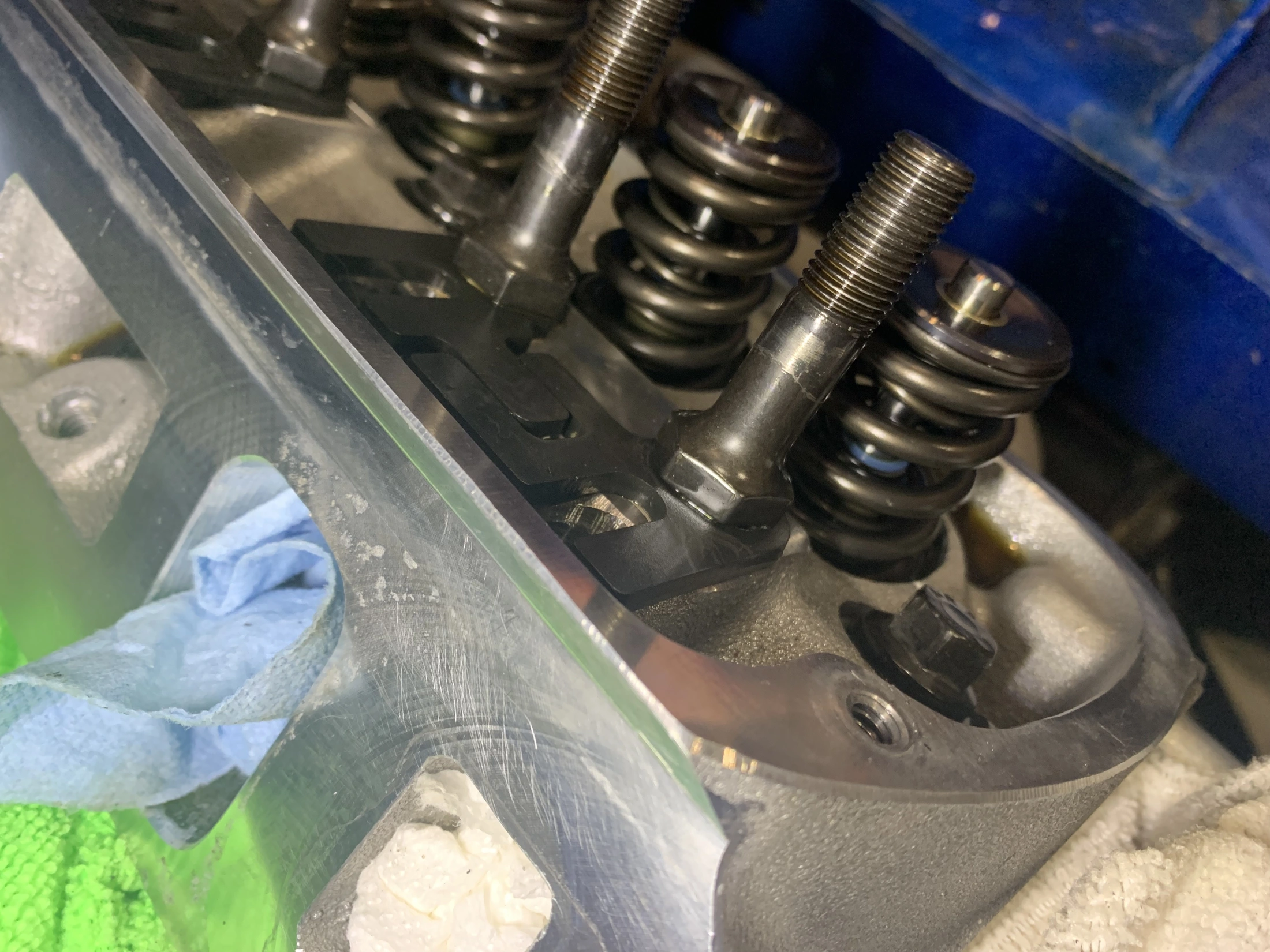

I am wondering about these marks on the studs. I had checked for proper pushrod length several times when putting this together but since the marks are only on the pushrod side of the rocker, it seems to me that pushrods may be too long. (?) 5k miles /Comp pro magnum rockers
