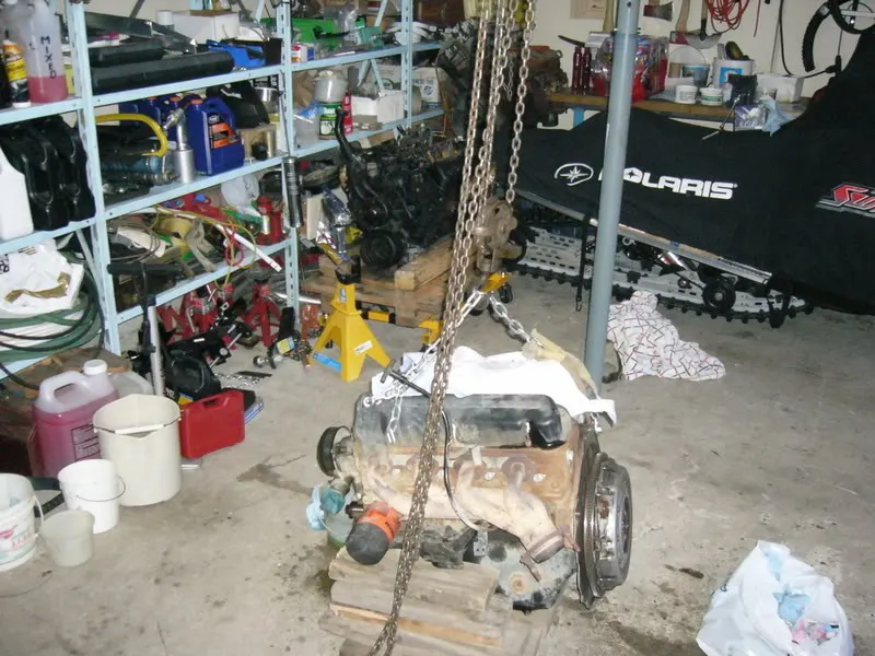

Im currently in the process of swapping in a 97 GT40P motor, with an eddy performer intake, and im going to try the ford racing "E" cam. the short block is the exact same as the mustang, so swap all the external acc parts over and you'll be golden. I do beleave the timing covers are the same, save for the crank angle boss that doesnt get in the way
Out with the old, with the new waiting to go in
