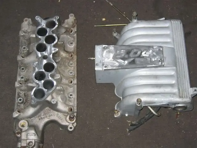

BTW i got pics, and it looks good:

matthiasj said:
i dont guess i have to, but on a budget, with a mild combo, i figured a mild cam would be good, i dont see how a custom cam with mild combo is going to help much vs a mild cam.[/IMG]
the stock cam is mild. and it kicks ass with 1.7's.
heres a fact. the stock cam in 93-95 cobras was milder than stock gt cams. and these cars had 1.7's. we are basically building cobra motors so leaving the stock cam wont hurt. the next best thing is custom which i will do eventually or after i get better heads .
