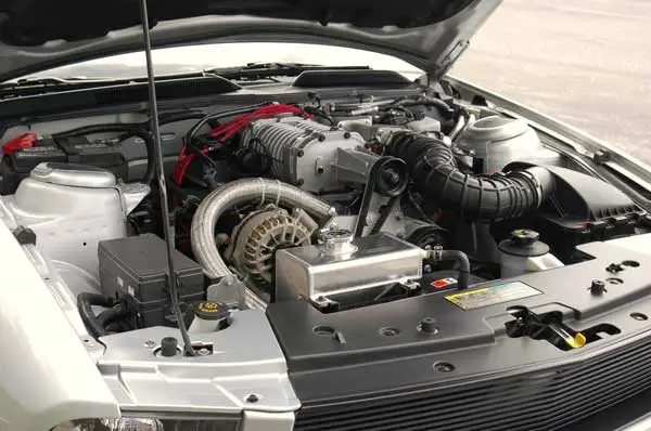

I'm thinking of installing the Explorer X-Charer on my stock 2005 stang. Has anyone had experience with this Eaton supercharger system? What are the pro's and con's of such an install?

Specifically, how hard was the install, any special tools needed, how was the performance gain, did you mpg suffer dramatically, can a shock tower strut still be installed and clear the blower?
Install took about 6 hours, was not difficult and uses basic hand tools. You can download the instruction manual as a pdf and take a look at what's involved. The performance gain suits me, if your a track junkie there are other systems making more HP and torque. The m90 has a bypass valve so it's easy to stay out of boost while driving. My mileage is just about the same as before I installed the supercharger if I keep my foot out of it. ... but what fun is that.
