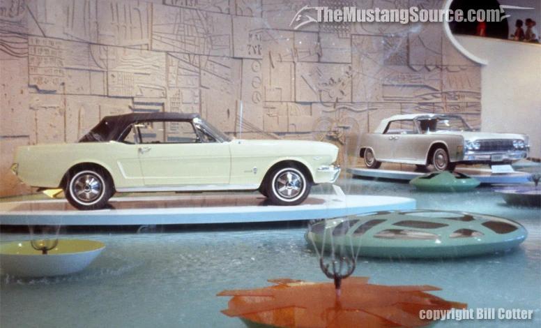

I would shy away from a car with the extended shackles...........they all seemed to sit nose high from the factory.
Don't make me post a bunch of Ford photos showing they were level when new. The problem was the leaf springs, particularly the 6 cylinder and standard V8 tended to sag when the cars were only 2-3 years old.
