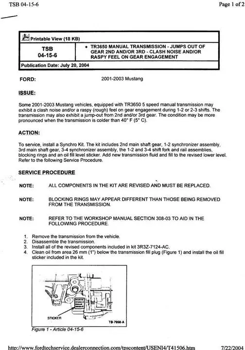

As some of you may know I am currently fighting Ford because of this issue. It only does it when cold. The dealership contacted Ford engineers and they do not have a fix for it yet, so they have asked me to live with it until they figure something out. Sorry but I think that is BS. I paid hard earned money for this car and I do not feel I should have to live with this. I have an arbitration hearing with the BBB and Ford tomorrow and I will bring this video with me. What do you guys think? Would you live with this?
http://www.youtube.com/watch?v=A5p6vlCVQco

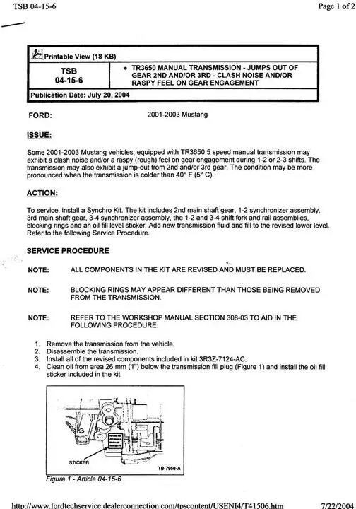

Try taking this TSB with you to the arbitration hearing:
That's Funny - while I'm sitting here reading this my 04 mach 1 is at the dealer right now for the exact same thing! Mine started doing it only in 5th when it was cold. Then it started doing it when it warmed up. The day I brought it in it was doing it in 3rd, 4th, & 5th. Definitely gets worse if you don't bring it in right away. I'll post when I get mine back & hear what they say it was - if I can believe them...
Odd. I had no trouble getting my local dealer to do the TSB on my T-3650. At times I wish I didn't do the fix though, cause my tranny doesn't shift quite as smooth regardless of fluid level or fluid type. Also, I know some people have issues getting into reverse with this tranny, but I didn't have this problem at all until after the TSB. :rolleyes:
