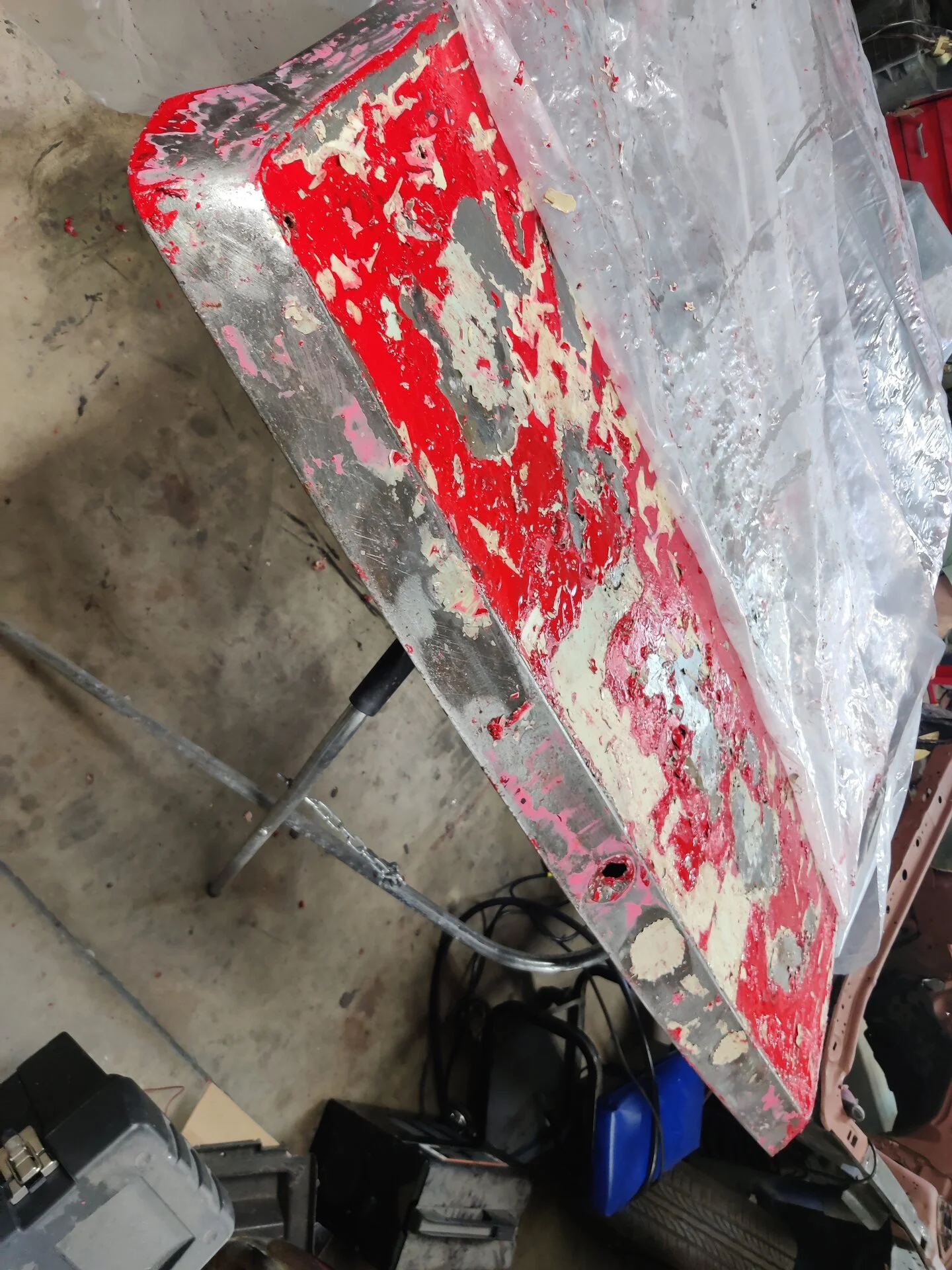

Just wondering if anybody has any info on this. I'm in the process of stripping a replacement hatch for paint and I found a whole bunch of body fill. Could this be something they did from the factory or did I get screwed. The metal looks fine from what I can tell. I also found the same type of body fill on the lower rear quarters of my car.
Can't tell from that pic but I think there was no filler use on the hatch from the factory, factory used filler on roof to sail panels but I believe they didn't use plastic type filler, I could be wrong, years ago it was a lead type filler.
You are correct. Roof seams on the A pillar and the roof to said panel area was done with lead-type filler.
You usually see cracks in these areas on older cars without subframe connectors because it's still soft enough to flex a tad
  • Informative
Reactions: General karthief
Its weird because the lip and the trim channel are completely clean and it my experience thats where the rust usually is. I'll update as i peel more of it away.

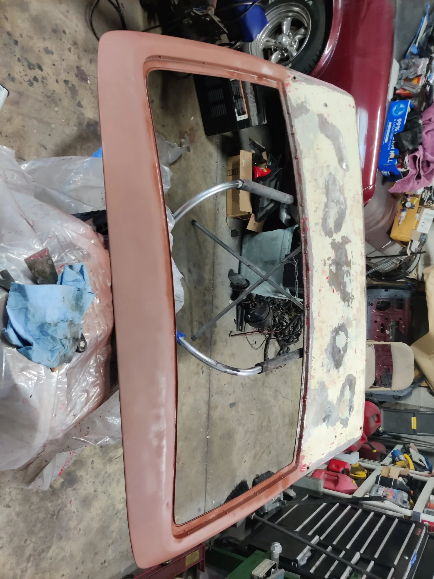

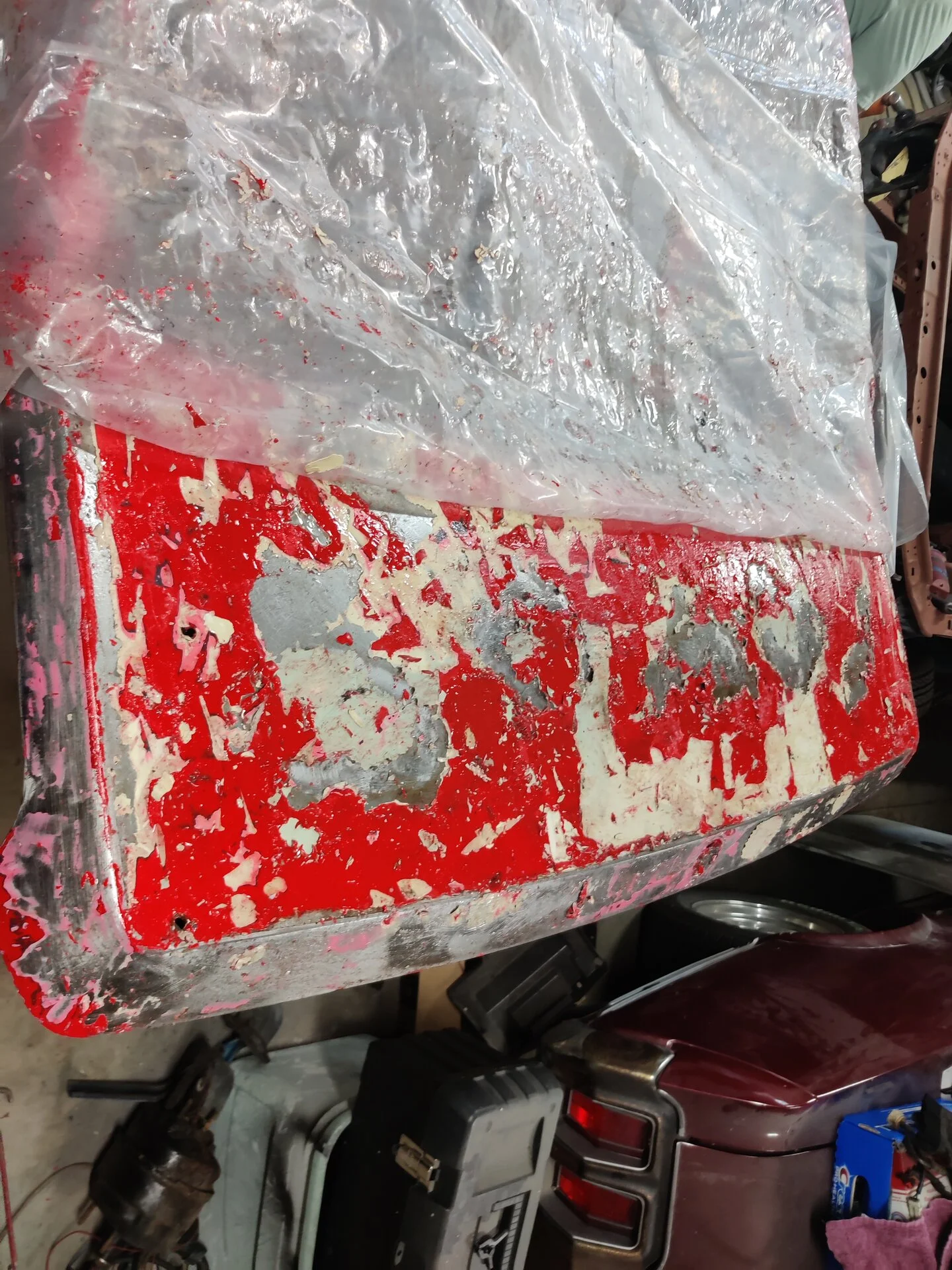

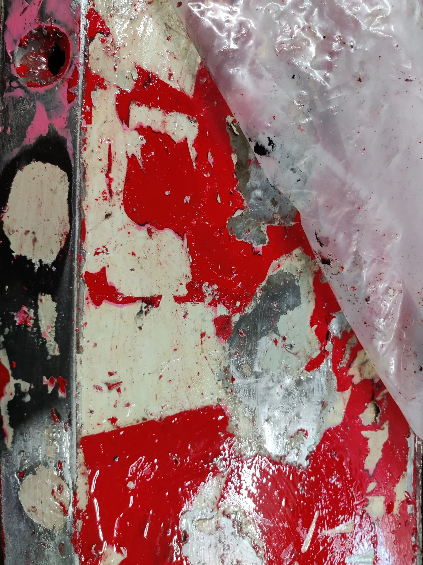

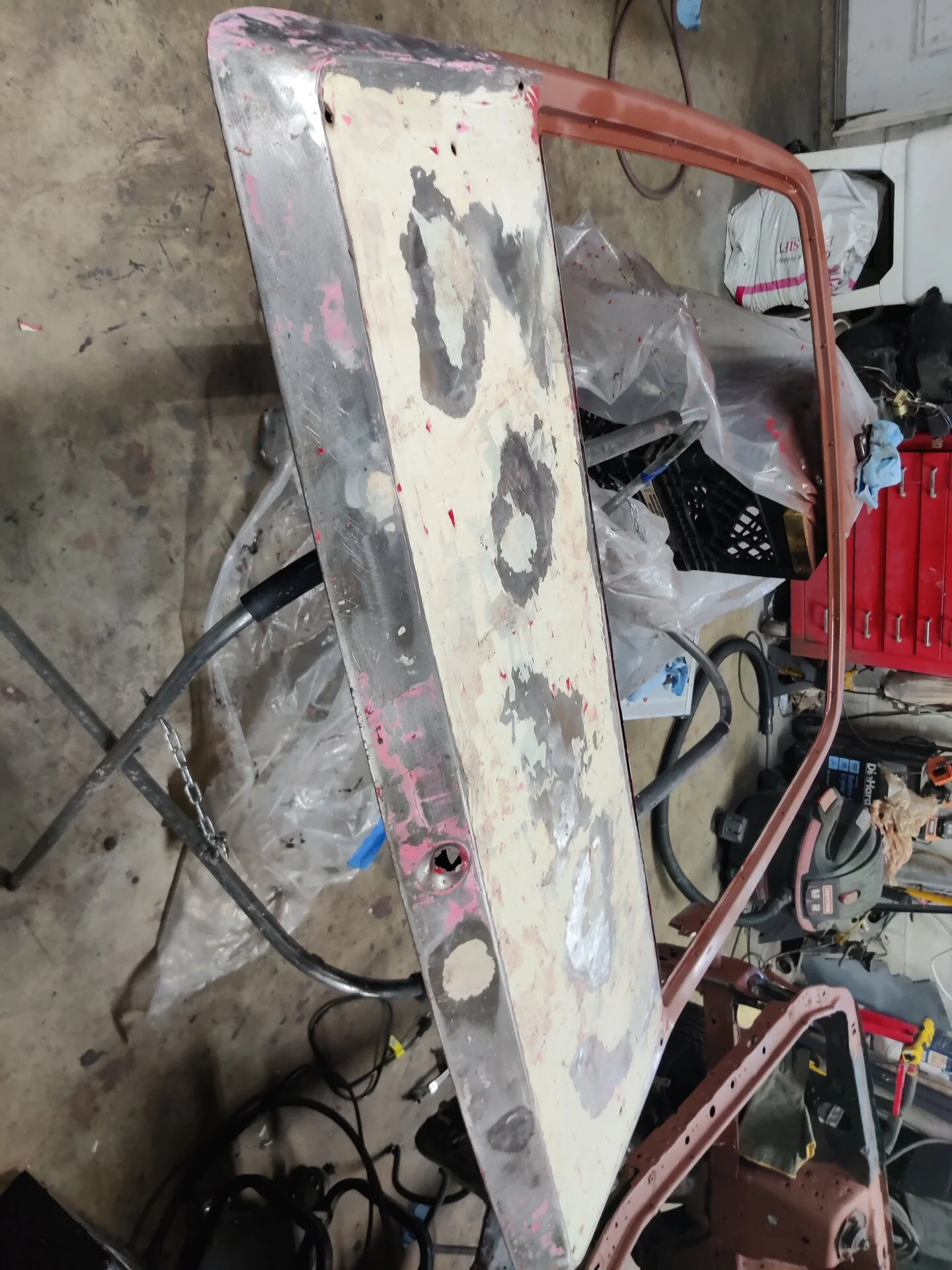

yea definitely some dents at least it's not rust, my guess is hail damage. Moral is don't trust anyone :cautious:
