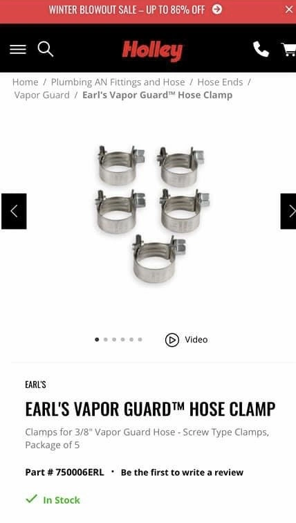

I was referring to your comment about the high pressure hose and clamps looking terrible. I think I've seen a band/ring type of clamping system that was very clean looking but required some type of tool to effectively squeeze and lock the band in place. Wouldn't be necessary though with the replacement tubing in the link. Link and boiling water technique was very helpful by the way.
I've tried the hot water trick many times. It has never worked out well for me. I have used those little cv boot type clamps on them and they did not leak. The correct tool is listed under cv boot clamp pliers and has the part in the middle that flattens them out as the two sides tighten it together. The clamps themselves are available at most parts stores.

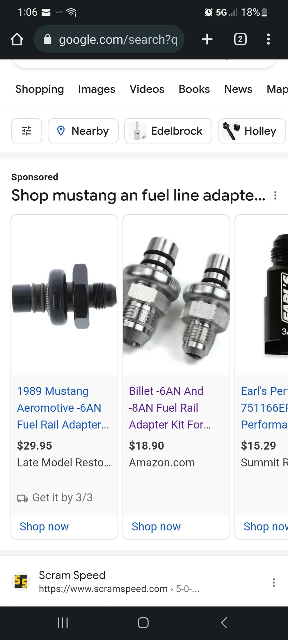

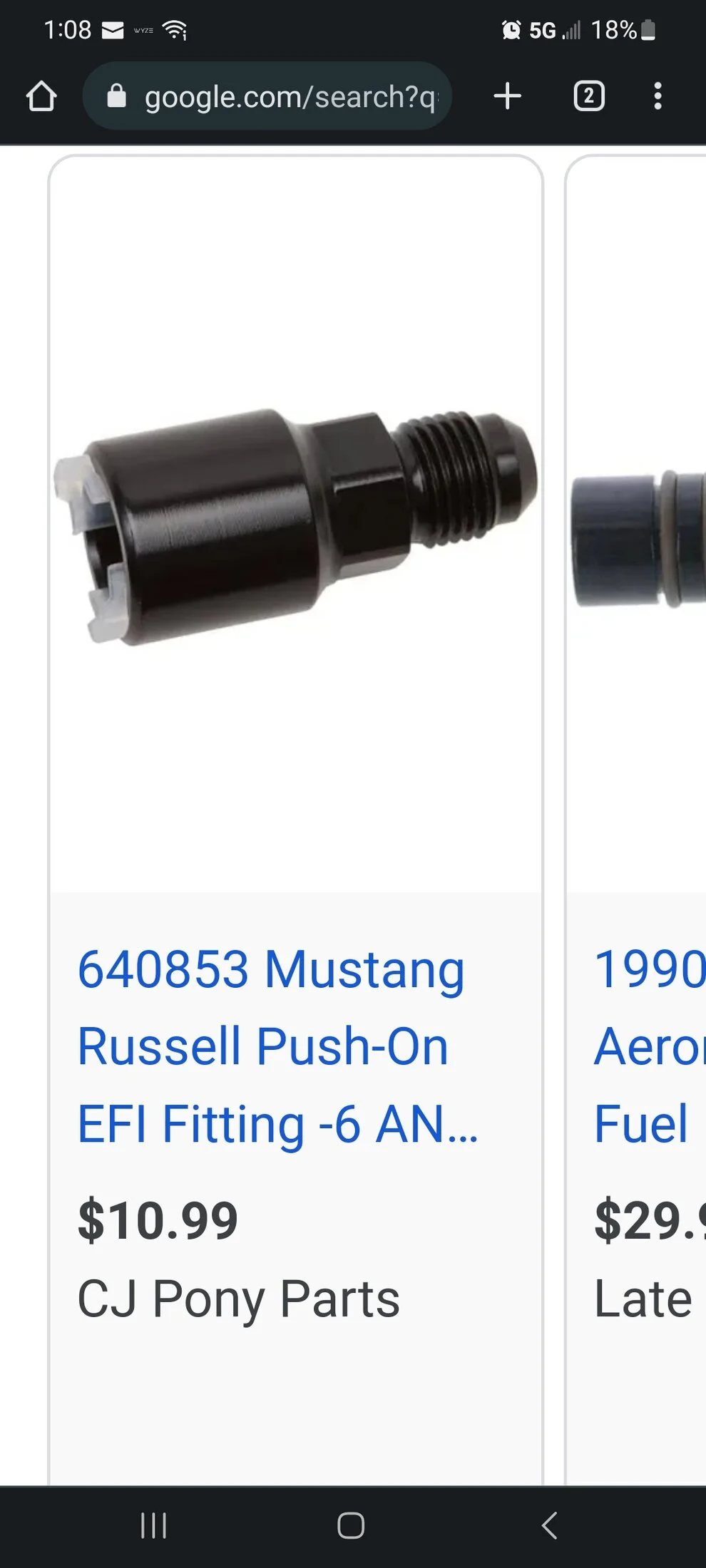

On my current car I used AN adapters from the fittings at the frame and at the fuel rail. This way you could use push lock hose or braided PFE hose.
Excellent! I think this is the clamping system I had been trying to remember. Do you have any photos of the AN adapters fitted to the frame and fuel rails?
