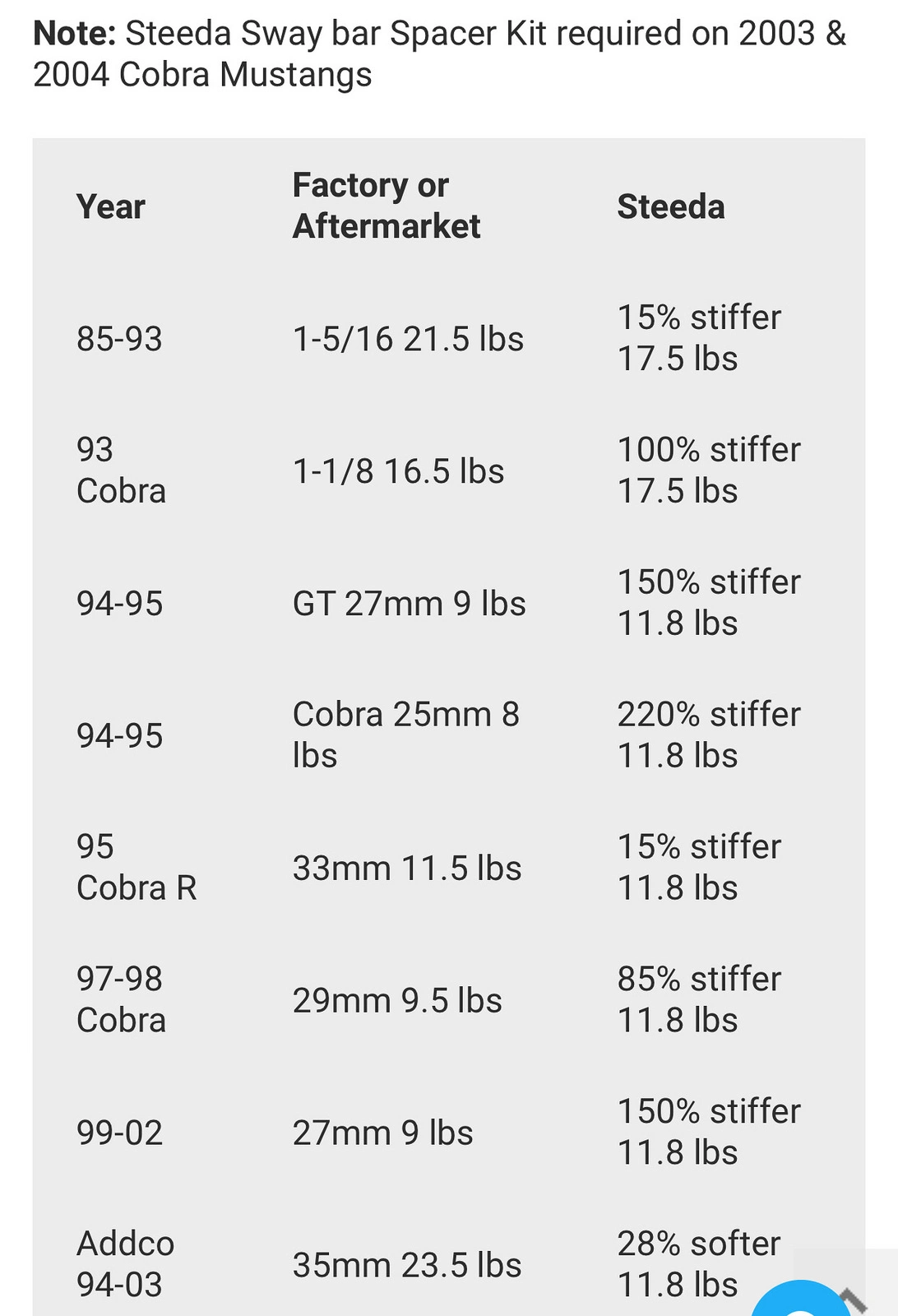

Is there a big difference between the factory sway bars on my 95 GT Convertible and aftermarket ones?

It'll make things a bit tighter is that's what you're looking for but might not be enough to feel street driving. You'll need to pull G's so if you're road racing or AutoX it will help.
Here a chart from Steeda's website of their aftermarket bars vs. stock.
Notice the GT front sway bar on a GT is 27MM and a Cobra 25MM.
Untitled by https://www.flickr.com/photos/143276860@N04/, on Flickr
Reactions: acpowell

This is exactly what I wanted to know. I am not going to race/autox/or drive like a crazy person. I just want to make sure I am getting rid of as much body roll as I can with out making my wife complain about how stiff the ride is. It seems like I will be leaving the factory bars on.
Thank you VibrantRedGT!!
