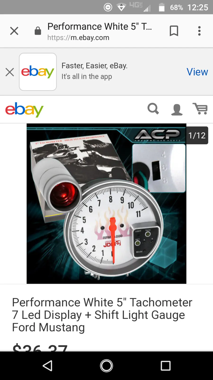

It's possible the tac is FUBAR,I'm thinking of getting this one. What you think ? Never heard of it though
