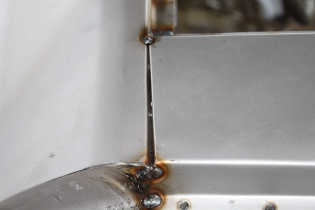

you are very correct about the fit at the rear window .it isn't bad but something is a little crooked ,about 1/8 inch .i have done several 67 -68 quarters and the driver side is always this way .the pass side always fits good .if you haven't changed the lower rear window panel then i would say it is the quarter .all in all not a major problem but expect to have to work this area just a bit. Dynacorn and Ford tooling sheet metal seems to be heavier gauge than original but the Dynacorn is the heaviest .
i found a pic of this area at the bottom of the window where it meets the quarter. yours probably looks about the same ?

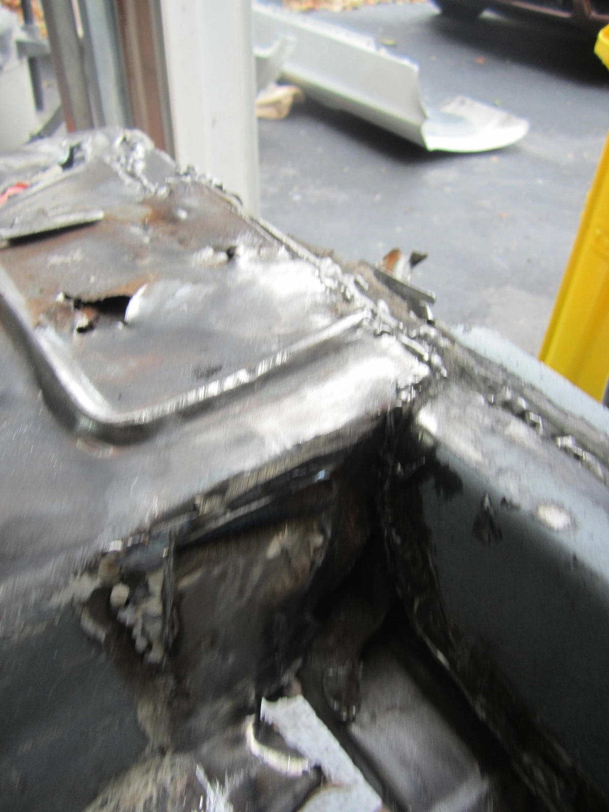

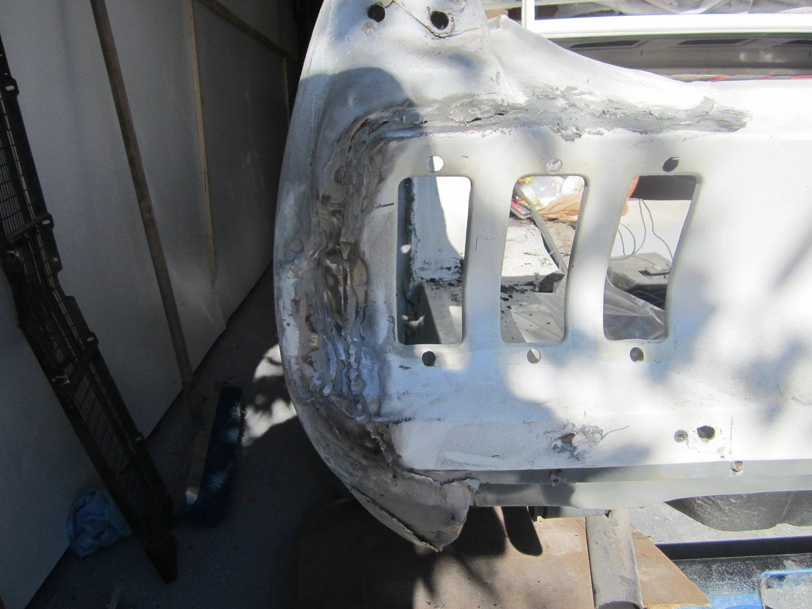

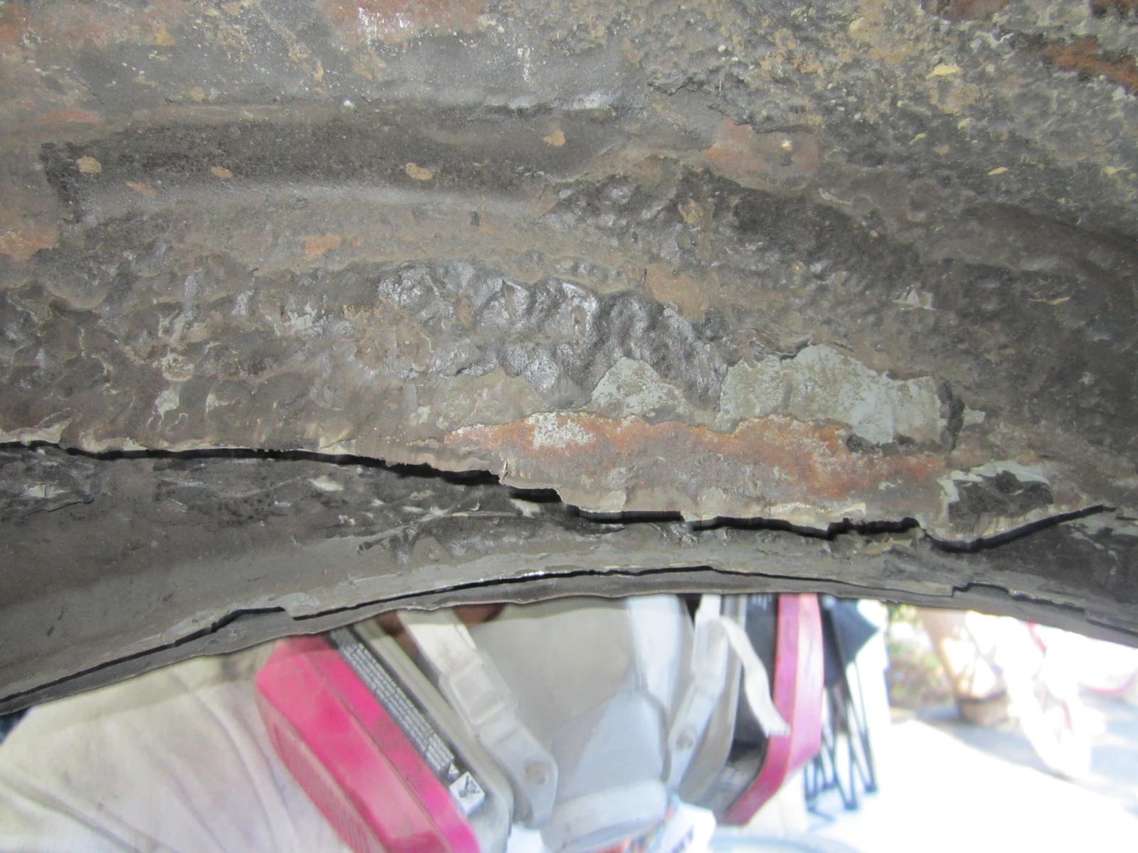

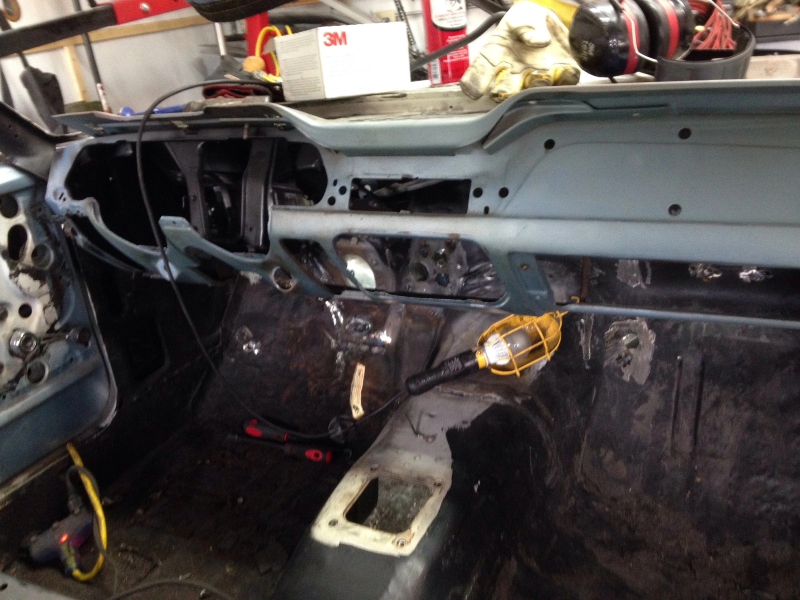

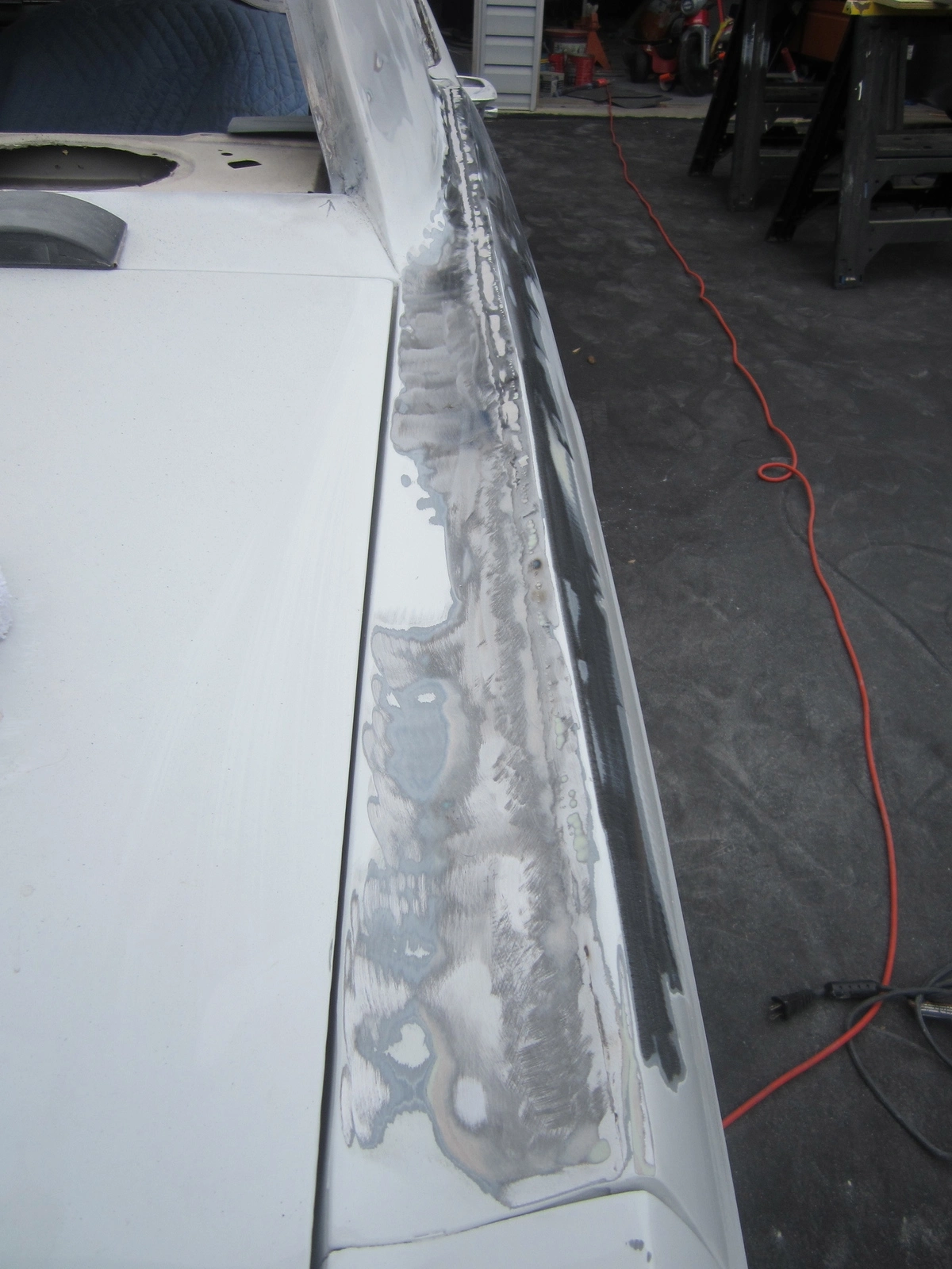

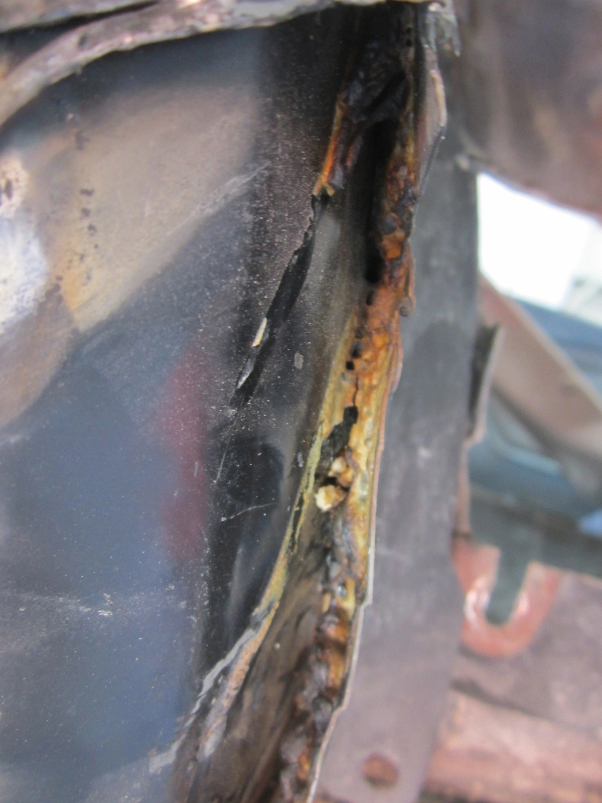

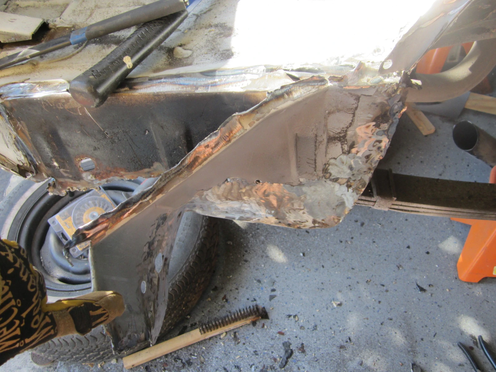

Here are some pic's of what I have been dealing with. Note that the quarters, wheel wells tail light panel and trunk drop off's all had new panels "welded/glued" over the old panels. The resulting mess created approx 1/2 gap between the quarter extensions and the tail light panel. The quarters could not be salvaged as they had been notched too high and the replacement panels were welded over the crest of the panel which completely destroyed the top edge. Once the trunk floor arrives from CJ Pony, the PAX side will be reassembled and then comes the drivers side.

So I spoke too soon. After tearing down the drivers side, I found the last 14" of the rail are toast and must be replaced. It also appears that the rear of the car was wrecked/damaged since the DS rail is 3/8" longer and 1/4" pushed out. More fun before assembly.

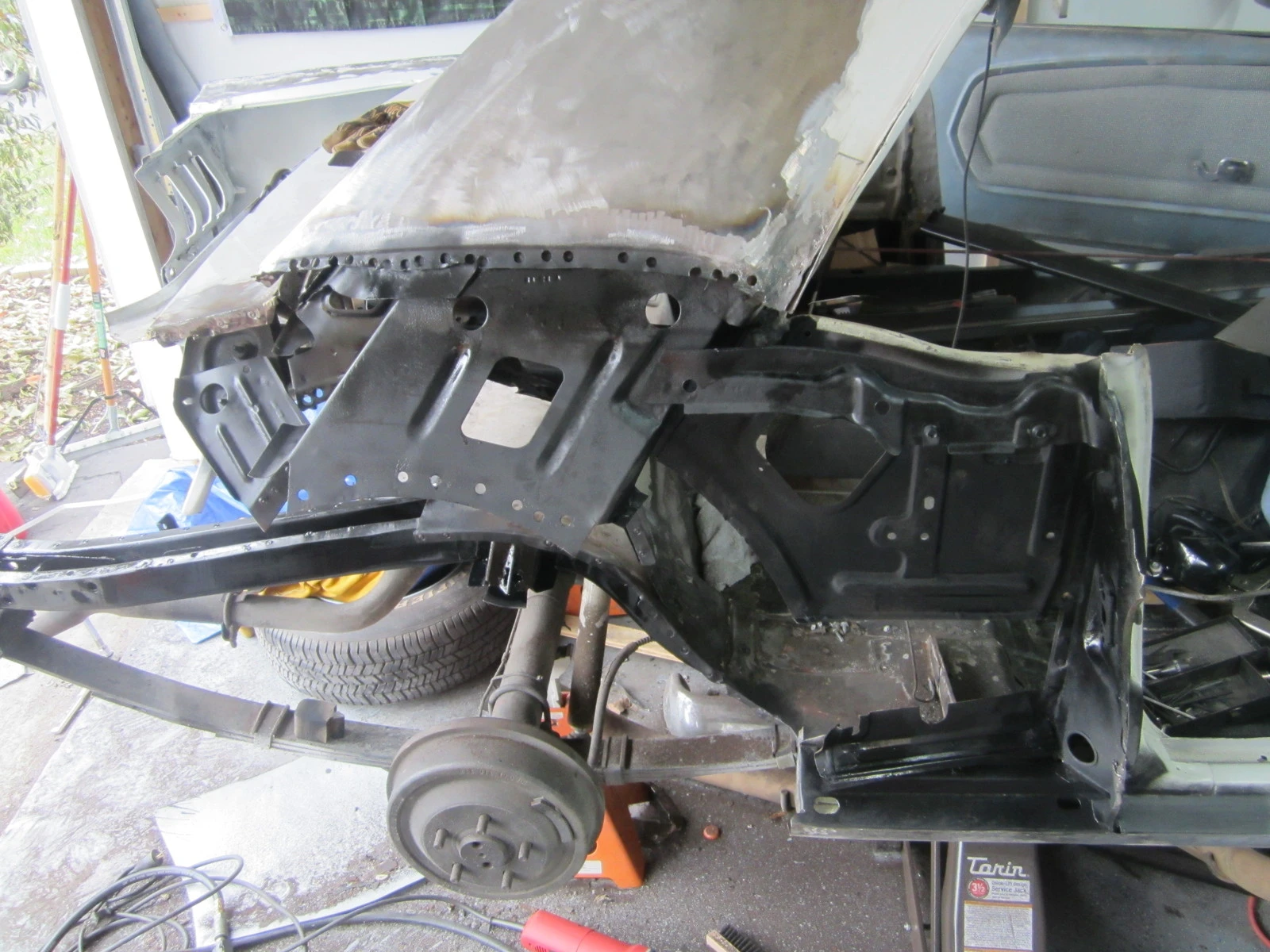

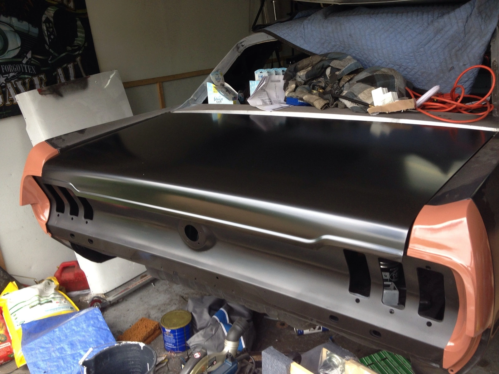

Much work has been done since my last post. Completed DS rear new frame install. Installed new rear quarters, truck brace, lower rear window panel, tail light panel, trunk lid, new seat pans (all dyncorn). Also installed new floor mount e-brake, completed shelby drop and under coating. Currently putting in Borgeson PS sys, Idit tilt, complete painless wiring harness. Gonna be a challenge dealing with aligning the quarter panel extensions and cleaning up gaps. Still much more to go but feels like I am finally making headway.
