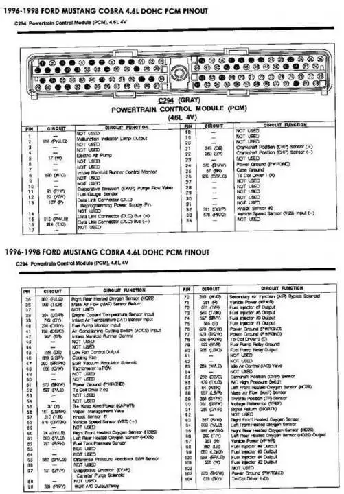

Can you provide a picture of the wires and their wire connectors if available? If not what colors are the wires? Are you saying that the wires are coming out directly from the ECU? They are hard wired into the ECU's wire connector? I can probably track the wires by the colors. You said the ECU is from a 1996 Cobra Mustang, correct? I have posted the 1996-1998 Cobra Mustang 4.6 ECU Pin Out below. If you look at the ECU where the wire connector terminals are, you should see numbers which identify's each circuit. Click on the bar above the diagram to make it larger. You will probably need to use a magnifying glass to view the diagram in detail. Let me know, Tommy.
