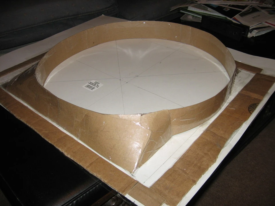

Fan shroud mold
Alrigth I figure I would atleast post some pics of the form. Yes I know its looks bad, but I had a friend look at it that does scale air planes and said it would work but will definetly be a pain. Here are some picsso far View attachment 468535
Yes tape job looks bad but thats towards the radiator. I am going to smooth out the visable side.
