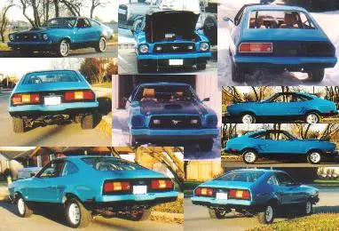

I called my body shop and they admitted to using a product called Vette-bond! It is the same stuff they glue Corvette body panels to the steel inner structure with. Makes sense, just feels dirty using Chevy glue on my Mustang! I will post some pic's tonight (I am heh....hem at work right now). I was going to do the same thing as cobraii351 (looks very well done), but the dudes at the body shop insured me the glue would work. (I had posted a similar thread a year back). The Vette-bond worked really well for me.

Here are some pics for you........

It is kinda hard to see, but the one photo of the un-painted bumpers shows the back side of them. The bumpers have no brackets or instructions. They looked very good for the low price. (I work at a speed shop and I have seen much worse!) I burnt the urathane off the original bumper supports, at that point they were sand blasted and the new fiberglass bumper skins were "Vette-Bonded" on to the original steel bumper backings.
