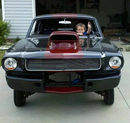

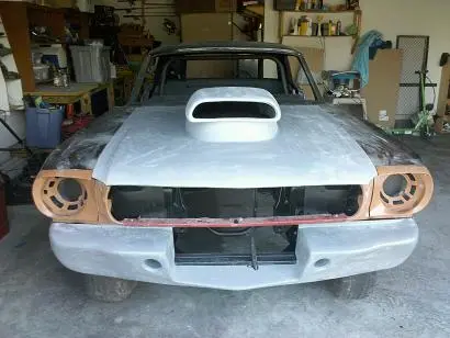

I got their aero hood. attached are some before and after pics of fitment. It was close, I had to add some to the front to get it to line up with the head lamp buckets. Any glass you get will need work. I found it easier than metal work (and I had done neither before I did my car). It just takes patience. I will say the hood is very thin. I street drive my car. I always wanted the entire front end to be glass, but figured it wasn't practical. Unless you fab up a mount that lets the entire thing tilt off, it will be a pain anytime you want to get to the motor. The website has examples of tilt off, but it probably isn't as easy as they describe. With mine I have to pull the hood off. It isn't to bad, but couldn't imagine the entire front end just to check the oil or what ever. It also looks like they have a heavier version of it too. At that point I would just consider aftermarket fenders. I got cheap repo ones, they are very thin. I don't think the weight difference would be significant at that point. Good luck.

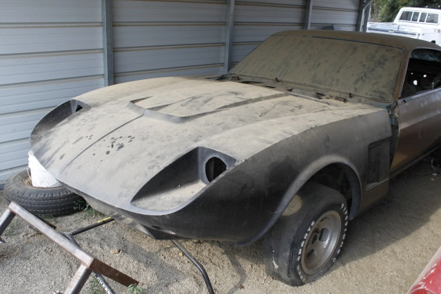

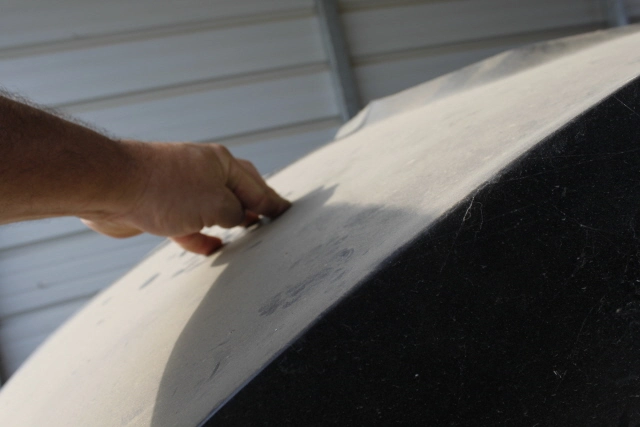

i dont know if you have seen the fiberfab front clips that were made for the 65-66 . i bought one of the coppies from VFN .they only sell the one piece front for racing. it is very thin , for raceing ,and i could just about push my fingers through the front of it setting in the sun. i was going to do a 65 coupe but it would need at least 2 layers laid in side to stiffen it up and there is no bracket to reinforce the end of the fender up to the door ,it's just the outer skin. it would either have to be a tilt front end or completely removable. i new this when i bought it . i was going to cut the hood out and make an underbrace for it so the hood could open but i just didnt have the time .it is strait, just not realy practicle for a street car the way it is . i have it setting on my 69 just to keep it out of the way.

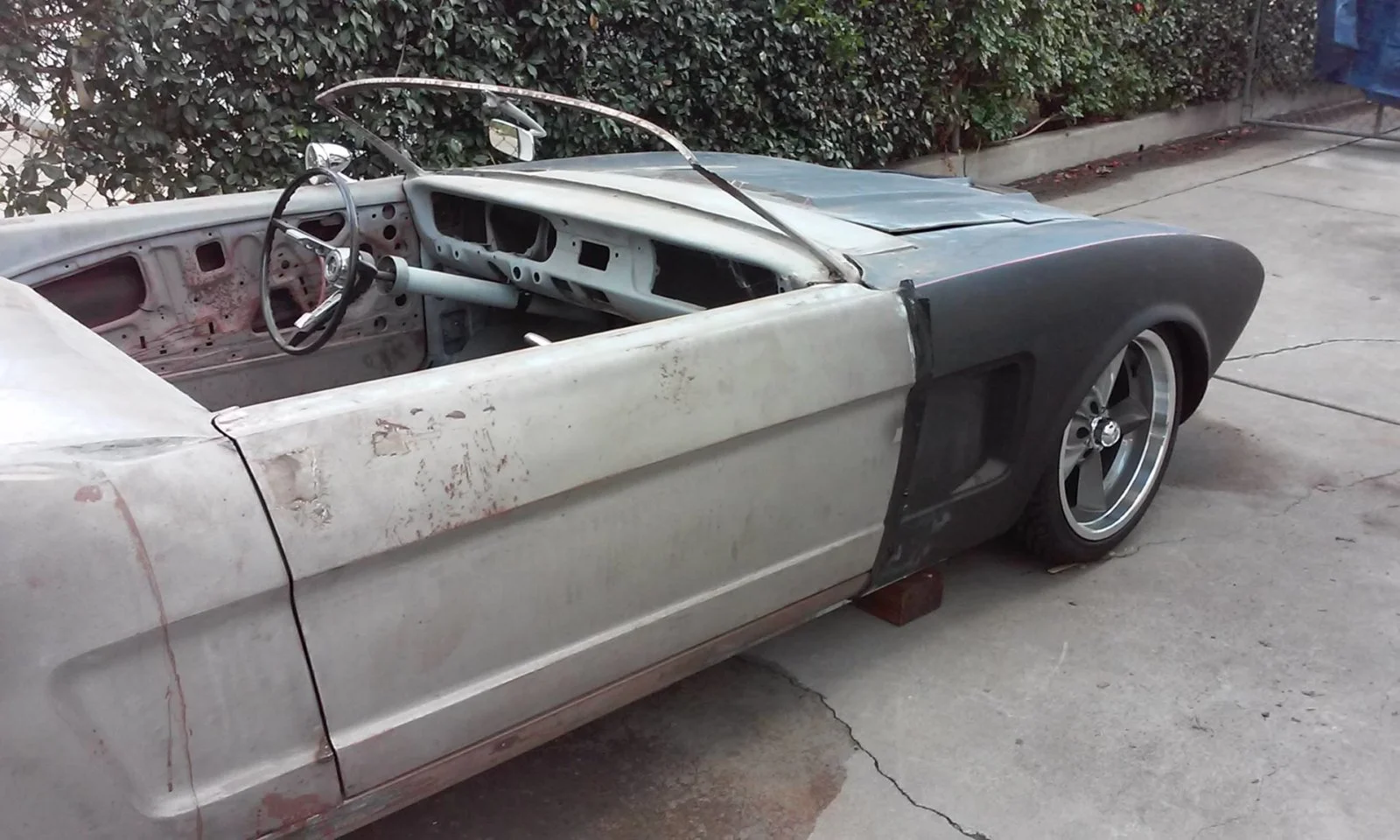

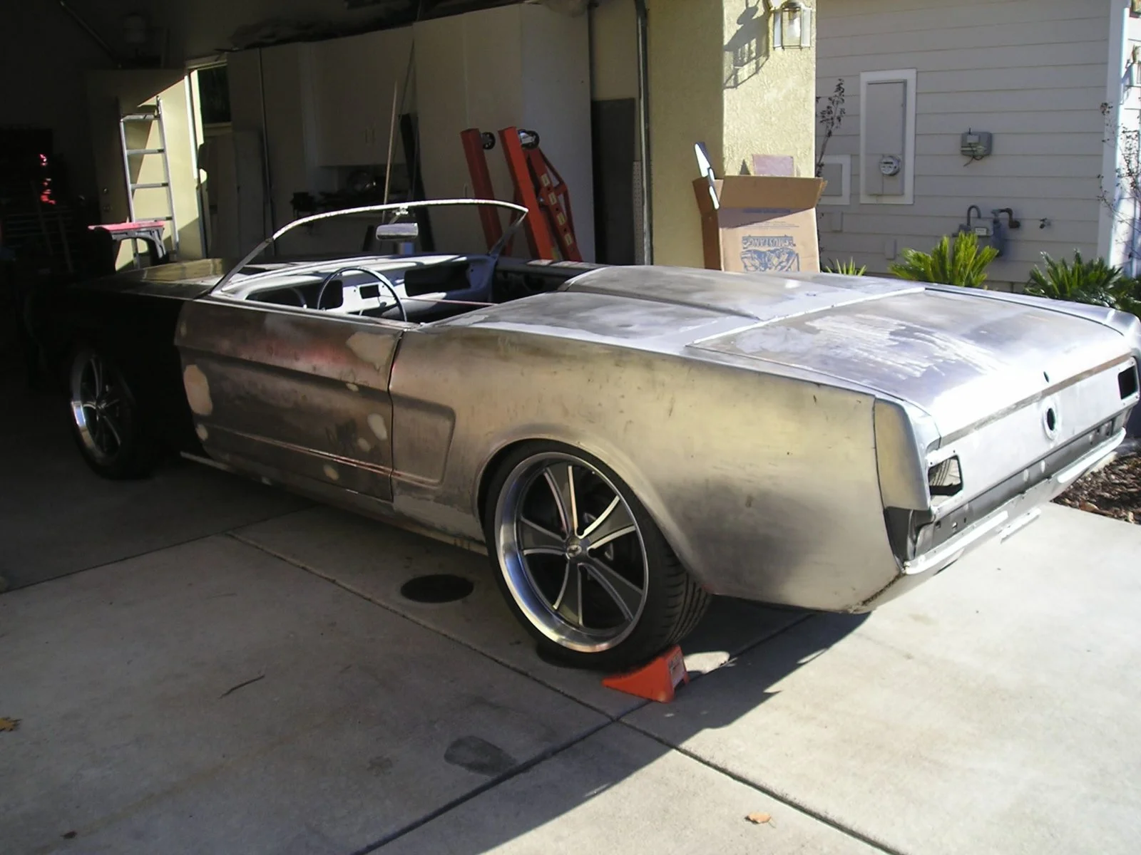

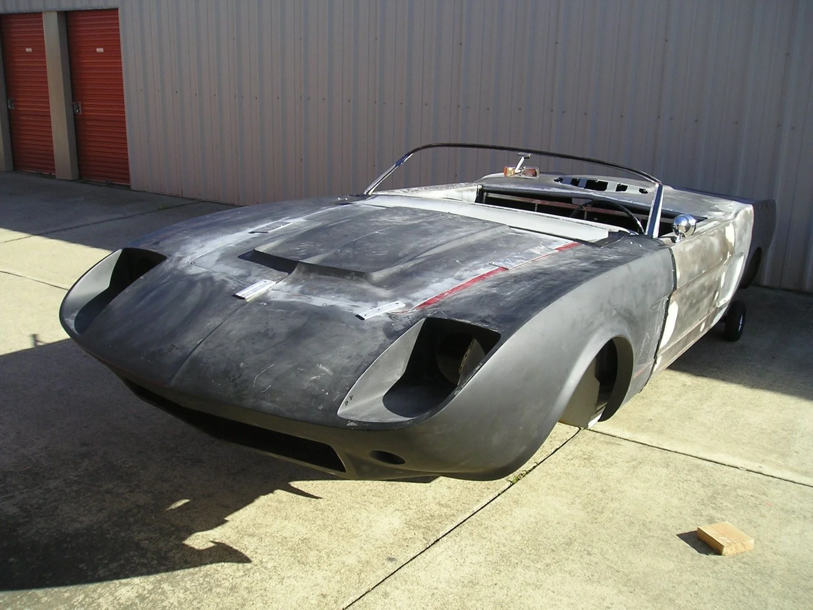

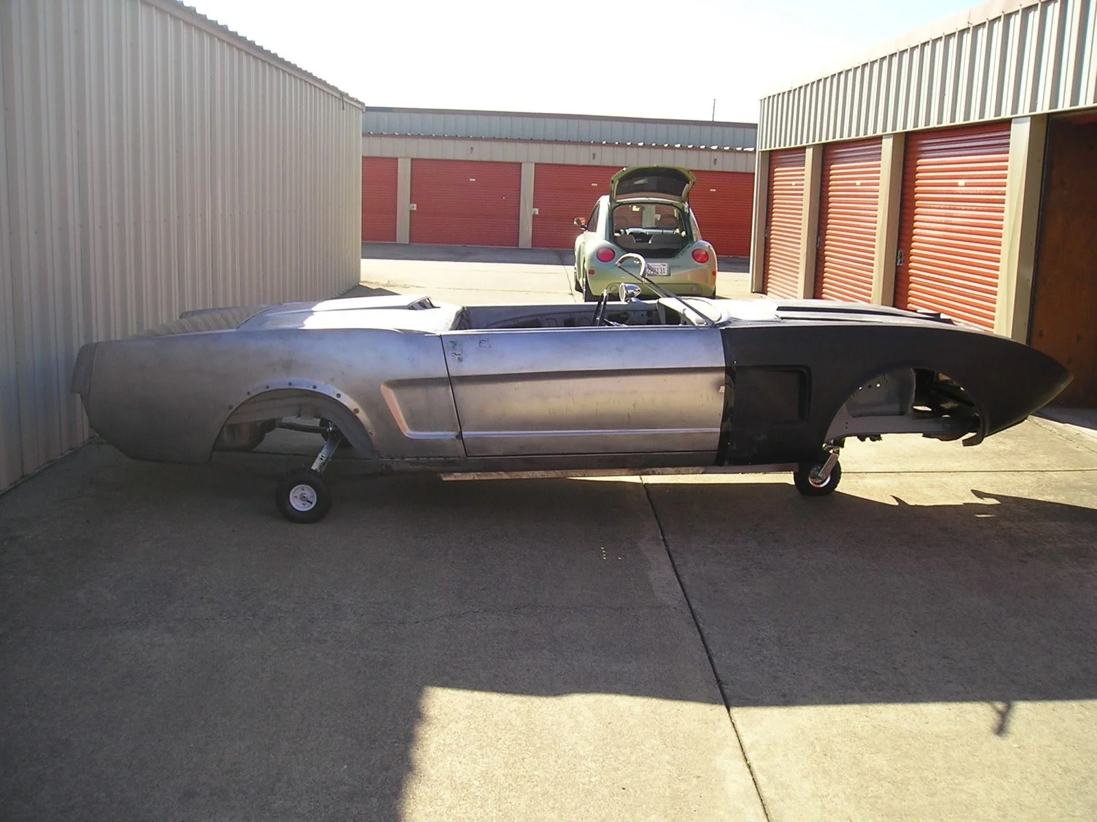

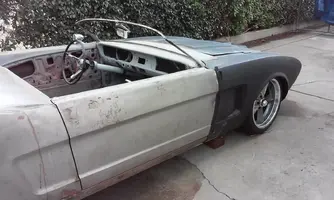

I'm new and alittle late to this forum, but yes I bought one VHF fiberglass good product fit is so so but its fiberglass and it can be heated to fitted and gapped correctly
