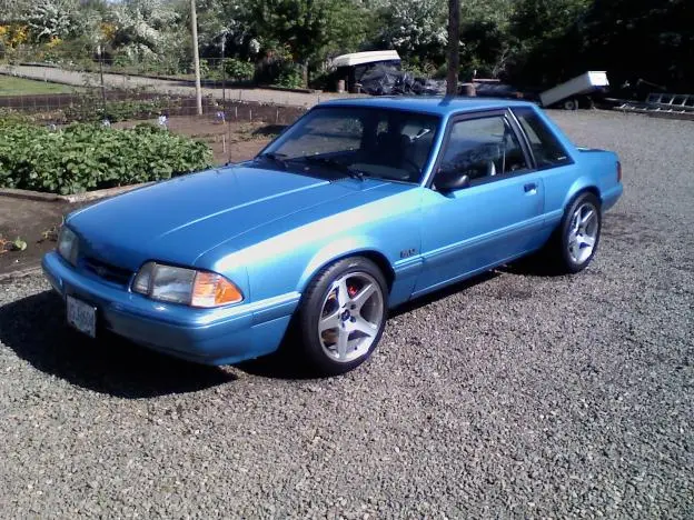

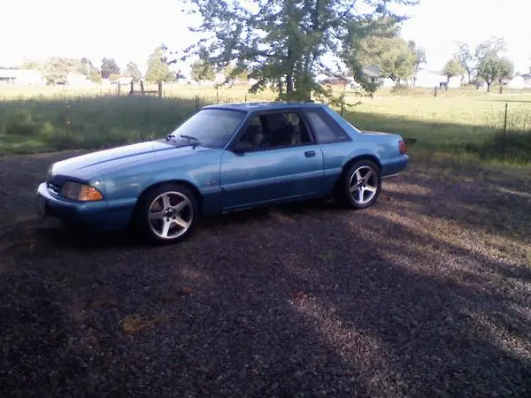

Hey guys.... did a few upgrades this weekend to the 92 coupe. 5 lug using 94 spindles, axles and mc, cobra brakes front and rear, 03 cobra wheels, 255's in the front and 275's out back.I ordered all the SS lines and line addapters from Maximum Motorsports...good stuff!! I had 3 different axle lengths to try in 5 lug....same as stock, 94, and SVO. The SVO where way long with the cobra wheels but were perfect with a set of 05 bullets, the stock length ones pulled them in to close to the exhaust and the 94's where just right! Now if I just had the 03 cobra motor to drop in her!
What do you all think?
Ps...yes I know the tire tread is the wrong way....it was only for test fitting.

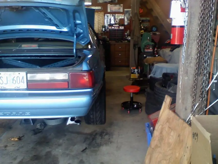

I did this on my 93 GT also with 10.5x17 Cobra R's on the rear. I dont like it as much because the tires stick out to much. I'm either going to have to change axles or wheel offsets on the 93. Any one know the name of that company who makes the brackets for these brakes to work with fox length axles?
Heres a better pic of the 92 coupe.
