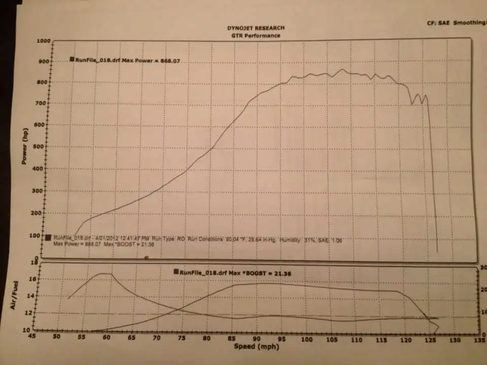

You know what I would be remiss if I didn't give a big thanks to the GTR guys too. This is my second Kurgan tune at GTR and the GTR guys are the best bunch of shop guys I have dealt with in a long long time. They are super helpful, friendly and actually care about doing things correctly. So if you are in SoCal area and need anything give them a look.

bentley429isBAC said:
How much timing, what plugs and whats the % on the injectors?
Still wondering. And what was the intake temp?

Im not a tuner so I didnt ask.

So you don't know if the thing has 10 degrees or 30 degrees in it? Not being a jerk but its something you might want to find out. How about the plugs?

Nope dont know and really dont care. I have full trust in Bob's tuning ability being worlds better than mine, so I will leave it up to him.

Did you test the E-85 at all before the dyno passes?

GroverDill said:
My turbo set up is finally "done" and tuned. Bob Kurgan came to SoCal this weekend and i was lucky enough to get my car tuned by him.
Motor was built by our own Rick Hawver of RNH racing.
basics are (for those that dont know)
Dart 363, GTS76 (3" downpipe), BS3, 120# injectors, big precision front mount, Super vic intake and a Jay Allen custom cam.
21 psi on E85, I think the turbo is done at this boost level, if you add in a couple pounds for "estimated" drop through the inter-cooler, I am pretty sure she is giving all she had.
Bob was pretty sure there was more in it, I however was so stoked on the numbers I had him stop there, it drives great, idles well, just WOW.
It made 884 on another run but I got the printout above.

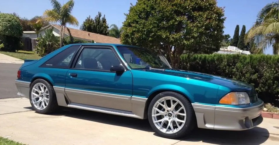

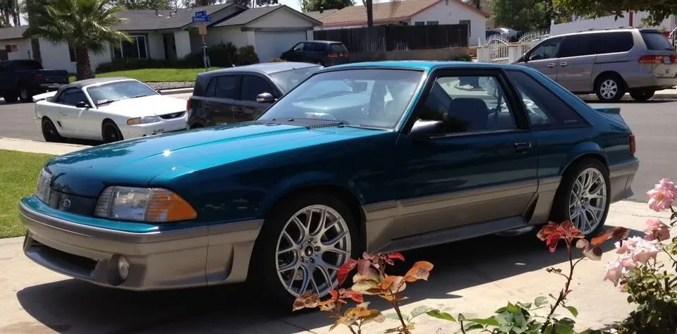

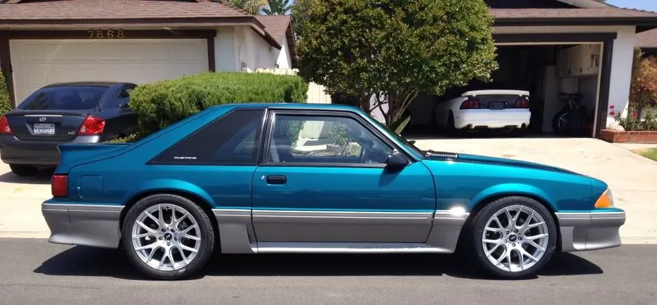

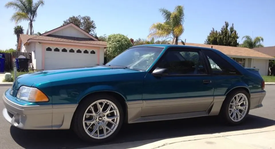

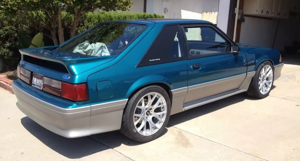

New wheels to go with the new power.
Admin Dude
Jan 4, 1985
43,515
21,685
Box behind Walmart
May 6, 2012
#37
  • May 6, 2012
  • #37
Nice! I'd wondered what a set of those would look like on a Fox. What's the rim width on the rears?
GroverDill
GoldMember
Aug 18, 1999
5,442
1,490
214
Demotte IN 46310
May 6, 2012
#38
  • May 6, 2012
  • #38
18x9 fronts 255/40/18 Hankook EVO2
18x10 rears 295/35/18 BFG Drag Radials
Stock length rear axles
Front has MM K member , non offset a-arms and 96 spindles
Coil overs all around no rubbing, drives nice.
