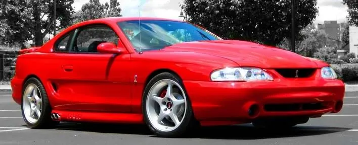

**Finally some decent pics with the 00R hood**
Dan the car looks bad a$$. Looks like you did a good job tweeking the hood. What did you wind up doing? Slotting the hinges? I just started messing with mine.
I enlarged the holes on the hinges where they mate to the hood, adjusted where the hinges bolt to the fender, and ground the tabs off the back of the latch (like Paul suggested at the show) then adjusted that for like an hour till it latched perfectly lol.

here are some more recent pictures of the car:
