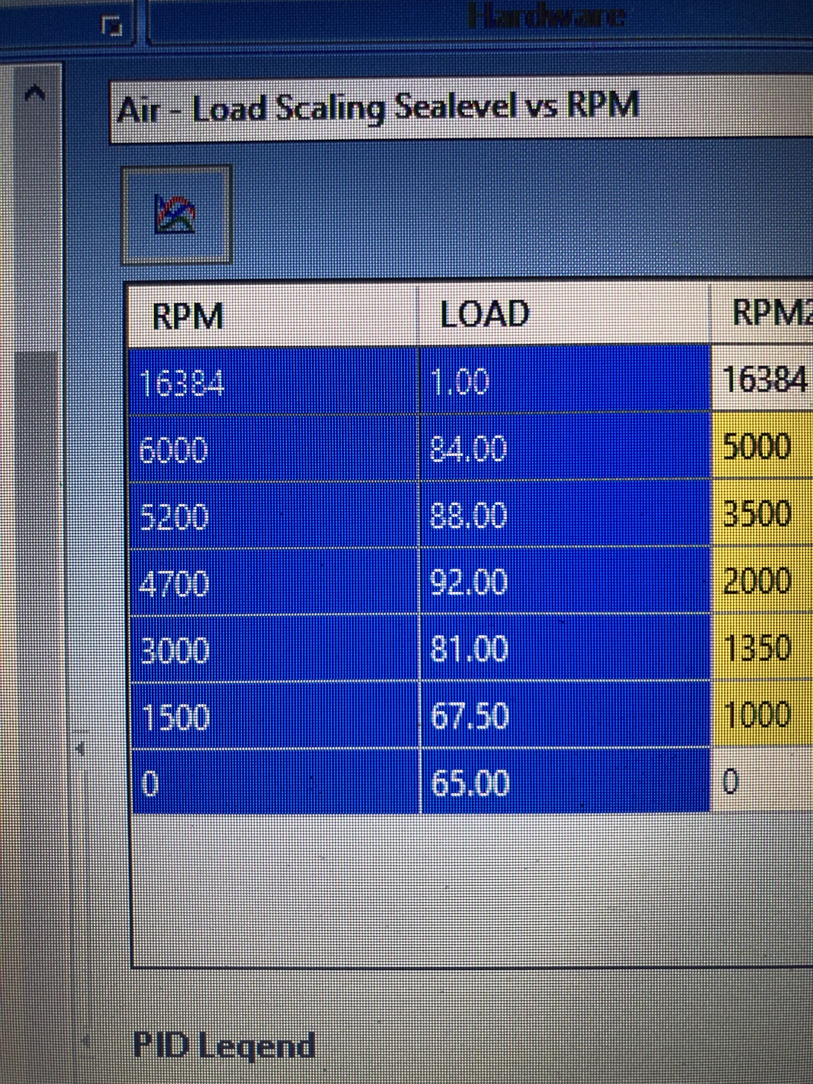

Progress Thread finally tuning (and more)
Incidentally, not once was it recommended in any of the tutorials that I either force open loop or disable active learning. Both of those have been left alone throughout this process.
You did set base timing to 10*?
Yeah the base timing is 10 with spout removed. Additionally, the only thing I’ve done with idle is set the physical base idle as per the standard procedure and slot the TPS to get .98v at idle. Even though Harrison goes through a bunch of stuff on idle and correcting for problems, I’ve not needed to do anything with that. Idle wise it’s now better than ever with stock settings.
